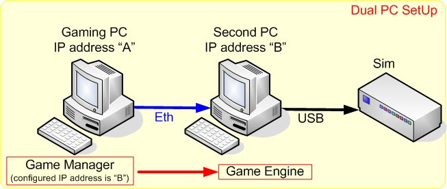

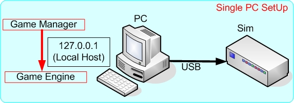

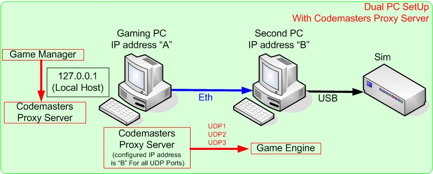

    Now i checked all possible ways.
    With Game Manager and Game Engine on the same PC it works with the proxy server, with the second entry the hardwareconfig.xml and with portforwarding via simcommander.
    After changing the ip in the Game Manager to the IP of the 2nd PC, no data incoming in game engine :-(

    Okay, in that case then the scheme might be this.
    My only assumptions. Sorry if I did not help you :(

  3. manzes82
    manzes82 New Member Gold Contributor
    Jan 11, 2016
    17
    - 91Coins
    Good idea. I will gives this a try. Thx

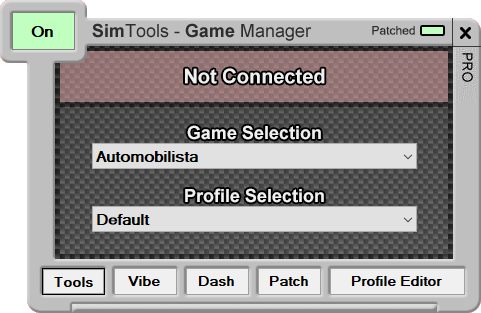

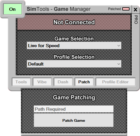

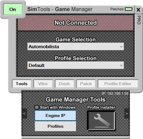

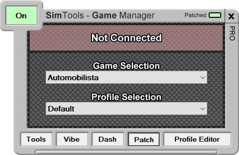

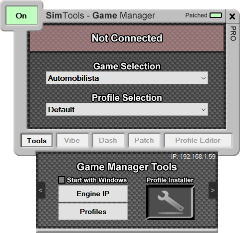

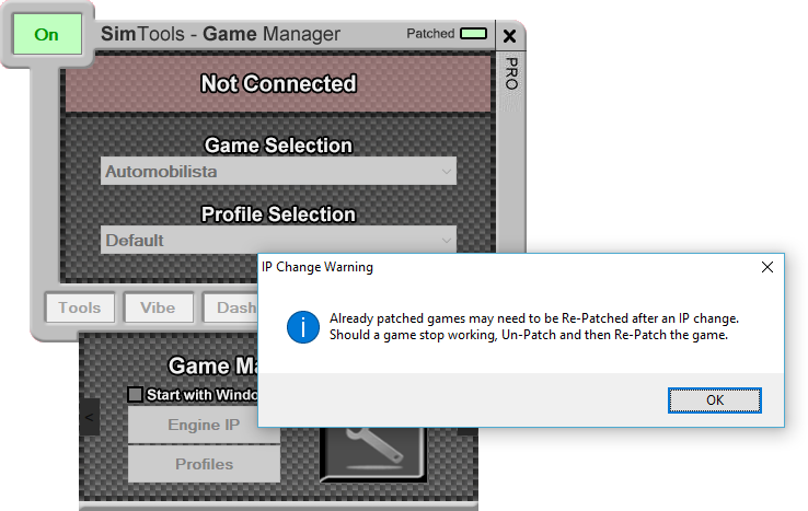

  16. value1
    Jan 9, 2011
    2,192
    Zug, Switzerland
    14,297Coins
    +3,363 / 13 / -1
    Only patch the game AFTER setting the IP address of GameEngine (of the second PC) .
    By that the
    hardware_settings_config-entry will be correct automatically.
    Tools
    Engine IP
    OK
    Enter the IP address of the 2nd PC where you run GameEngine
    Click on Tools again
    Patch the game
