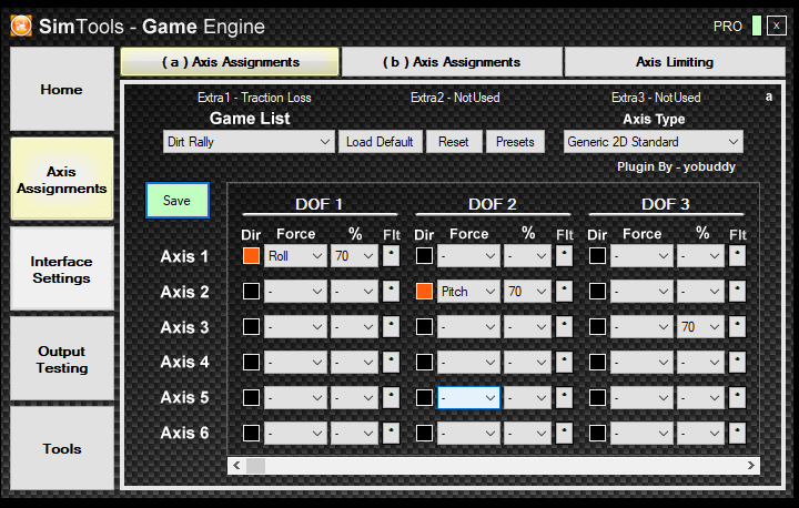

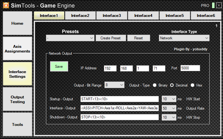

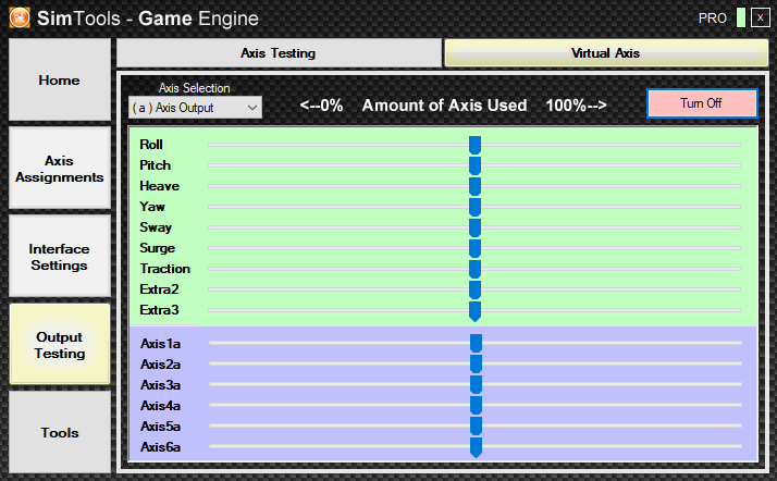

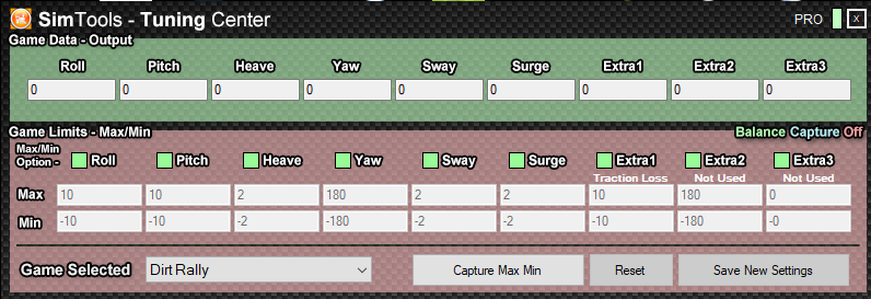

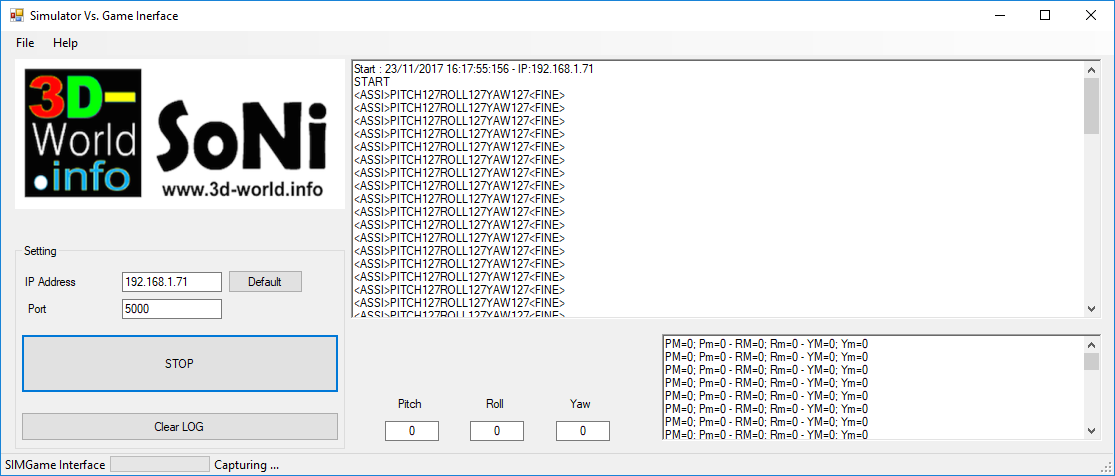

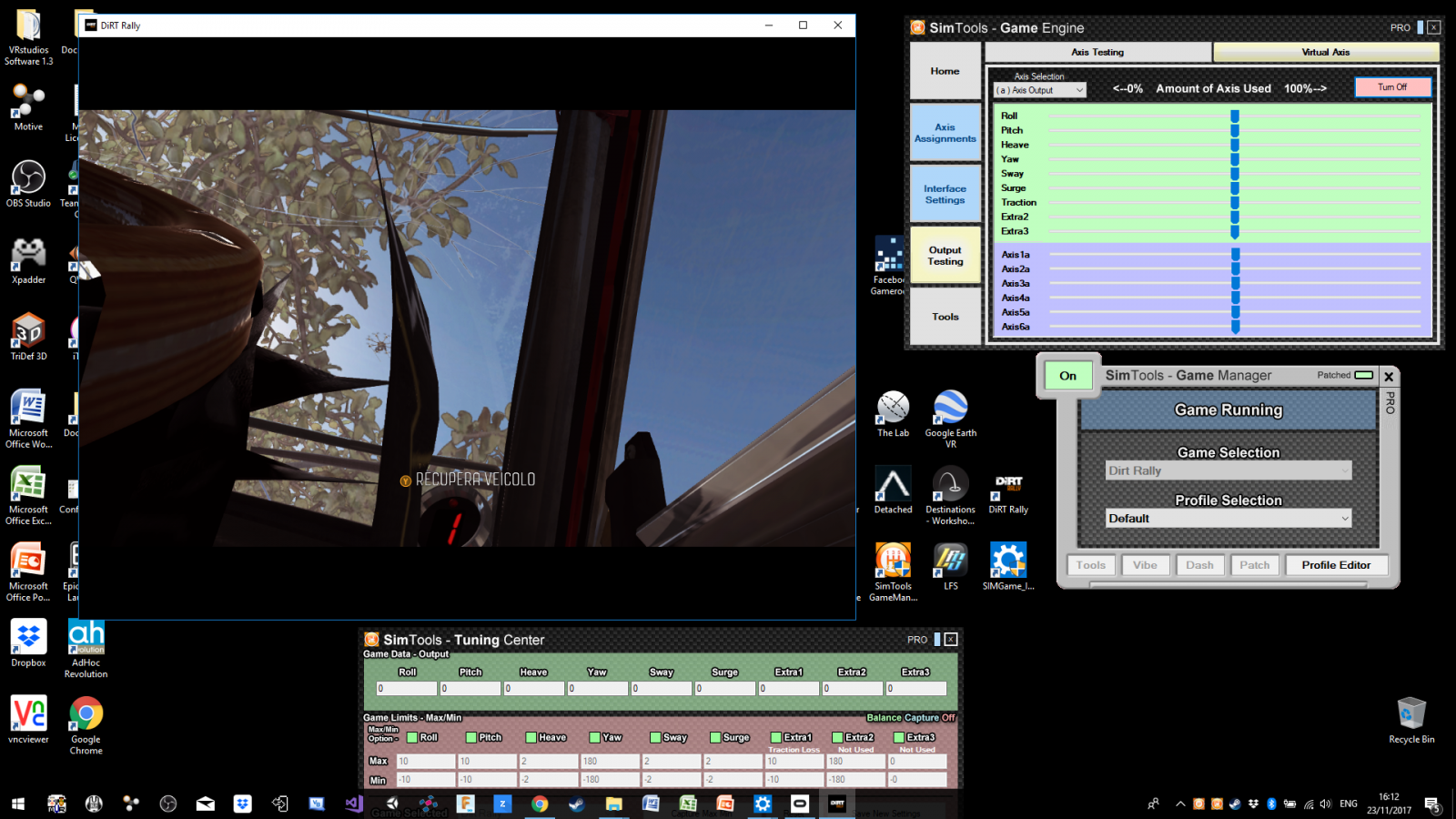

    @yobuddy and @value1,
    forget my previous message. I got finally the patching for DirtRally in GameManager.
    Now I've everything working but when I play with the game using the virtual axis (I'm making some offline test before connect the hardware of my simulator) I don't get the values of pitch, roll and yaw as you can see also from the tuning center picture I've attached.
    You can find all the configuration I did.
    With LFS I get all the correct values. I seems that the Dirt Rally PlugIn don't get correctly the values from the game.
    Can You please help me buddys :sos ?
    Thanks so much. !
