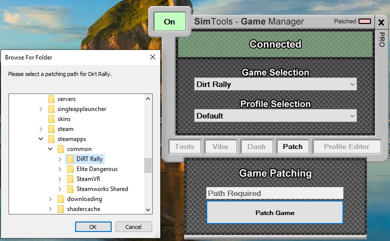

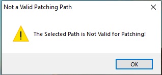

    I'm trying to patch my Dirt Rally and I get an error. It refuse the path of the game. My game is in the steam app directory.
    What can I do?
  12. llluis
    Mar 30, 2017
    164
    Quebec
    1,632Coins
    +103 / 1 / -0
    You have to select the path inside your Documents folder.
    "C:\Users\your_user\Documents\My Games\DiRT Rally"

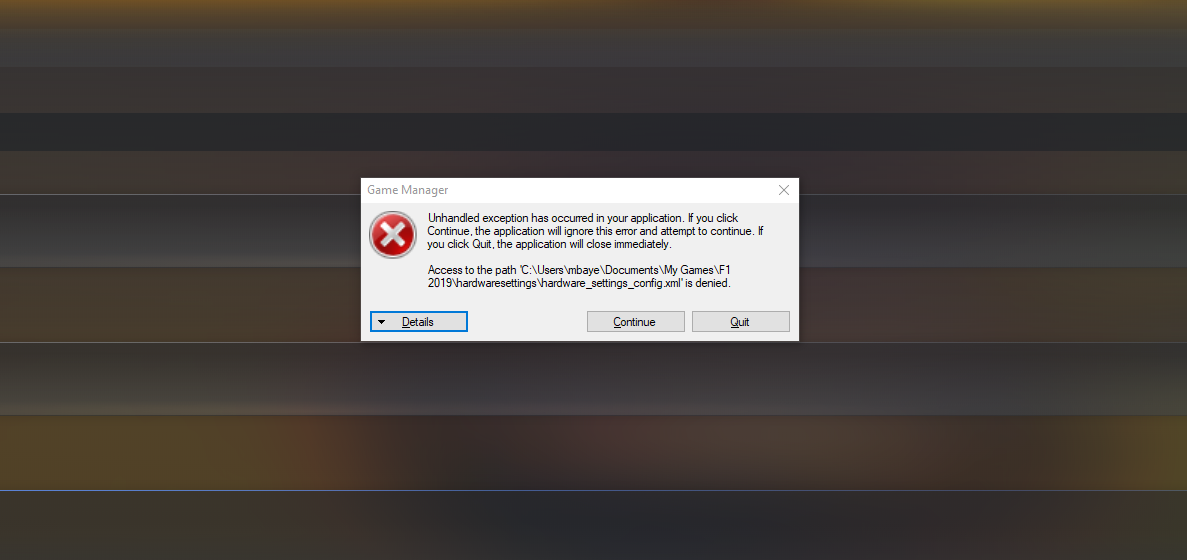

    Hi sim racers! I have racing hard (completing races) to patch Cod F1 error simtool.PNG y's games like F1 and Dirt Rally 2. It's so annoying to see that one developer games requires such a thing. Then with F1 I get this bug even after completing an entire race in Mexico. The game simply does not want to patch. Arrghhh! Could anyone here know what this could be?

    It says the file is in use, is the game running?
    If so, stop the game before patching.
    If not, reboot the PC then patch.

    I had to erase the config file. For some reason whatever I was changing was not saved hence Simtools could not access that file. Don’t know why but it worked. Thank you for your support

    Patched the game a few times, deleting the xml file, making a lap and putting the values into the file, but nothing, always the same strange problem.
    Do you have any idea what else I can do?
