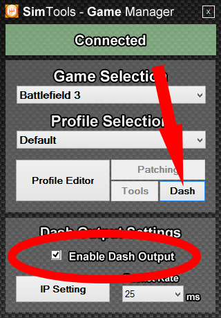

    Is there any way to get RPMs out of Dirt Rally?
    Latest update says "Speed, Gear and RPM are output in dash format." What does it mean? They don't seem to appear in Gamedash.
    I just built tachometer with shift light and it would be very nice to get it work with Dirt Rally :)

    @Tonantsa: Have you read the respective threads? Please have a look here!

    I read them all but didnt't find out how to get dash data out. Is there any way to enable dash output in plugin or how to get dash data?
    I'm quite new with simtools :)

    The FAQs list the GameDash supported games, provides the link to GameDash and how it is enabled and lists multiple approaches for dash projects: http://www.xsimulator.net/community/faq/diy-dashboards-and-gauges.140/

    Did you click on "Dash" in GameManager and enable Dash Output?

    Of course dash output is enabled but plugin doesn't offer dash output.
    However, latests update says "Speed, Gear and RPM are output in dash format", but plugins overview states
    DashApp Data:

    Good to get it fixed, thank you very much :) Now I can have my DIY tachometer working with Dirt Rally, lets hope this game end up being successor of Richard Burns Rally.
