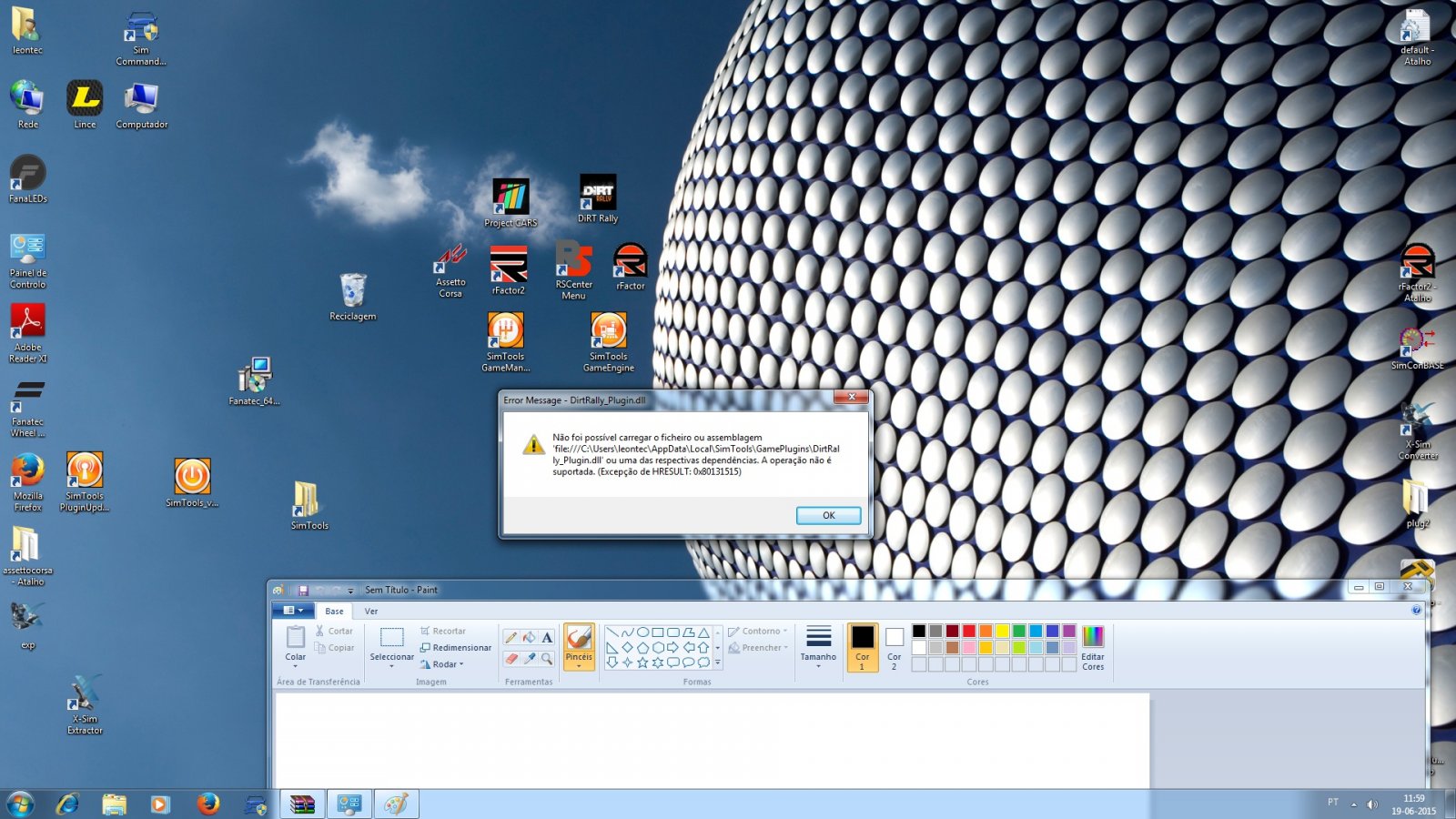

    Hi, me again...tried the sugestions, unistalled simtools, re-installed..everything OK, EXCEPT when i copy the dirt plugin!...
    I'm begining to get despaired...it only worked in 1st version, then i probably did something wrong, don't know..after that never worked, and crashes the simtools game manager/engine...i'll try to post a printscreen of the error...PLEASE HELP!

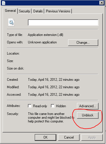

    @nff Please go to C:\users\leontec\AppData\Local\SimTools\GamePlugins
    Right-click on DirtRally_Plugin.dll and select Properties.
    A dialog box opens:
    Check if there is a button "Unblock" and unblock the file.
    Hope this helps

  8. nff

    IT worked allright!!...you're a genious...can't thank you enough!
