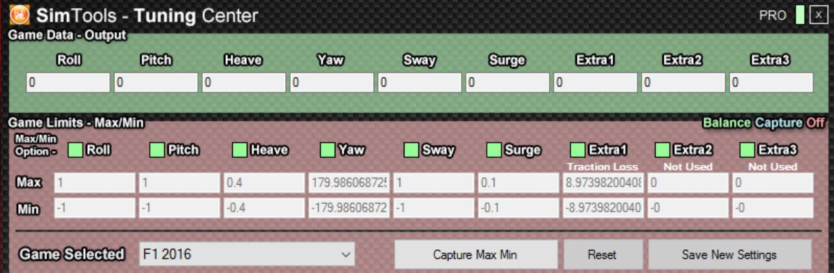

    I thought the values in the min and max were too large, but I've tried everything from 0 to 20. My latest min/max settings looked like this:
    I'm not sure if this information will be of any help, but the previous plugin for simtools 1.3 was based on the Dirt Rally plugin. Something to do with dbox support if I remember right. I had a chat with yobuddy about it when I was testing an early version of the plugin for simtools 1.3.

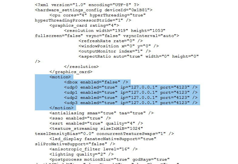

    Hi All, Just in case anyone is interested, I have managed to get this plugin working. The fix turned out to be really simple... although difficult for me as I am trying to learn :'(
    It turns out that the plugin doesn't change the 'dbox enabled' line in the hardware setting config to <dbox enabled="true"/> . If you manually change this in both the hardware_settings_config.xml and the cfg.BAK file, the plugin then works. It has also fixed the heave error I was getting above in my earlier post.
    Anyway, I hope this helps anyone trying to play this game,

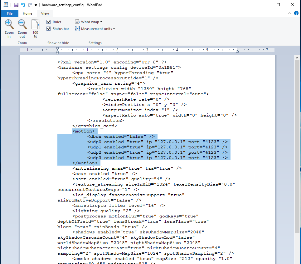

    Hi
    I got it working changing udp to true in bak and hardware settings config. and the port adress.
    But the movements roll and pitch in F1 2016 are not what it suppost to be, think is still a flaw in plugin.
    Can somebody look true the plugin file maybe?

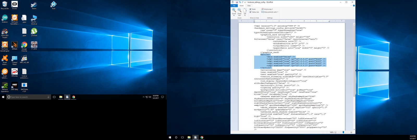

    Hi I changed this in my hardware settings file and .BAK file. (You can find them in C:Documents/My Games/F1 2016/hardwaresettings) I don't know if this port i am using is the same in your sim. I used the same port what i am using in Dirt Rally.
    The movements i have in f1 2016 are a bit off, especially Roll movement. but pitch is to early or something.

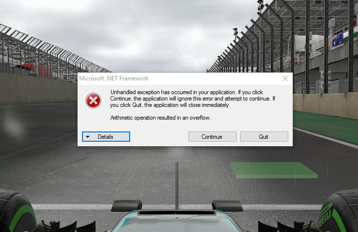

    You gave the following error after the changes in hardware settings.
    I tried other combinations of fake and true and also did not work.
    Changing the adress port and without changing.

    I have a question about your F1 2016 patch. I belive There are still some errors in it. Movements are not in sync or completely different. Can you look to it or does somebody else have an Idea. By the way I have the same readings as Sarge in tuning center
    Many thanx!!

    Thanks for your advice. I managed to get the right settings in axes assignment and tuning manager.
  19. yobuddy
    51,690Coins
    +5,204 / 19 / -0
    Could someone post the unpatched "hardware_settings_config.xml" file for this game?
    I would like to compare the file to the 2015 version, as it appears to have changed?
    @SteVoortwis,
    would you please set "udp1 enabled = false", "udp2 enabled = false", "udp3 enabled = false".
    And see if you still have motion, my guess is you only need udp0 enabled.
    Have all 4 sending to the same receiver, may diminish the ride some.
    Thanks everyone!
