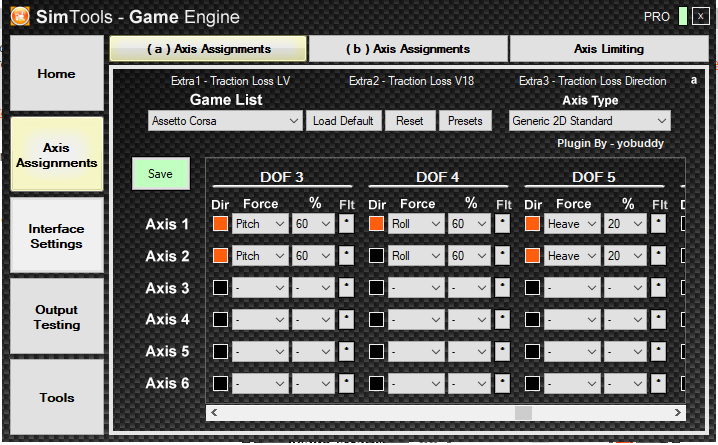

    I use Assetto Corsa plugin with Prosimu T1000 3DOF, and everything works well, this is my setup:
    I'm now testing F1 2017 plugin and I've noticed that there are some parameters going out from game that are inverted in comparison to Assetto Corsa. Is this possible? I mean, i've tested with virtual output and, for example, in Assetto corsa if you turn to right, Sway slider goes to right...with F1 2017, if you turn to right, Sway slider goes to left... it's the same for pitch and for Traction loss (and I suspect for roll). What does it mean? That we should inverted this setting into Axis Assignment?
    22,208
    154,711Coins
    +11,211 / 57 / -2
    I don't have the game @mirkobastianini so can't check, but by the sounds of it yes you should invert the Dir assignments.
