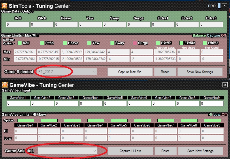

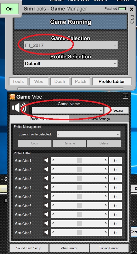

    F1 2018 has a 'legacy' setting in game. If you switch this on, and change the name of the .exe to F1 2017, it might work with Simtools via the F1 2017 plugin. I have not bought it yet, so I haven't tested the final game. This method might be worth trying for now, until a plugin surfaces.

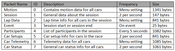

    Below is the UDP data specification from Codemasters themselves for F12018;
    OVERVIEW
    The F1 series of games support the outputting of key game data via a UDP data stream. This data can be interpreted by external apps or connected peripherals for a range of different uses, including providing additional telemetry information, customised HUD displays, motion platform hardware support or providing force feedback data for custom steering wheels. The following information is a summary of the data that is outputted so that developers of supporting hardware or software are able to configure these to work with the F1 game correctly. If the information you require is not contained here, or if you have any issues with the UDP data itself, then please let us know and a member of the dev team will respond to your query as soon as possible.
    • PACKET TYPES
      The main change for 2018 is the introduction of multiple packet types: each packet can now carry different types of data rather than having one packet which contains everything. A header has been added to each packet as well so that versioning can be tracked and it will be easier for applications to check they are interpreting the incoming data in the correct way.
      Each packet has the following header:
      struct PacketHeader

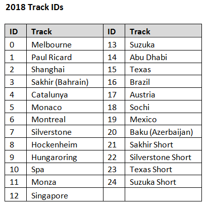

      uint8 m_sessionType; // 0 = unknown, 1 = P1, 2 = P2, 3 = P3, 4 = Short P
      // 5 = Q1, 6 = Q2, 7 = Q3, 8 = Short Q, 9 = OSQ
      // 10 = R, 11 = R2, 12 = Time Trial
      int8 m_trackId; // -1 for unknown, 0-21 for tracks, see appendix

      EVENT PACKET
      This packet gives details of events that happen during the course of the race.
      Frequency: When the event occurs
      struct PacketEventData
      PacketHeader m_header; // Header
      uint8 m_eventStringCode[4]; // Event string code, see above

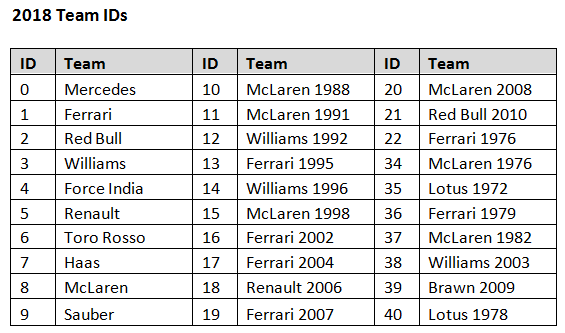

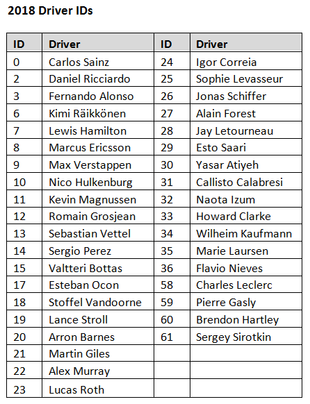

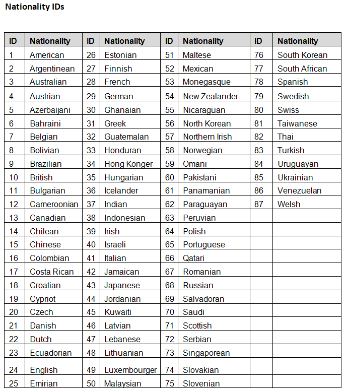

      PARTICIPANTS PACKET
      This is a list of participants in the race. If the vehicle is controlled by AI, then the name will be the driver name. If this is a multiplayer game, the names will be the Steam Id on PC, or the LAN name if appropriate. On Xbox One, the names will always be the driver name, on PS4 the name will be the LAN name if playing a LAN game, otherwise it will be the driver name.
      Frequency: Every 5 seconds
      struct ParticipantData
      uint8 m_aiControlled; // Whether the vehicle is AI (1) or Human (0) controlled
      uint8 m_driverId; // Driver id - see appendix
      uint8 m_teamId; // Team id - see appendix
      uint8 m_raceNumber; // Race number of the car
      uint8 m_nationality; // Nationality of the driver
      char m_name[48]; // Name of participant in UTF-8 format – null terminated
      // Will be truncated with … (U+2026) if too long
      struct PacketParticipantsData
      uint8 m_numCars; // Number of cars in the data
      ParticipantData m_participants[20];

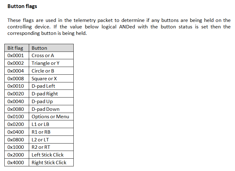

      uint32 m_buttonStatus; // Bit flags specifying which buttons are being
      // pressed currently - see appendices
      struct CarStatusData
      uint8 m_tractionControl; // 0 (off) - 2 (high)
      uint8 m_antiLockBrakes; // 0 (off) - 1 (on)
      uint8 m_fuelMix; // Fuel mix - 0 = lean, 1 = standard, 2 = rich, 3 = max
      uint8 m_frontBrakeBias; // Front brake bias (percentage)
      uint8 m_pitLimiterStatus; // Pit limiter status - 0 = off, 1 = on
      float m_fuelInTank; // Current fuel mass
      float m_fuelCapacity; // Fuel capacity
      uint16 m_maxRPM; // Cars max RPM, point of rev limiter
      uint16 m_idleRPM; // Cars idle RPM
      uint8 m_maxGears; // Maximum number of gears
      uint8 m_drsAllowed; // 0 = not allowed, 1 = allowed, -1 = unknown
      uint8 m_tyresWear[4]; // Tyre wear percentage
      uint8 m_tyreCompound; // Modern - 0 = hyper soft, 1 = ultra soft
      // 2 = super soft, 3 = soft, 4 = medium, 5 = hard
      // 6 = super hard, 7 = inter, 8 = wet
      // Classic - 0-6 = dry, 7-8 = wet
      uint8 m_tyresDamage[4]; // Tyre damage (percentage)
      uint8 m_frontLeftWingDamage; // Front left wing damage (percentage)
      uint8 m_frontRightWingDamage; // Front right wing damage (percentage)
      uint8 m_rearWingDamage; // Rear wing damage (percentage)
      uint8 m_engineDamage; // Engine damage (percentage)
      uint8 m_gearBoxDamage; // Gear box damage (percentage)
      uint8 m_exhaustDamage; // Exhaust damage (percentage)
      int8 m_vehicleFiaFlags; // -1 = invalid/unknown, 0 = none, 1 = green
      // 2 = blue, 3 = yellow, 4 = red
      float m_ersStoreEnergy; // ERS energy store in Joules
      uint8 m_ersDeployMode; // ERS deployment mode, 0 = none, 1 = low, 2 = medium
      // 3 = high, 4 = overtake, 5 = hotlap
      float m_ersHarvestedThisLapMGUK; // ERS energy harvested this lap by MGU-K
      float m_ersHarvestedThisLapMGUH; // ERS energy harvested this lap by MGU-H
      float m_ersDeployedThisLap; // ERS energy deployed this lap
      struct PacketCarStatusData
      CarStatusData m_carStatusData[20];

    I have a problem with game vibe vs F1_2017.
    Simtools work fine with this plugin, but Game vibe does not detect the sim and I don't receive any data (see pictures below).
    Game Vibe works fine with Assetto Corsa and RFActor2, I have the issue only with F1_2017
    Thanks in advance for the support[​IMG]

    Not all plugins have Game Vibe support yet.

    As plugins are developed an maintained by members in their spare time it will happen when @value1 has the time and inclination to revisit and upgrade the plugin.
    The option is always open for anyone to create a plugin to meet their immediate needs, see here for details if you are interested: https://www.xsimulator.net/communit...lugin-for-simtools-2-0-api-documentation.131/
