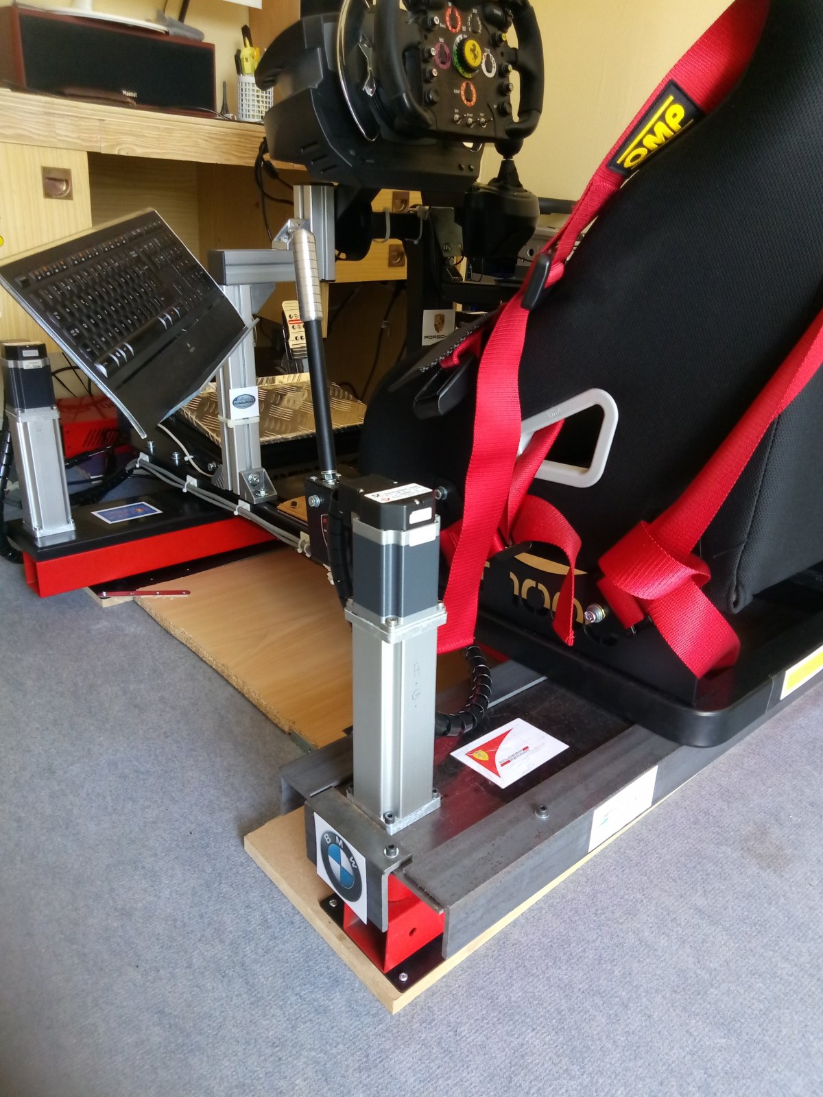

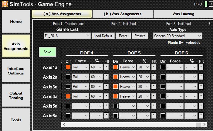

    If you turn to the right, the simulator must lean to the left, if you turn to the left, you have to lean to the right, the centrifugal force ... If I turn right, it goes to the right but leans to the right, but physically in a car whatever it is, it is not possible. In Assetto Corsa, Project Cars 1,2, Pro kart, the other F1 20 ** no worries, it reacts correctly. I hope I'm clear now.

    Is it maybe just the DIR box you have to change?

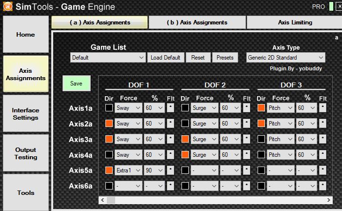

    @JohnCrichtonFR,
    You control the way it tips around corners with your axis assignment settings buddy.
    Thats what the little 'Dir' boxes are for.
    Give it a shot,

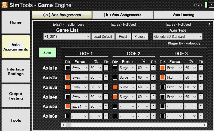

    Open the axis assignment settings for f12018, click all the 'DIR' boxes next to all of the sway entries.
    (So they are the opposite of what you have now.)
    Save the settings and give it another run.
    Take care,
    btw, you can post all of your pics in the forums, no need to link off site.
    Just so you know buddy.

    It finally works correctly. I had already tried, but the simulator had "planted", the forces were no longer consistent and I had to return the settings to the original state.
    Thank you really for your time, your explanations were concrete, it is apréciable. Sorry to have questioned the pugin, I was wrong and I want to admit it.
