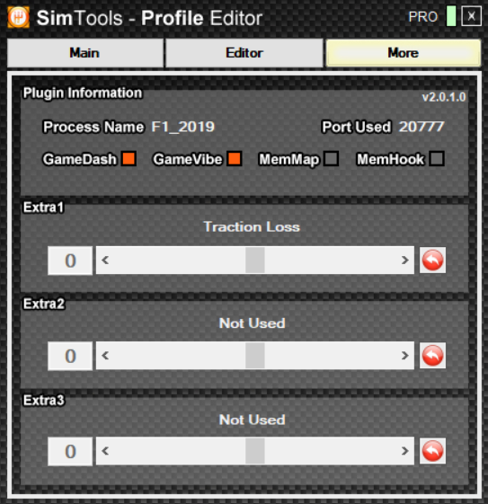

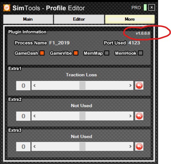

    SimHub doesn't work. Should auto detect current game work?

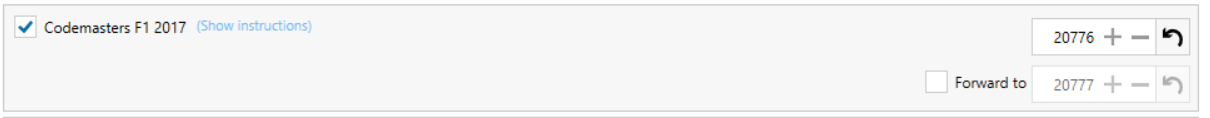

    did you activate 2017 f1 plugins with the correct port 20776?

    Yes, I did

    V2.0.1.0

    Port number is 20777

    Could you pleas post pictures of all of your settings, including the Tuning Center while the game is running.

    Did you try it in DX11 UDP legacy mode?
