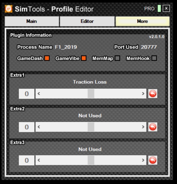

    Same happens with Simhub, Simtools and F1 2019
    any update on this?
  6. DoubleM
    DoubleM Member Gold Contributor

    UDP FORMAT legacy mode NOT 2019

    Hi Trigen,
    Only run in DX-11.
    UDP format has to be set at "Legacy".
    You will loose output in all other (Simhub / buttkickers)
    I tried everything to get it running but no luck.
    Even with "Codemaster Proxy Server" and "Sim Racing Proxy Server" it can not be done.
    Simtools needs to get an F1 2019 plugin for at least UDP 2019 compatibility.

    Hello again,
    I run simtools and simhub at the same time you just have to modify a file in simhub.

    SIMHUB AND SIMTOOLS

    simhub f1 2017 works correctly in f1 2019 games with legacy telemetry and simhub works only with f1 2019 telemetry
