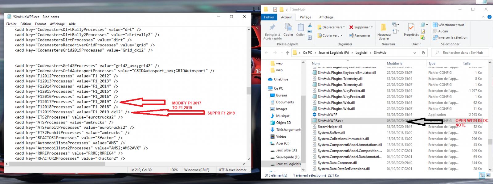

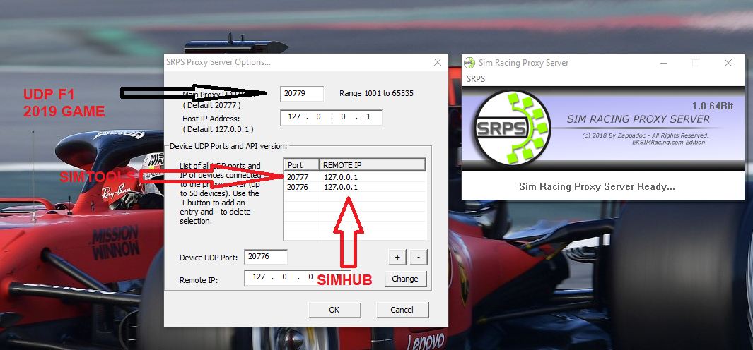

    Hello again,
    I run simtools and simhub at the same time you just have to modify a file in simhub.
  6. bruno1210
    bruno1210 schumi06
    Jan 4, 2015
    134
    103Coins
    +12 / 0 / -0
    SIMHUB AND SIMTOOLS

    Got it working thanks.

    simhub f1 2017 works correctly in f1 2019 games with legacy telemetry and simhub works only with f1 2019 telemetry

    Hi. I have tried today all options and the plugin does not cooperate with SimHub and SimTools at the same time no matter what I do. It works only with SimTools.
