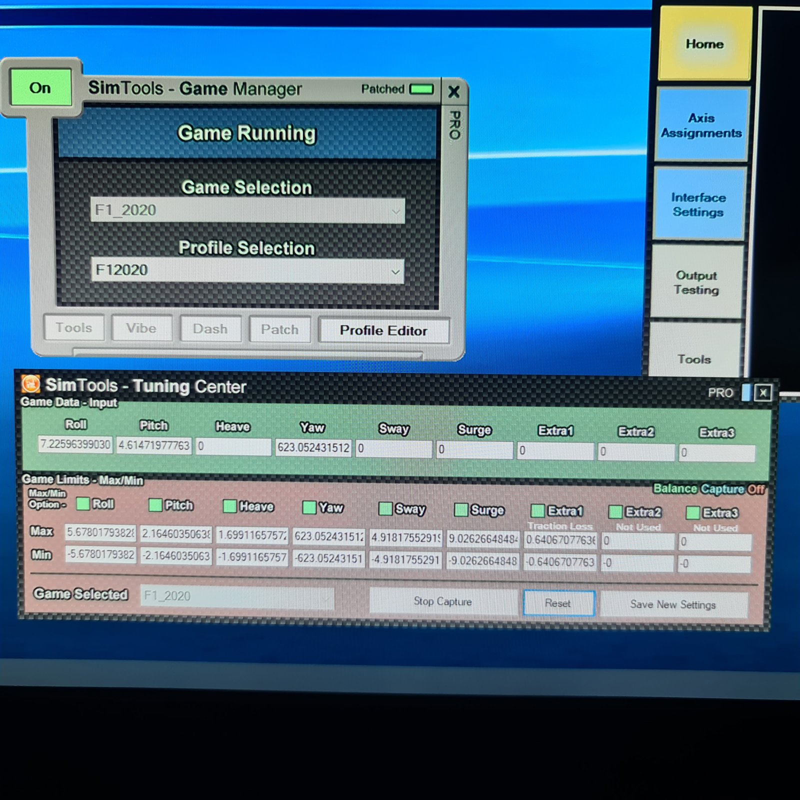

    Hello
    I tried in my team mode there is movement but it is completely disordered movements.
    I put the tunning center see photo it goes all over the place.
    do you have this problem
    thank you.

    yes I tried and indeed it does not work normally you will have to wait for an update of the plugin or the games

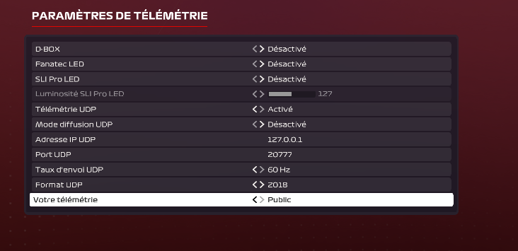

    I think I have found a way around the issue with this plug-in. Disclaimer - it’s not going to work for most!!! I have a Cube Control CSX2 wheel that has a display for telemetry. The wheel is operated by a software called UGT. UGT requires UPD data as you can imagine to operate. The dev for that app is AMAZING. I usually send them email flagging bugs and they get a fix right away (almost) if the issue is known. They will send me a beta version with the fix so I can provide feedback. Since their wheel requires F1 2020 telemetry data they added a UDP forward function on their soft that converts F1 2020 into any F1 UPD data down to 2018 = in the game in can select UPD data 2020. In their software I forward this data to any receiving UDP device and converted to 2018 data. Since Simtool with this plug-in works when you select 2018 UPD data, I now for the first time have my CSX2 data and my motion rig working together. And I think I get better motion feeling now than ever playing F1 20xx series. I am not technical enough to explain all the details but in case you have this wheel or use a software similar to UGT this might be a solution for you. I can now fully enjoy F1 2020. Good luck!

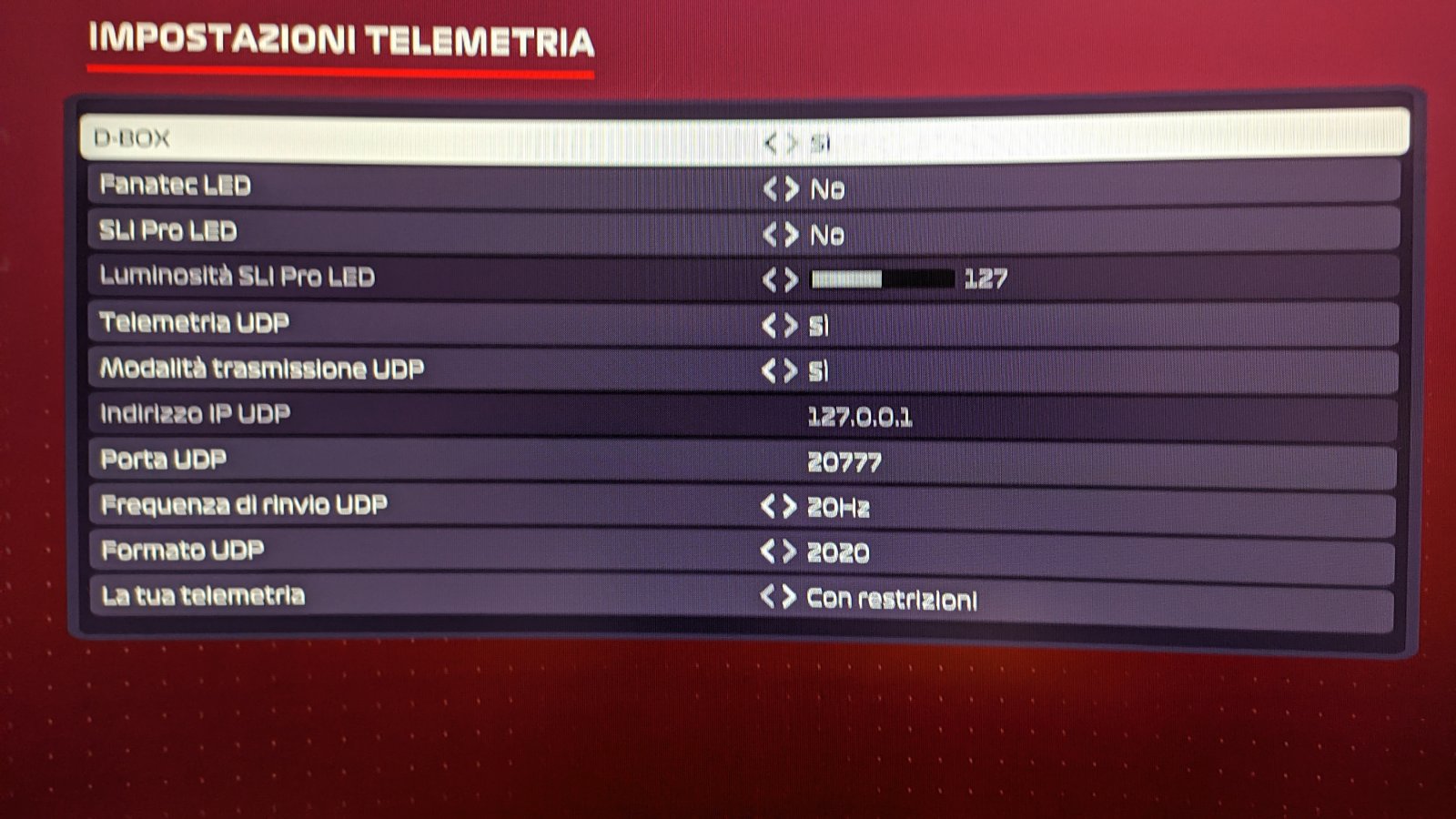

    Hallo Alberto, Could you please share your setting in game and in the "harware setting config"? I've just installed F1 2020 but I have not movement. Wih other codemarster game like Dirt rally non problem but with F1 no movement

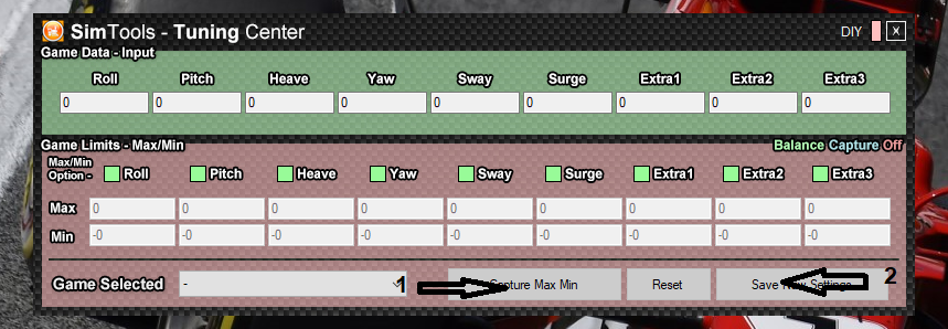

    you have to make a capture with tuning center done just with a clean turn in the game and save.

    When I start the game in "Game Manager" I see that "Game Running" but in tuning center the telemetry not working. So I tried to capture max and min, then reset and drive for a few seconds. All values remain at "0" . Attached the photo of configuration in game. I also use simdashboard and with this configuration it works but simtools no.

    You have incorrectly configured the games and simtools does not work with SIMDashboardServer at the same time sorry here is how to configure the games for simtools.
