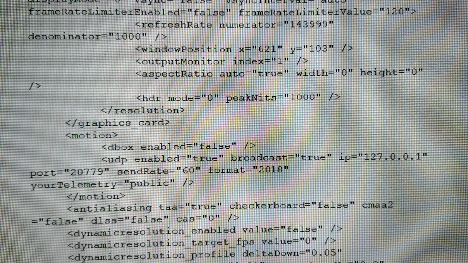

    Hi Bruno,
    I tried the configuration of telemetry that you suggest. In game manager I see in game manager "game running" but in tuning center telemetry not work and non movement
    This is the configuration:
    <dbox enabled="false" />
    <udp enabled="true" broadcast="false" ip="127.0.0.1" port="20777" sendRate="60" format="2018" yourTelemetry="public" />
    But I I try to change transmission UDP (broadcast) from false to true telemetry is ok simtools work. I have movement. This is the configuration:
    <udp enabled="true" broadcast="true" ip="127.0.0.1" port="20777" sendRate="60" format="2018" yourTelemetry="public" />
    Now I wold like to know how connect SIMHUB. As in simhub setting with this configuration game result "not connect"

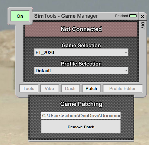

    have you patched the games in simtools manager ?
    and capture with tuning center
  7. gigi
    gigi Active Member
    Nov 16, 2013
    467
    920Coins
    +141 / 1 / -0
    2DOF, JRK, 4DOF
    Hi!
    Yes game patched and captured with tuning center. Simtools works fine now and I have the movement. The problem now is how can I do to let that simtools and simhub works togheter?

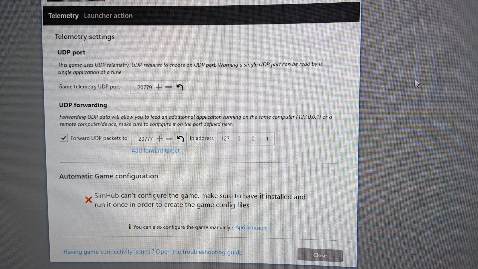

    Have you tried port forwarding on the SimHub side: https://www.xsimulator.net/community/faq/simhub-port-forwarding.356/

    Yes i tried. I dont' know how change the port in simtools (default for f1 2020 is 20777). So in game I change the port from 20777 to 20778. Then here https://www.xsimulator.net/community/faq/simhub-port-forwarding.356/ I change game telemetru port from 20777 to 20778 and forwarding to 20777. But not works. I think that the problem is that also simehub need udp format 2020 but simtools works only 2018.
    I read this https://www.xsimulator.net/community/threads/codemasters-f1-2019-plugin.13587/page-5#post-195032 regarding the same problem in F1 2019. Do you think it will solve also in f1 2020?

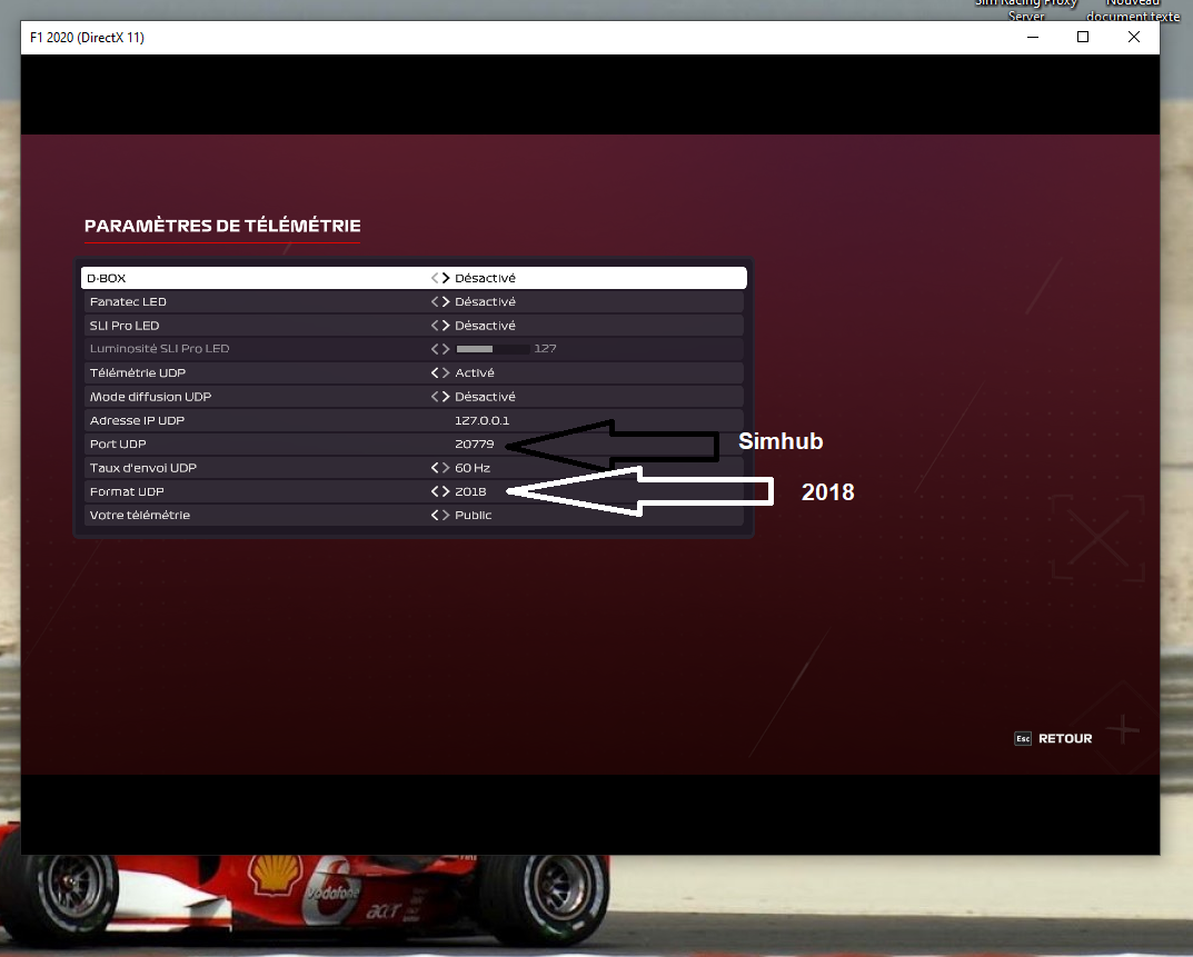

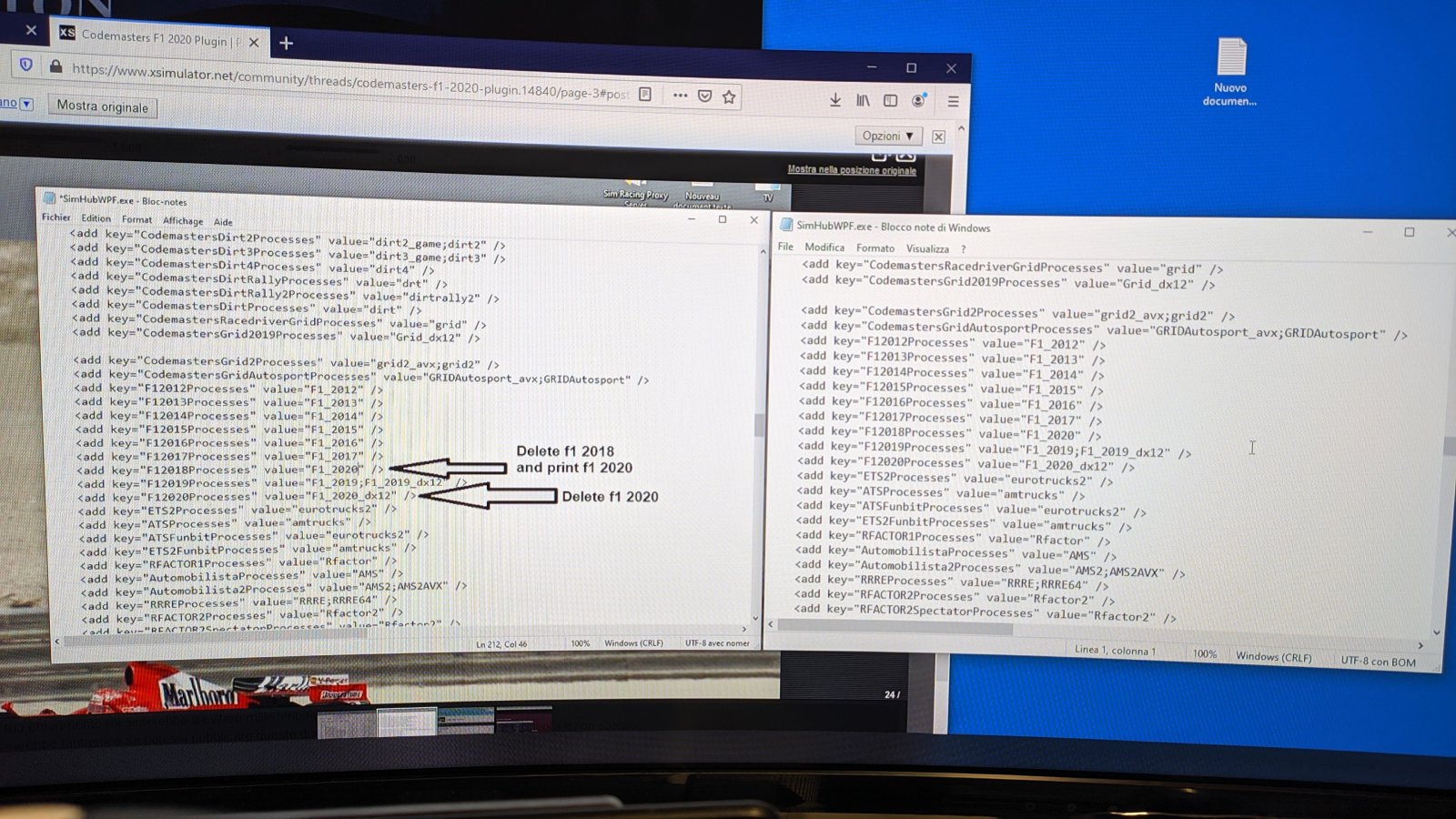

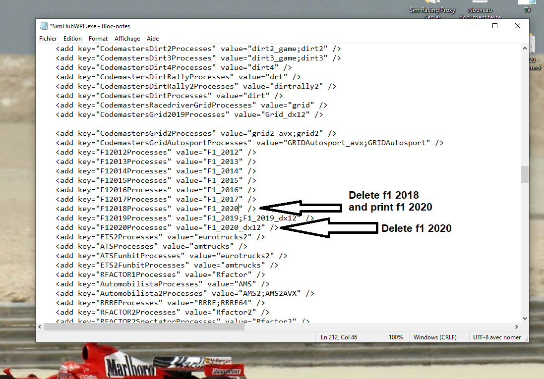

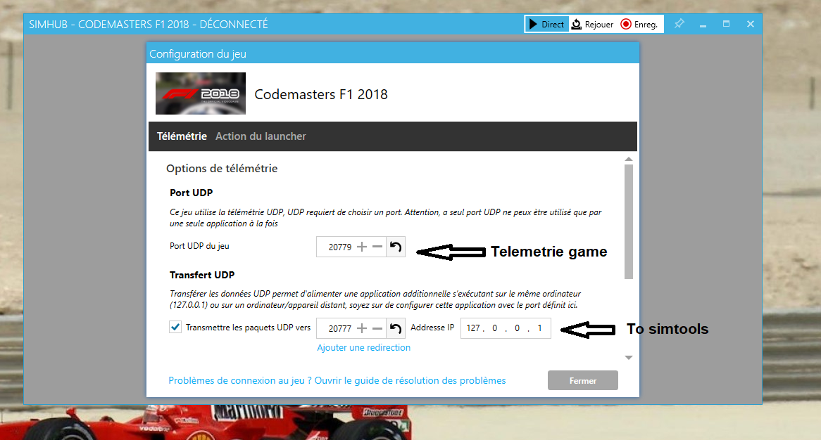

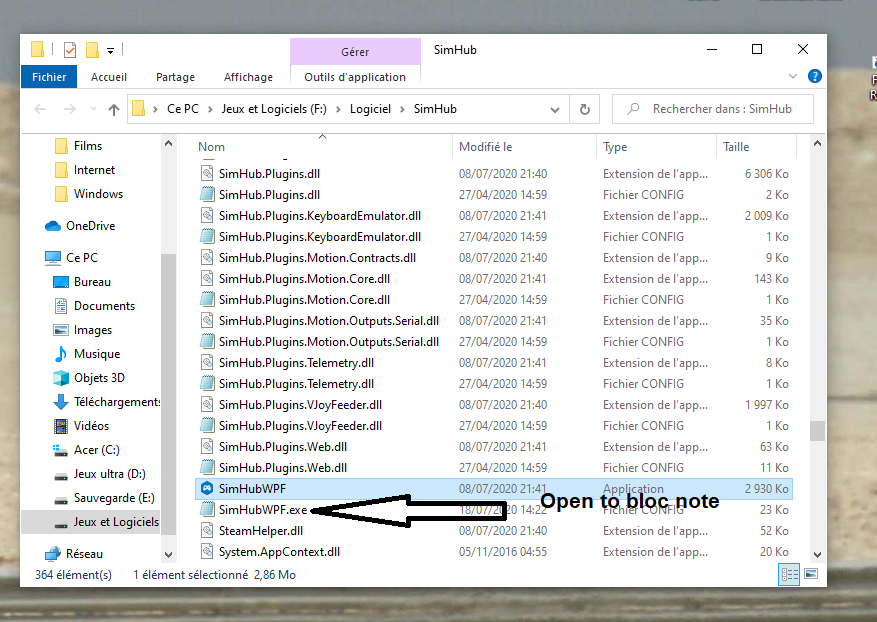

    You have to modify files in simhub go to the directory changes as in the photo for f1 2018 f1 2020 erase f1 2020 on this line just f1 2020 dx12 plus open simhub and configure f1 2018 like me finally in the game f1 2020 dx11 configure telemetry at home works perfectly.

  11. gigi
    gigi Active Member
    Nov 16, 2013
    467
    920Coins
    +141 / 1 / -0
    2DOF, JRK, 4DOF
    Thank you very much Bruno for your support.
    Only one thing...In Simhubwpf.exe (your image 2.PGN you wrote for one line "delete F1 2018 and print F1 2020". This mean modify only value="F1_2018" to value="F1_2020" and I don't have to change the first part of this line where it is written <add key="F12018Processes" to <add key="F12020Processes" ?
    Regarding the second line you suggest to delete F1 2020. This mean I have to delete all line?
    Sorry, probably stupid question but
    your clarification would help me avoid a thousand attempts to do something I don't know
    it would be great if I could post these two lines already correct so the copies and paste and I'm not mistaken.
    Thanks again
  12. bruno1210
    bruno1210 schumi06
    Jan 4, 2015
    134
    103Coins
    +12 / 0 / -0
    <add key="F12018Processes" value="F1_2020" />
    <add key="F12019Processes" value="F1_2019;F1_2019_dx12" />
    <add key="F12020Processes" value="F1_2020_dx12" />

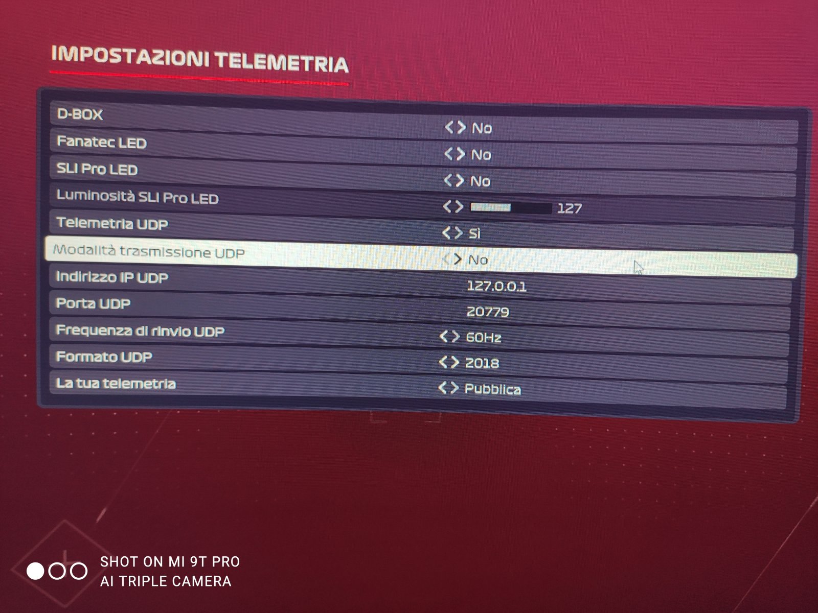

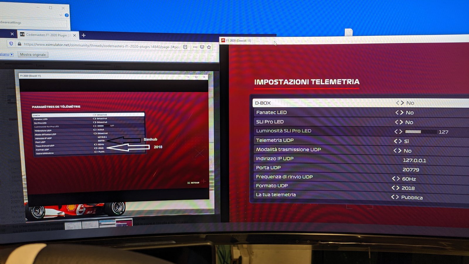

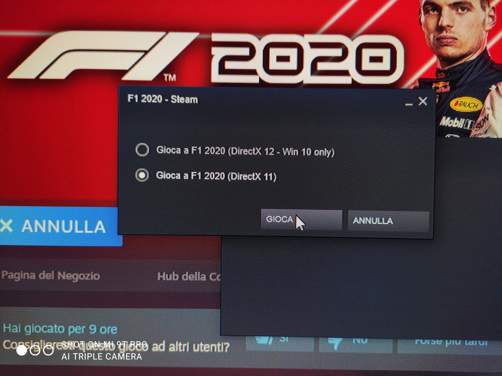

    I copy your settings. I start a game from steam (in DirectX 11) . I start simhub and see F1 2018 running . In game I have a vibration. thats's ok. I also start simtools, Game F1 2020 running but i've not telemetry and no movement
    I also see that in sim hub f12018 work only if in game I "mode trasmission udp" is set "yes"

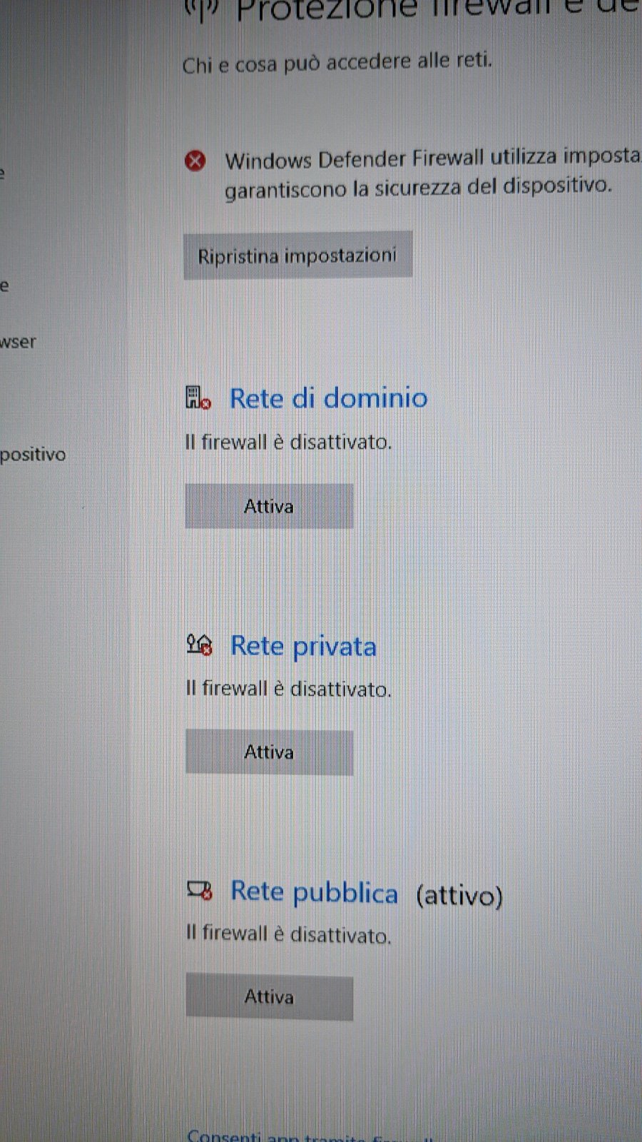

    Have you tried temporarily disabling the firewall and ant-virus to check if either are interfering?

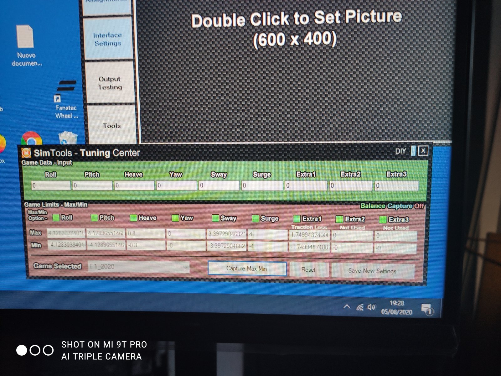

    Can you also post a picture of the Tuning Center with the game running.

    Hi noorbeast thanks for support. This evening I try to disabling firewall and antivirus. I also pos a picture of tuning center with game running.

    I made a video. as you can see in simtools f1 2020 it is "running" but there is no movement. In simhub f12018 it is "running" and it works
    I have a feeling that there is some sort of interference. It is as if the game fails to provide data to both apps. I tried to restart the pc, leaving the automatic start of simhub and manually starting simtools. In this way I enter the game from steam (in directX 11 mode) and if I set mode transmission udp "in" yes "simtools it works but it is no longer connected simhub. In definitive despite having followed the instructions of Bruno1210 (which once again thank you for its availability) I can't get the game to work with both apps
