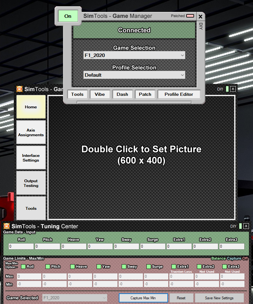

    Yes im using windows 10 , but after I choose the directory of f1 2020 (document/my games/F1 2020) the game still not patched, is there any video tutorial to patch this? Thank you.

    So I presume you have 64bit Windows, correct?
    Do you get a message about the game not being patched, or do you not have motion. If the latter then can you please post pictures of all of your settings, in particular the Tuning Center while the game is running.

    the tuning center not detecting any input, also I attach the step recorder how i patching the game and what error that showed up. Thank you
  18. noorbeast
    22,225
    154,819Coins
    +11,226 / 57 / -2
    Did you run the game once before patching? That generates some required files.
  19. racelabanang
    racelabanang New Member Gold Contributor
    Jul 22, 2020
    6
    - 5Coins
    yes I run the game already but only in time trial for only like half lap, is there any particular settings in telemetry option in f1 Settings I have to change to make it work?

    hello friend look it is very easy to patch a game in simtools in case the game or plugin is new all you would have to do is open the gamemanager tools tool and add it but just with f12020 there are problems with simtools or With the windows update that you are already using, it does not work with the 2004 update. the manager with the 2004 does not connect with the engine. I have it working but you have to do a couple of strange things. In my case, on the gameengine pc I have it with the 2004 update and on the game pc I have the 1909 update, the simtools programs are just connected perfectly, then you should have the f12020 or f12018 patches on and you have to fix it In the telemetry tab of the game, change to f12020 or f12018 and always activating telemetry and configure the IP address of the pc where you are sending the data.
