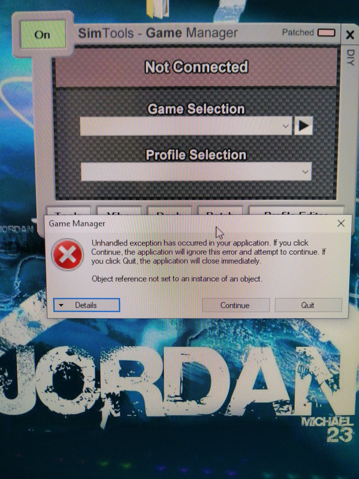

    Hello. I have a problem with simtools, more precisely with the f1 2020 plugin, when I load the plugin everything is ok, but when I open game manager and game engine it gives me this error, please help me
    22,225
    154,819Coins
    +11,226 / 57 / -2
    Please hit the Details button on the error and copy and paste the full error message.

    System.IO.FileNotFoundException: Could not load file or assembly 'Game_PluginAPI, Version=1.0.0.0, Culture=neutral, PublicKeyToken=null' or one of its dependencies. The system cannot find the file specified.

    i need to replace v2 with v3?
    22,225
    154,819Coins
    +11,226 / 57 / -2
    SimTools v2 and v3 plugins are incompatible, if that is what you mean.

    Ok, I downloaded v3, I tried to put the key from v2, it seems that the license does not work for this version. what can i do in this case?

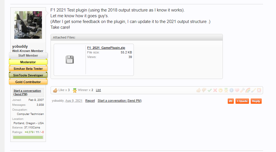

  13. noorbeast
    22,225
    154,819Coins
    +11,226 / 57 / -2
  14. Cava
    Cava New Member
    Sep 28, 2023
    16Coins
  15. noorbeast
    22,225
    154,819Coins
    +11,226 / 57 / -2
    See the earlier comment:
