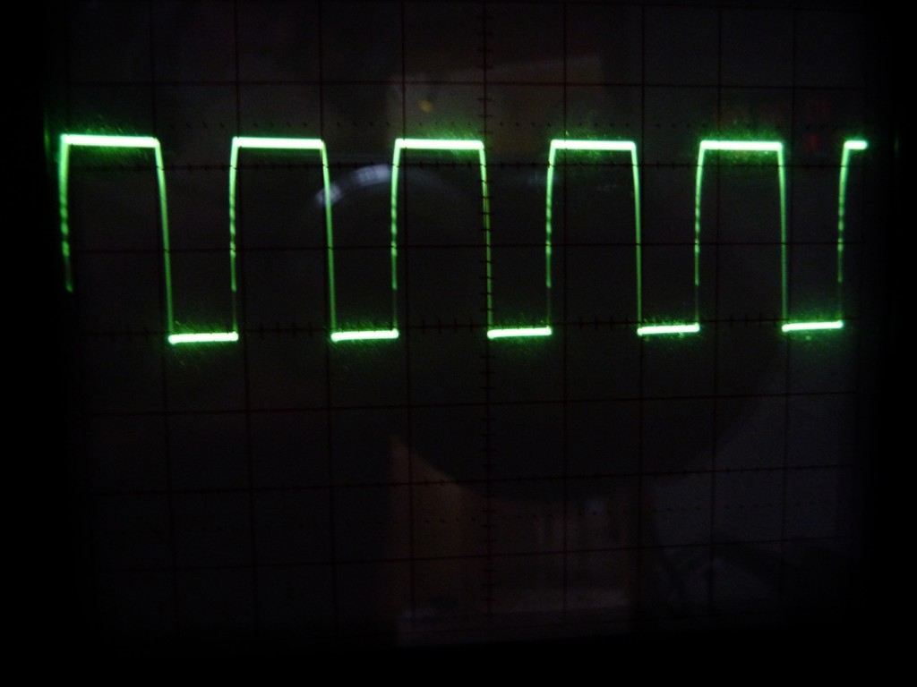

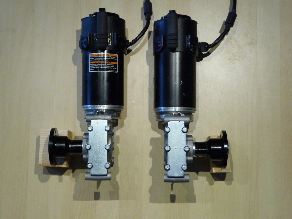

    Due to seperate problems of my wiper motors in combination whith the MM's i decided to look for new motors.
    After reading this threat:
    http://www.xsimulator.net/community/threads/cxc-simulator-racer-replica.7709/
    i looked at eBay for wheelchair motors and was lucky to buy this two:
    They have 4 carbon brushes each (the wiper motors only 2), run very smooth and quiet in both directions.

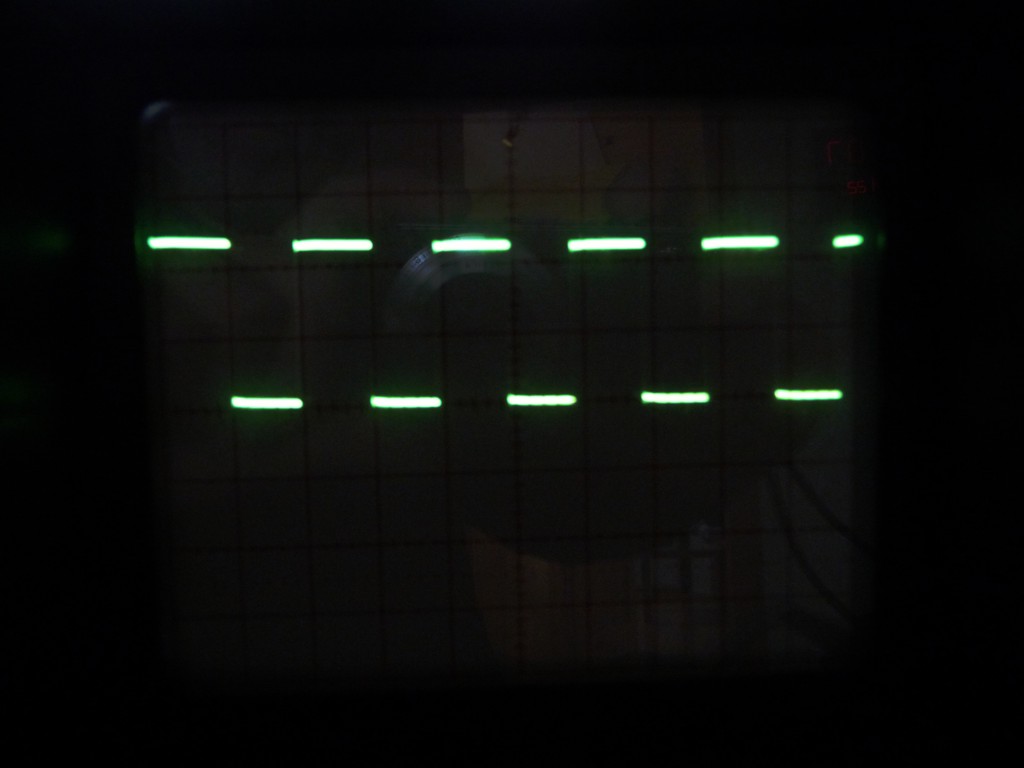

    I've made 3 Pics from my oscilloscope whith a constant PWM-signal
    1. signal from arduino to MM
    2. signal from MM to wiper motor
    3. signal from MM to wheelchair motor
    I have opened a new thread to show pictures and specs of the new motors and the changes made to my sim.
    http://www.xsimulator.net/community...er-v2-0-reloaded-with-wheelchair-motors.7905/
    Thanks to everybody for watching, replying and rating this threat.:thumbs
