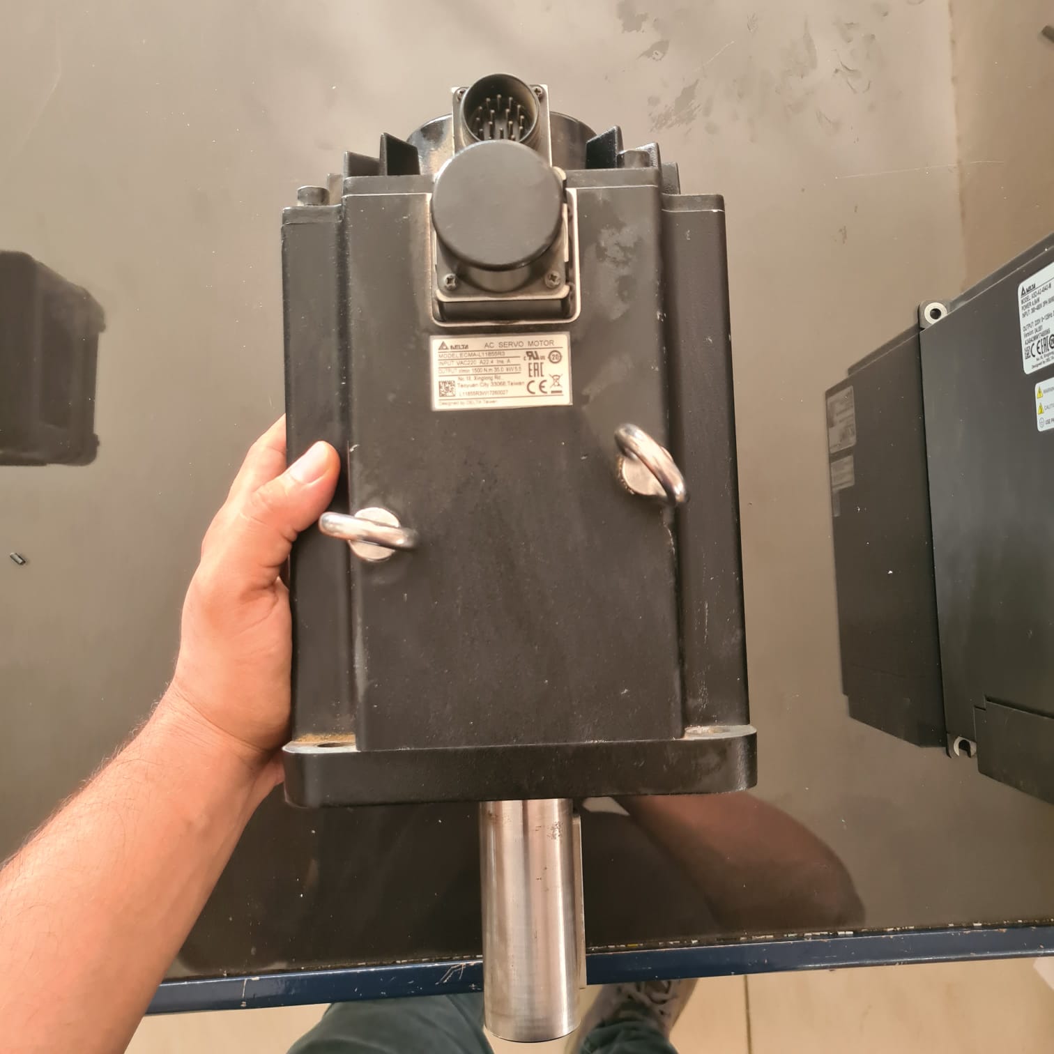

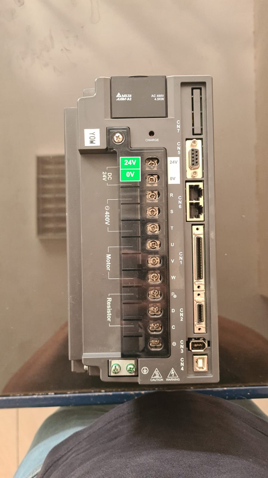

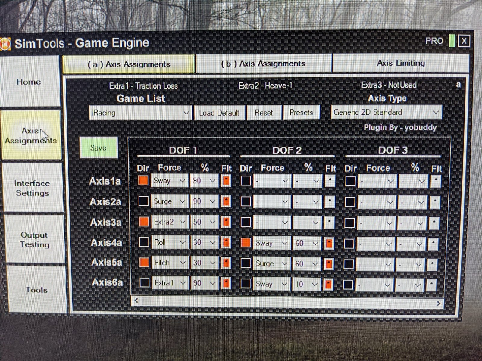

    HI, this is very good engineered work your cod works perfectly also with ALL DELTA AC MOTORS, i tried and worked well,
    and what are the preferred AXis ASSIGNMENTS in SIMTOOLS?

    I have attached a screenshot of my Simtools as it was for iRacing, this illustrates the force and direction for each axis as well how I blend 2 forces into an axis. obviously each game will be different, but this is a good starting point.
    your results may vary, and I recommend starting with very small values on each axis, to ensure safety.

    yes, Of course, I will post all the construction here when it's finished while I'm building a simulator using the Microsoft Flight Simulator and I will use your plugin

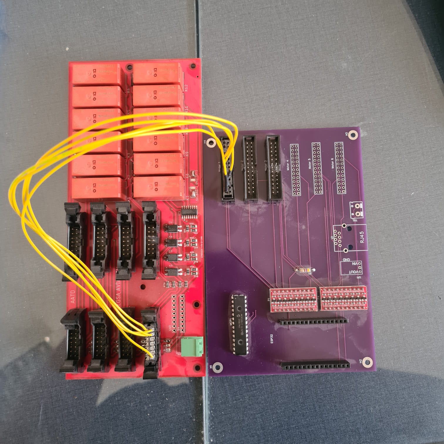

    also, I designed a PCB to interface with delta ac servo motors, and all this is back to your amazing work :thumbs
    thank you.
    I will publish all mechanical calculations, cad designs, and interface PCB
    Could you please publish the axis assignment for Microsoft Flight Simulator?

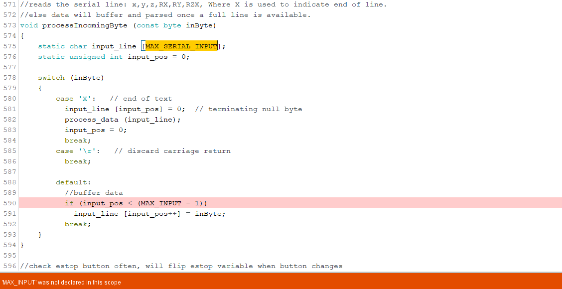

    okay, thank you for your support, in the last code in the git hub I found a compilation error as shown in the image in I replaced the "MAX_INPUT " var with "MAX_SERIAL_INPUT" and the code worked well
    but sometimes only when simtools is connected to esp there is a sudden glitch (all motors going up all and down again with maximum speed). another problem the simtools connect and sometimes doesn't connect until i close it and open again
    I don't know why

    *edit - fixed the github project, i merged the change in 5 months ago from a Forker,... did not pay close enough attention to the merge
    I am amazed that there is a compilation error...i will need to investigate that,..no one has mentioned anything prior,.. and I swear I have pulled code directly and compiled it to the board..... may have got corrupted in a merge?...
    my local copy has MAX_INPUT defined in the helper.h, and thats what is being used in the serial parsing..
    not sure when MAX_SERIAL_INPUT was introduced,... I will try to update this week
