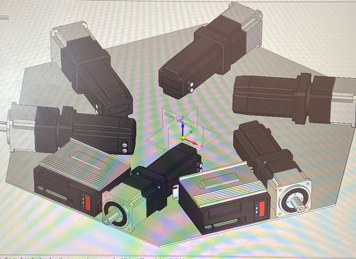

    Hello I hope youre still active on here but i would like to ask you something. For some background, I would like to build a sim rig based of of your design for a school project.
    In your design, you have a round base plate. I would like to use a hexagonal shaped one with the motor controllers next to each motor. I was wondering if the motors have to be aligned in a circle with the same center for programming or if this doesnt matter. I have designed a prototype and added a photo of it. Would that kind of design work and does it affect programming the whole thing??
    Thank you for youre time!
  9. knaufinator
    knaufinator Active Member
    Nov 16, 2017
    224
    Simulation Engineer
    akron,ohio
    1,955Coins
    +259 / 1 / -0
    AC motor, 6DOF
    I respond as I can, I have not used the sim for over a year up until today.. (wrote a red dead redemption 2 plugin... horse back riding here i come.....)
    the base /motor orientation is dynamic in the sense you can change it, though you need to modify the algorithm parameters when you do so. the inverse kinematic algorithm is based on an excel file i found and then converted it to c++ and scaled to the motors/gears in the ESP32 microcontroller - the file is - https://github.com/knaufinator/6DOF...aster/Technical/StewartPlatformSimulator.xlsm
    you need actual MS Excel to make it work correct, as it uses Macros. if you study this, you should be able to understand my controller. .. any orientation you can get this file to properly calculate, my algorithm/ controller should be able to handle.
    the layout you have in your picture though I do not know if it is possible with the algorithm,... at least I had not seen that layout in the iterations that I had tried. nor have I seen this layout before in general,... I went for symmetrical and as compact as I could. I am not saying its impossible,.. just never seen it before...
    the parameters that define motor layout, and frame connecting endpoints are in the helpers.h file.... there is a 1-1 for these parameters in the excel file

    yes, you would tune in the helper.h file... adjust the "servoPulseMultiplierPerRadian" scaling multiplier, pull out a angle compass and adjust this value and have the motor sweep min-middle-max, until it moves from -60 deg -> home/mid point -> +60 degree
    //how many pulses per radian of arm movement this value is calibrated to my setup
    static float servoPulseMultiplierPerRadian = 800/(pi/4);
    //controller.ino has the min max deg set at -+60 degree
    const float servo_min=radians(-60),servo_max=radians(60);
    you can also tune the ac servo driver to do more/less movements per step, as that may be useful as well, i.e. mine is setup to move 80 steps each commanded step sent from the esp32 microcontroller

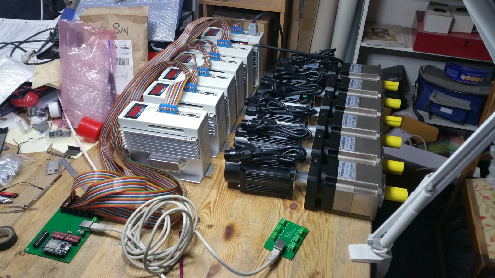

    Hi Chris, A bit late to the game here, but I went on a real Helo Trial Lesson for the second time last month. Decided at my time in life a helo pilots licence wasn't a viable prospect, so decided to embark on the next best thing.
    Saw your Github listing, and as a lifelong mechnical engineer/machinist with an electronics degree, I thought you'd given enough info for me to make one as well.
    So.... Motors and drives, turned up as did the circuit boards (the sensor array wasn't accepted by the manufacturer for some reason, but I just KiCADed another one) so all the boards are now soldered. Just awaiting on a ribbon cable male plug and I'm ready to start testing.
    I thought I'd clamp all the motors to the workbench, and get them moving in what appears to be a logical movement before doing any steelwork, as that pretty much a done deal, but the electronics (BLE) is something I've not played with, as is the XBox controller.
    I have a question or two, but have only read up to page 6, so I'll read the rest before pestering you.
    Can't thank you enough for sharing your endeavours, and the failures are equally as interesting as well.

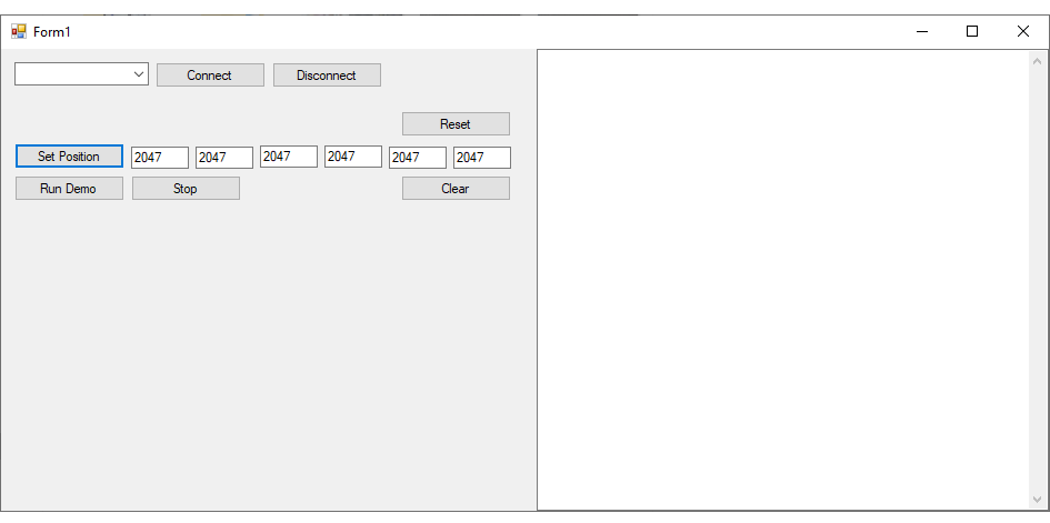

    Ha ha, chat GPT not doing so well, ...will give it a few more trys then if that doesn't work, will have a go myself. I managed to compile Arduino file (with your machine settings for now), and the VSC# (Form1) prog for testing.
    How exactly is Form1 used? I'm thinking it connects via BLE to the ESP32
    Set Position - Sends the 2047 (theorectically the mid position in this case) to the servos, is that correct?
    Therefore, before connecting the rods, I can send send each motor various settings for testing?
    XUgh, real life chores getting in the way... just gotta add a bit of power to the servos and we're ready to play :D
    Regards
    GB
  18. knaufinator
    Nov 16, 2017
    224
    Simulation Engineer

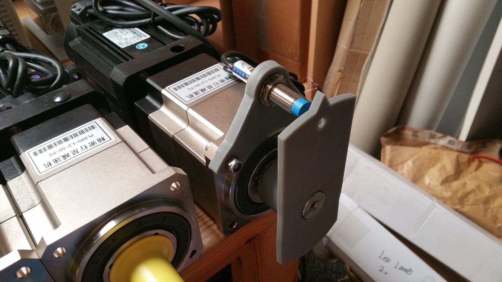

    Made a temp bracket for the sensor.. (Pointer started as a disc but was too big for my tiny printer, so unnecessary bits had to go)
    ... and just need to upload the controller.ino sketch.
    I may need to get yet another ESP dev board, as the Arduino IDE is giving space errors
    Code:
    sketch uses 1365069 bytes (104%) of program storage space. Maximum is 1310720 bytes.
    Global variables use 44612 bytes (13%) of dynamic memory, leaving 283068 bytes for local variables. Maximum is 327680 bytes.
    Any comments?

    it has been many years since I last compiled the controller, I suspect that one or several of the libraries now take up more space than they use to. Best course of action would be to remove some unused code ,.. should not take much to get 4% back. I dont have an arduino environment up and running right now, I have since moved to using only VS code, but I can see about installing it, testing it out, and then removing parts that are not used ... I.e. bluetooth, and the filtering code I would kill first.
