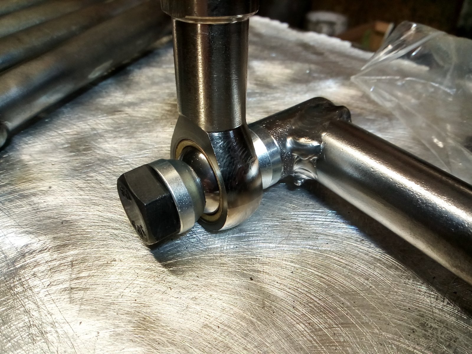

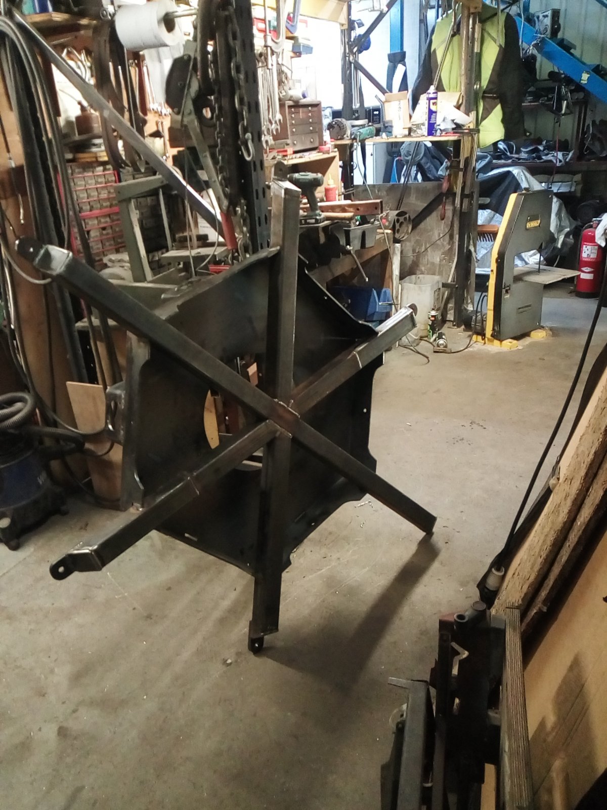

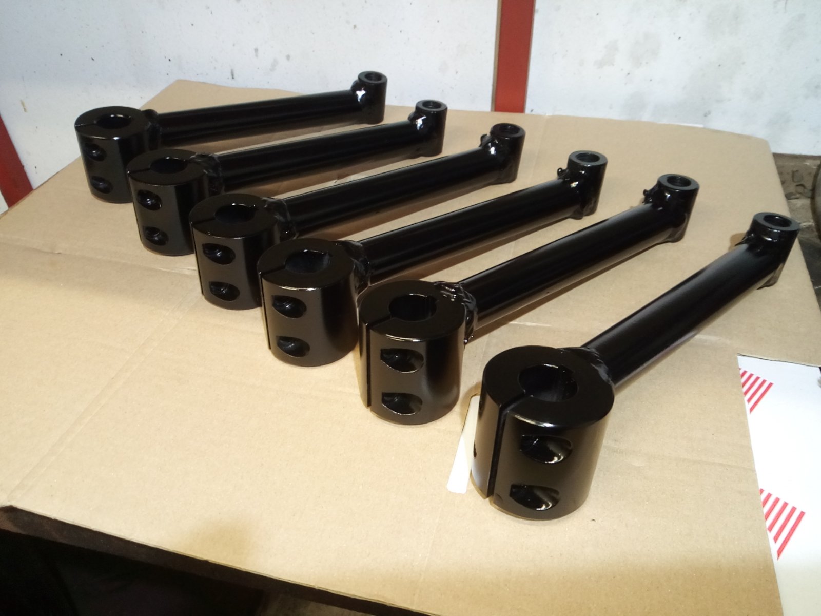

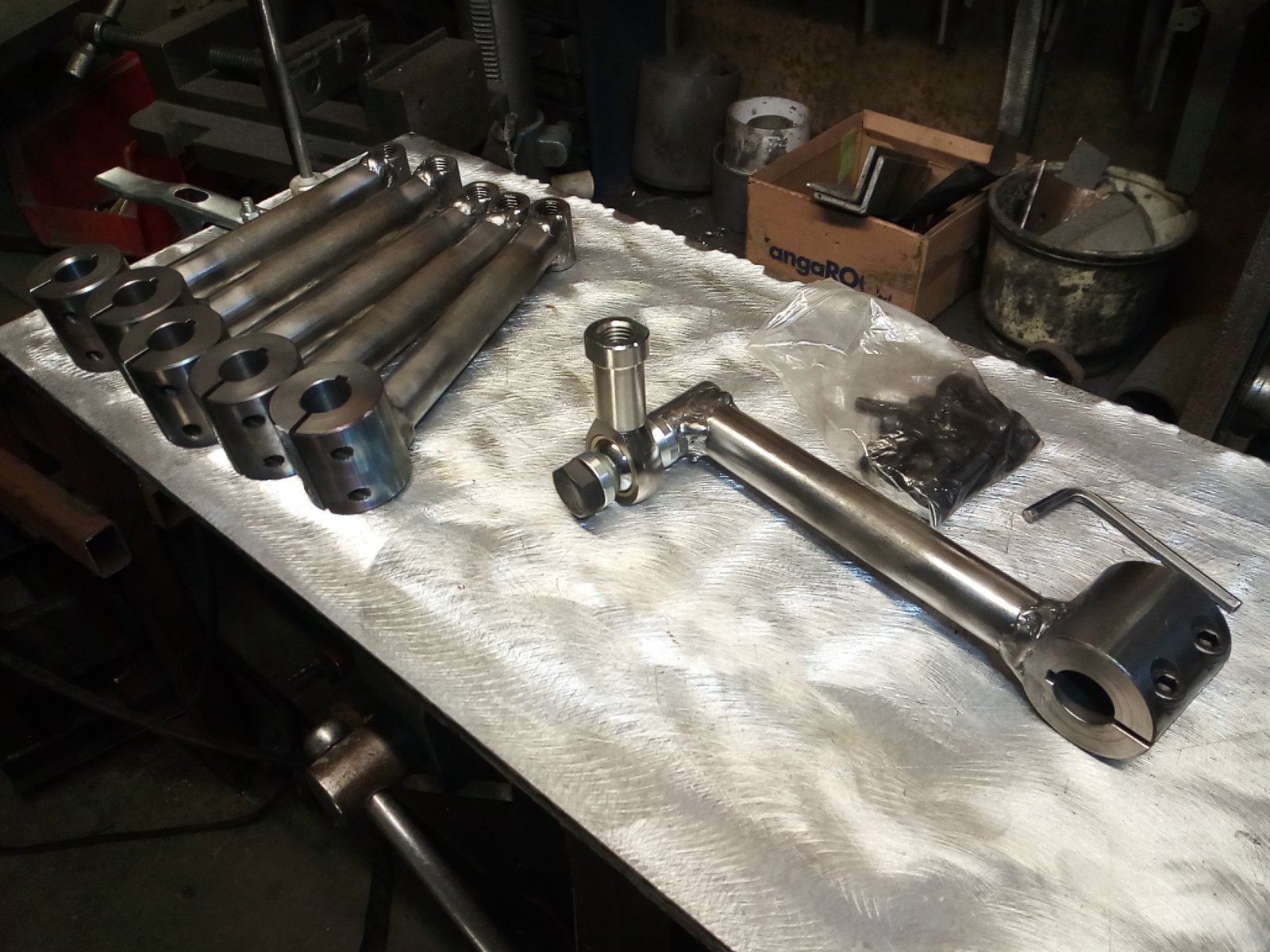

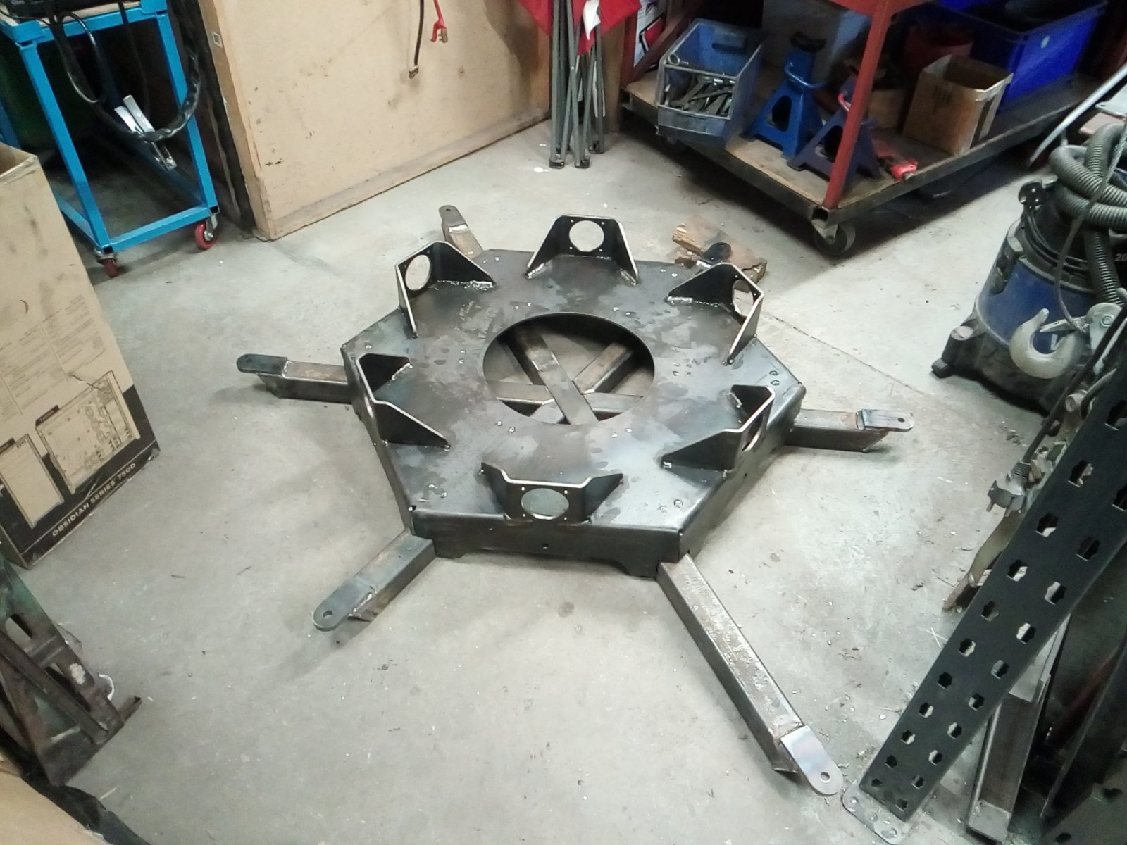

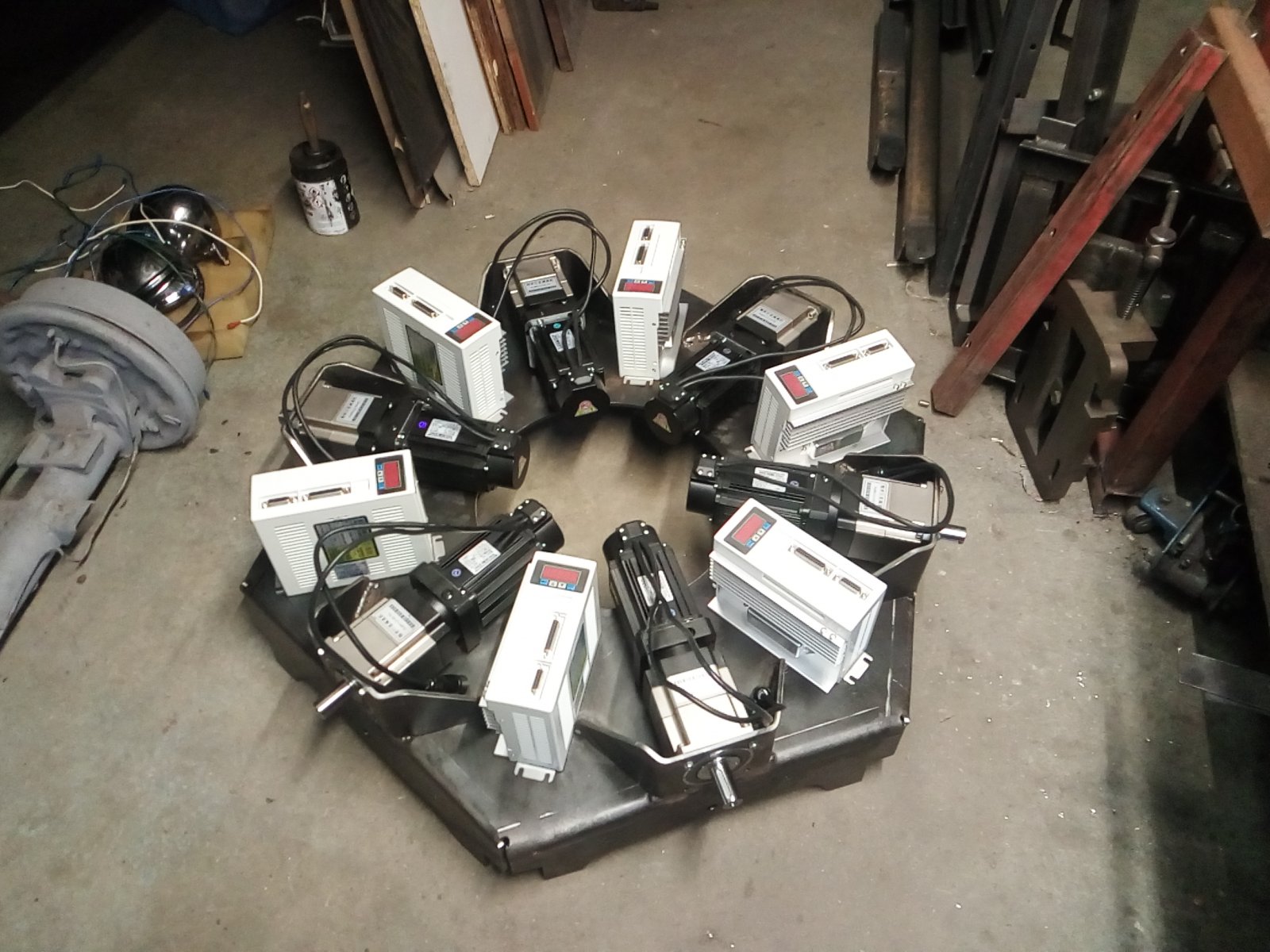

    This is taking longer than expected, mainly because I have a motorbike & car project running as well... here's my progress.
    The base was based on Smittys' shape, but went with more or less your arm design because I couldn't justify CNC costs vs making them myself.
    I also saw one of the guys on your thread put the servos on the base which I also liked, and plan to do the same.
    I'm considering placing all the servo control gear underneath but for problems with any maintenance in the future so not decided on that one yet.
    So thanks again Chris, all made possible by your generosity in providing decent open source info.
    Regards
    GB

    Hi Chris, Got my rig powered up, and am trying to config it. Can't do too much yet as I haven't wired the E-stop buttons yet, and feel after re-reading your posts, you make a point of fitting them, and I know I really should.
    With respect to the numbering of the motors, I've just installed Simtools v3, and the image in the setup window shows motor No.1 to be approx 1 o'clock , with motor No.2 at 3 o'clock, No.3 at 5 o'clock, and so on. Is this how you laid yours out? Looking from the rear, forward.
    Then these should marry up to the motor numbers on the control circuit board?

    front right is 1, then clockwise till 6

    Cracker. I'll get on it.

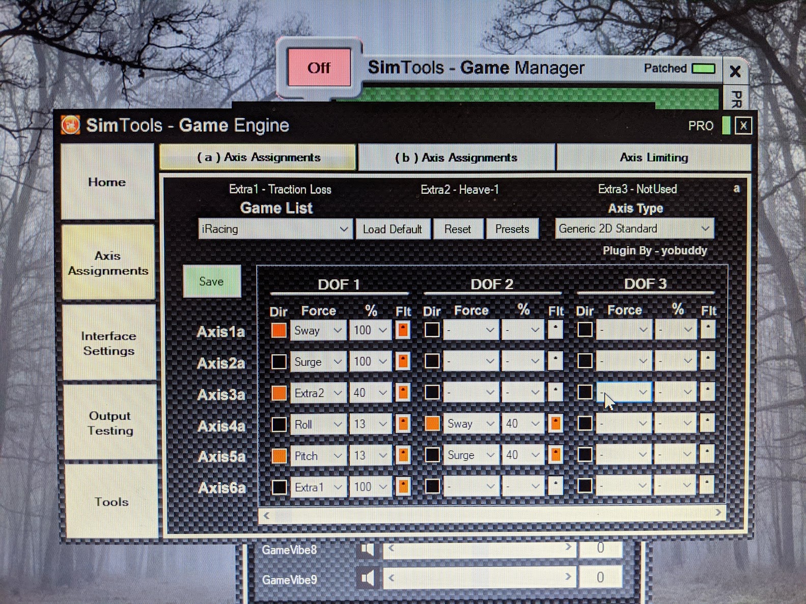

    I'm having a problem getting any pitch output from Assetto Corsa, it seems to output pitch when running over kerbs. But almost nothing for acceleration. Id like the chair to tilt back somewhat when accelerating.
    Is this just how Assetto is? or can I edit files?

    you need to blend in the idea of lateral /longitudinal forces into the pitch/roll axis, here is an example setup, look at axis 4/5, i add/blend the sway and surge forces into the pitch and roll axis.

    Good day, tough questions,
    1) it really comes down to subjective compromises, I would not want to reduce the power output, my quest was/is fastest/strongest. I dont think there is 2k worth of savings and still having the same capability..... my rig is good because its overengineered. AC servos are essential in this as well, they speak the language that my PCB was designed for relative positioning
    2) you COULD do this, but the other part of the equation from above is to make the chassis as Light as possible, humans are heavy, mechanisms for seats heavy and will induce more slop in the movement. light and ridged is the goal, but again, ... subjective to the users goal.....
    3) yes, my rig is silent, the hum of the ac servo drivers is louder than the movement. it also has similar articulation as the linear actuator versions., ~11 inches of vertical heave movement,
    4) I am trying to restart the project in my spare time, I am making the controller faster and more precise, as well as some other safety related PCB changes. but summer is around the corner and i am knee deep in building a race car, so we will see how much progress i make.

    I estimate the rig—including all gear (monitor, wheel, seat)—to weigh around 100 lbs, with my own weight adding roughly another 200 lbs. I’ve safely tested riders up to about 300 lbs, although at that point, the primary issue I noticed was that the base plate began to flex during heavy maneuvers.
    This plate is a 1/2-inch thick steel disk with a 30-inch diameter, and under load, its flex becomes noticeable. While it might be possible to support an additional 200 lbs, I wouldn’t recommend doing so without reinforcing the structure. Key improvements would include:
    • Reinforcing Structural Components: Use thicker steel tubes or plates.
    • Upgrading Hardware: Implement larger heim joints.
    • Adjusting the Drive System: Employ different gearing along with larger swing arms or shorter arms to reduce force on the motors.
    • Increasing Motor Capacity: Consider stepping up to a larger AC servo, such as a 90 or even 130 series, to achieve a stiffer, more robust setup.
    Ultimately, weight is the main enemy here—the lighter the rig, the higher the dynamic frequencies it can safely achieve.

    its been used, and should work if you construct it ridged enough, the actual steel chassis though on mine only weighs around 25 pounds. the cost savings of just welding it from steel tube was not insignificant. ... though i did have to learn how to.

    A "sandwich" plate made out of two 1/4" plates with some rectangular pipes in between is much stiffer than a single 1/2" plate. Of course, welding them together is much more work but the sandwich approach can help to reduce overall weight.
