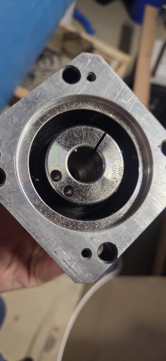

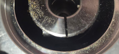

  14. knaufinator
    knaufinator Active Member
    Nov 16, 2017
    213
    Simulation Engineer
    akron,ohio
    1,883Coins
    +246 / 1 / -0
    AC motor, 6DOF
    normal, just remove the key from the motor, and tighten the screw for the shaft clamp, there is an access hole on the side.

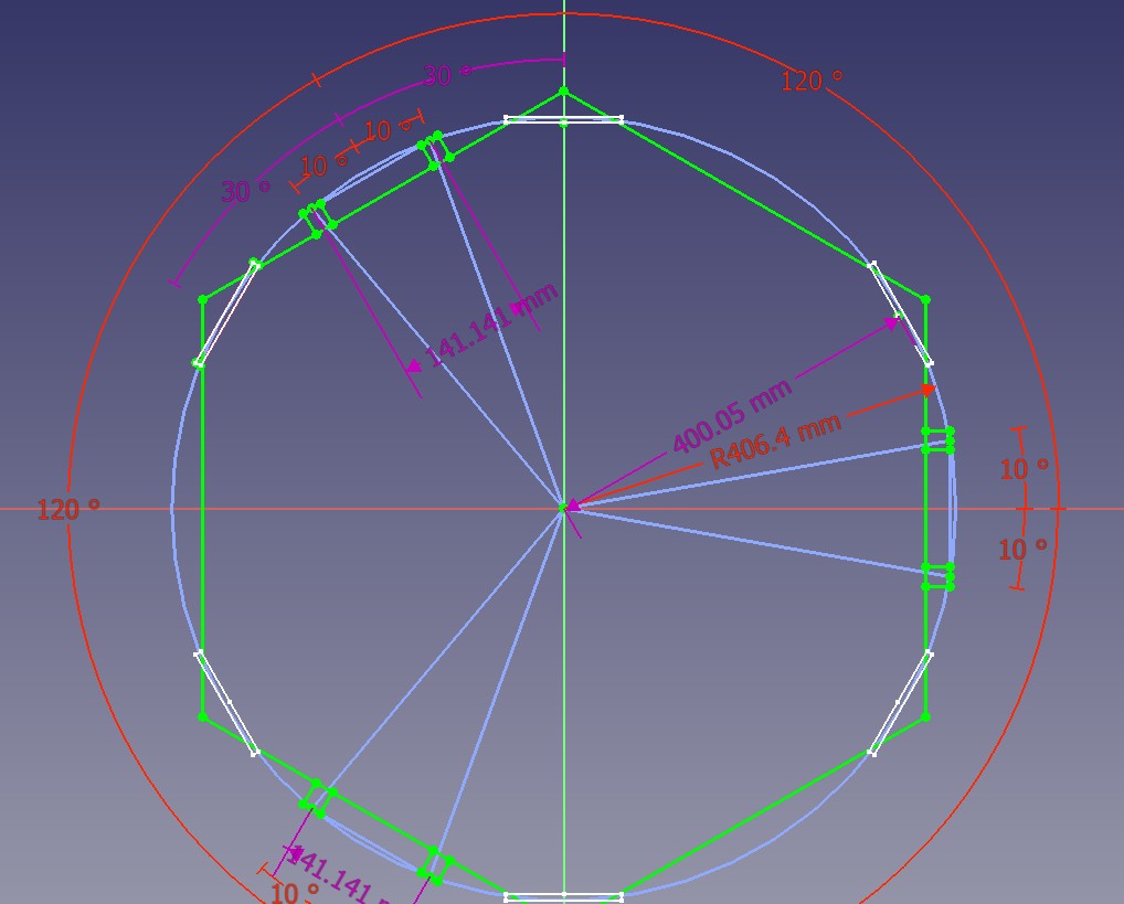

    Hi Chris had a couple questions if you dont mind.
    - The Servo arm is 7.25Inches, i'm assuming that's from center to of shaft to center of shaft, but what is the depth? Or does that not matter and you just find the angle after it is built, that is the Theta_R?
    - The IDC connectors goes from 26pin to the DB25. I want to have pin 26 be unused?
    - You added some steel tubes then added some additional spacers on the bottom of the plate, how much did you end up having to lift it for the arms to clear?
    - I got a little confused on the layout description, do i have this right? From the 120 degree marks, the platform bungs are 10degrees away from either side, and the motors are 30 degrees? In the attached, the white lines are the motor mounts and the green is the platform. I have it as a hexagon but i'll probably adjust it a bit, I'm still looking to get a chair ATM.
  17. knaufinator
    Nov 16, 2017
    213
    Simulation Engineer
    akron,ohio
    1,883Coins
    +246 / 1 / -0
    AC motor, 6DOF
    1) center to center yes, the end point is the only point of concern, where you attach the heim joint/long arm
    2) yup
    3) the base plate is off the floor 5 1/2 inches (floor to bottom of plate), this gives the swing arm about 1/2 clearance to the floor, this is a pinch point watch ur toes...
    4) yes, your layout looks correct, and I used the hex and the layout guide when i built it, then adjusted to fit the seat.
