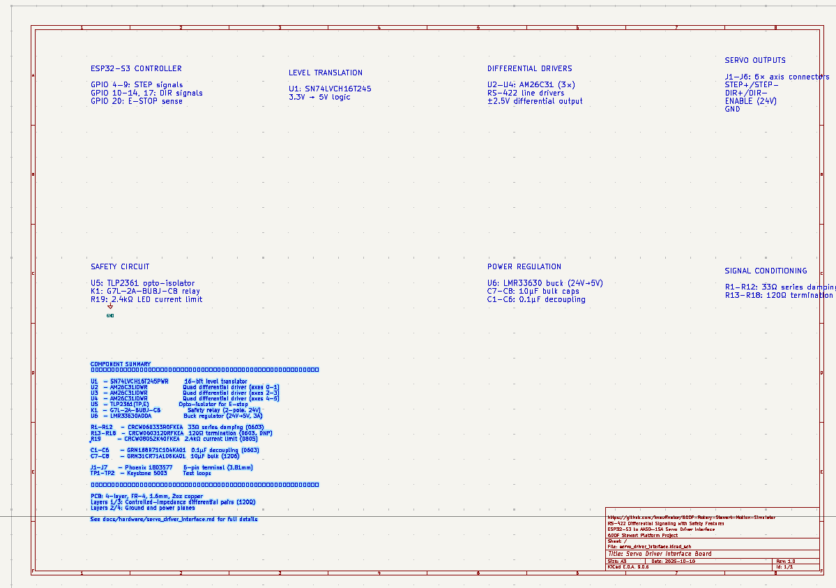

    Omg I'm already suffering at the first steps. When I open the kicad project file I can't see any symbols or connections. Am i doing something wrong? It looks like this:

    at the top of the default branch (pheonix) readme - "This branch is currently a work in progress and does not yet have full functionality. It is being actively developed and updated regularly as development continues."
    What you want is the old working branch "master" not the newer Pheonix branch - direct link - https://github.com/knaufinator/6DOF-Rotary-Stewart-Motion-Simulator/tree/master

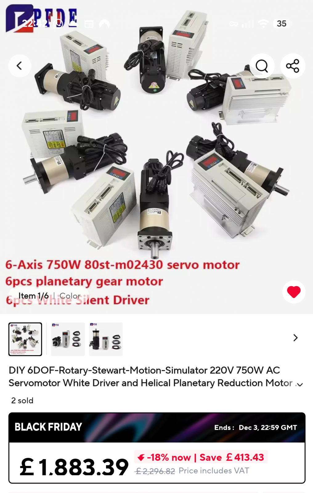

    I am planning on buying a 6dof AC servo kit from Aliexpress. The motors with 50:1 gearboxes and controllers work out at about £2100 delivered to UK.
    I can't post the link yet as I've only joined the forum but I'm attaching a screenshot. It is listed under this name:
    DIY 6DOF-Rotary-Stewart-Motion-Simulator 220V 750W AC Servomotor White Driver and Helical Planetary Reduction Motor 50:1
    Is this what I should be getting in terms of closely following the project?

    wow, they made a full kit! yeah, this looks like the right stuff
    its interesting, that the title even matches my github repo name - hmmmmmmm
    " 6DOF-Rotary-Stewart-Motion-Simulator"
    https://www.aliexpress.us/item/3256808046771564.html?gatewayAdapt=glo2usa4itemAdapt

    i just looked at my orders from 2020 ish, $260 per gear, $217 per driver, x 6 = 1560 + 1302, = $2808, in 202o money. the kit with 6 drivers + 6 gears, appear to be $4000 ish USD, so an increase in 1/3 of the cost, this could be due to tariffs... likely... due to tariffs , hard to say if your price is good...
