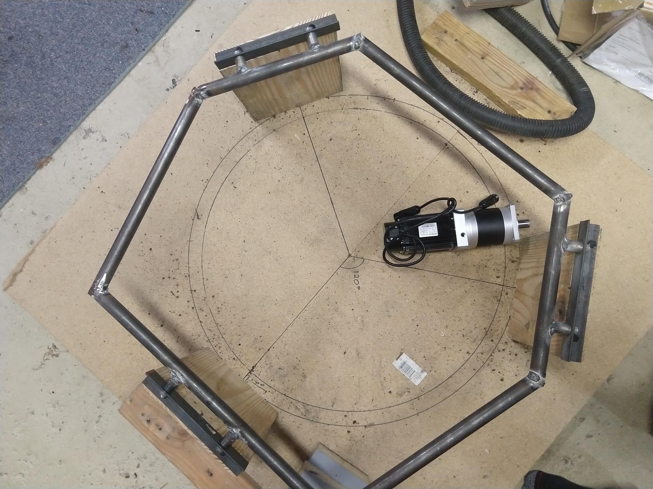

    what the unit of the 70? 70mm?
    and which axis of servo is the 1st servo and which is the second?

    AC motor, 6DOF
    The motor you see in the image you posted, is #1, then it goes clockwise from there, 2,3....6.

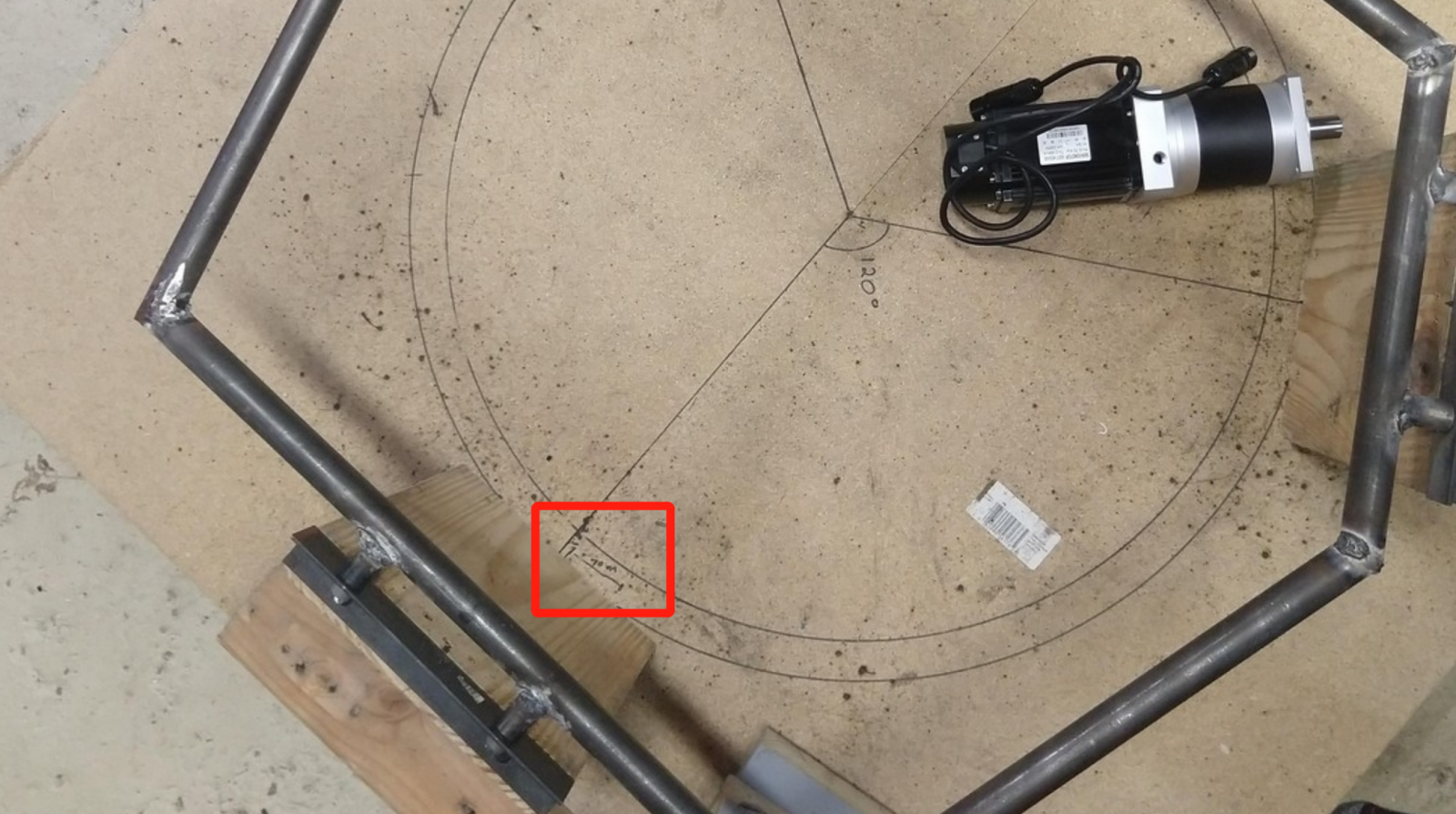

    AC motor, 6DOF
    That was the distance from the center of the two connection points - to a connecting point, so the distance between two connecting points is ... 140 mm = 14cm as shown

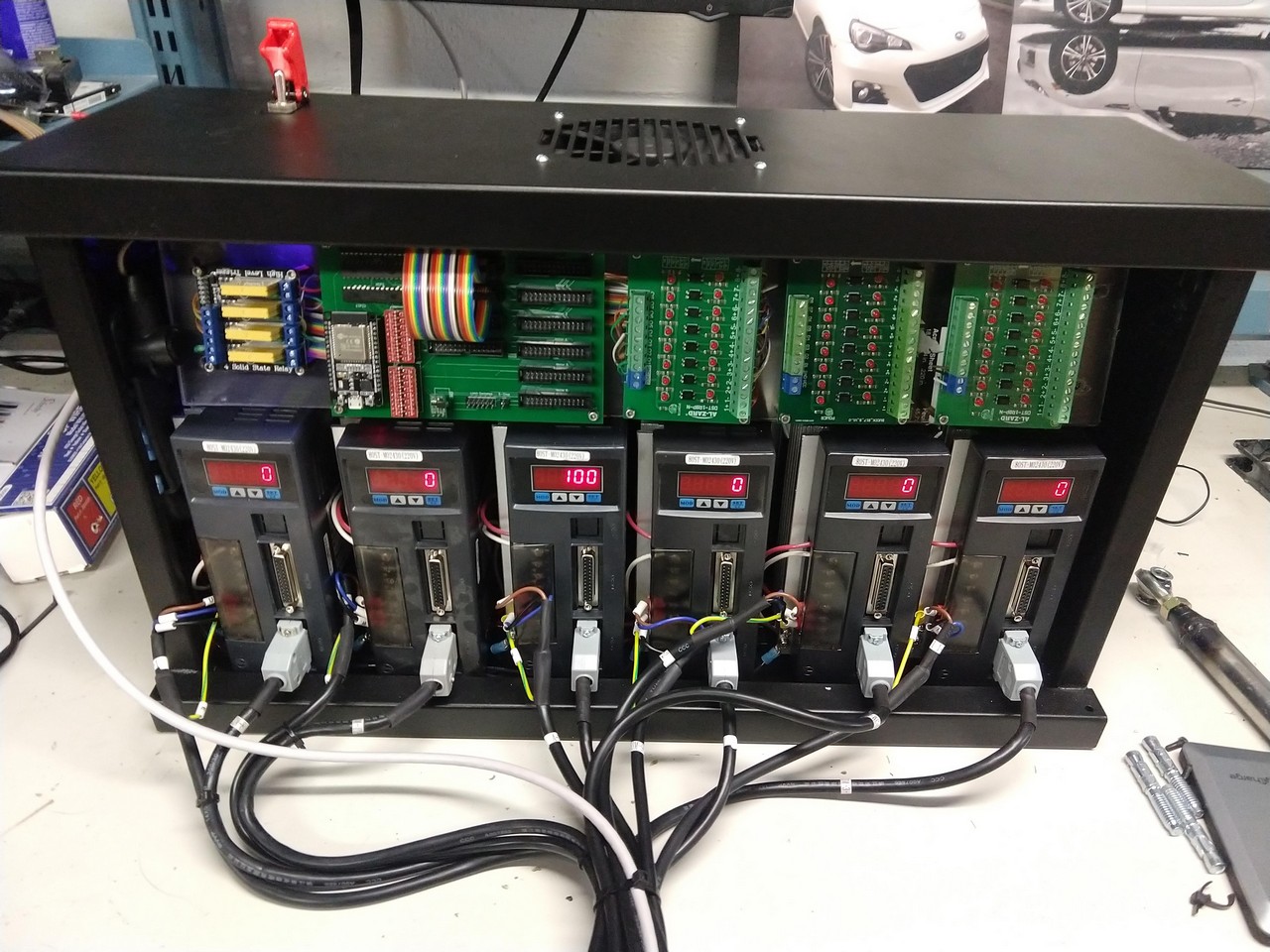

    AC motor, 6DOF
    220v line, then to the servo drivers(aasd15a) that come with the 750w ac servo/motors, check out the build album... I've got them all stuffed in a 6u server box

    Sir,I have few questions and I will be really appreciated if you could enlighten me.
    1: what is the voltage level of the servo controller pulses,24v or 5v.I’m having these two options here and I seriously don’t know how to choose it.
    2: as picture of your controller box shows,there are four more pcbs on the upper area (except the controller board)I don’t understand,would you be kind to tell me what they are for.
    the PCB sends the servo driver 5v signals for position control, there is also a 12v line that is used for the arm position sensor /hal sensor.
    Those extra PCB's where for when I intially overengineered the design,. .. they are not used, ... I just kept them on the panel because I made the panel for all those pcbs... and now would look naked without most of the pcbs..... true story.

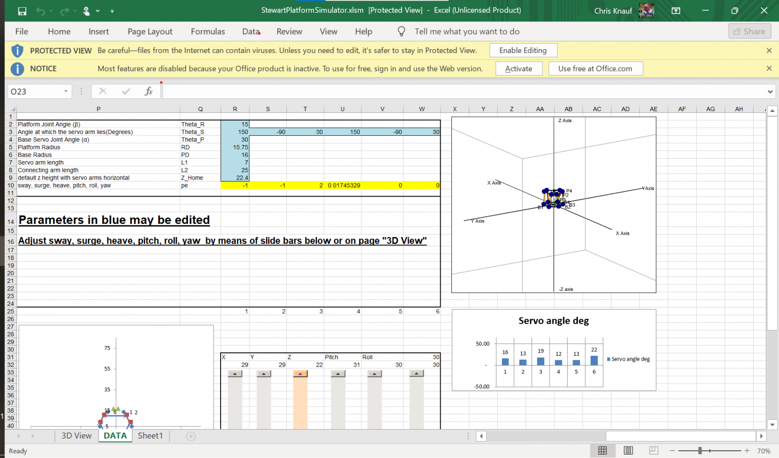

    3: there are several values I couldn’t understand about the platform positions such as “therta_v”.
    theta
    Check out the excel file in the technical folder in the github project () , it describes and illustrates the algorithm used in the microcontroller. it also allows you to visually see the motion with inputs, and change sizes, and see effect.. it works best in Microsoft Excel ,.. it kinda works in Google sheets... i reccomend snagging a trial of excel and investigate the file. it also defines each variable.
    I did not make this file. just reverse engineered the concept to C++ code
    https://github.com/knaufinator/6DOF...aster/Technical/StewartPlatformSimulator.xlsm
