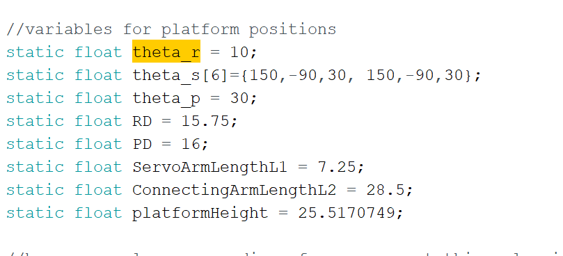

    Sir, if according to your design, should theta_r be 10 or 15?

    theta r should most likely be 20 if your diagram was accurate. It has been along time since I looked at this level, and I know that particular value was ballparked,... I did not even think about making a diagram and mathing it out.

    Hello sir, I've spent sometime to investigate the excel to learn about the structure, I think I just found a good combination, but something confuses me. In the graph with you value, it seems your structure causes axis error easily when I tried to pull down the Z axis values, I asume it indicates the structure can't make full use of the sevro arm length to get to the lowest point. But that's not true in your video. So I'm really confused what does the error mean.

    Good question, this really takes me back,... at this point is been 3-4 years since I wrote this code. this stuff is getting harder to remember, so its good you guys keeps asking stuff,,,
    I recall the max limits in the excel file being impossible to hit due to issues such as you mention, as well some values also would cause structural impacts... like arm striking against the chassis, so I scale what it can accept from the pc., and then pass this scaled value to the inverse kinamatic algorithm.
    if you look at the controller.ino code , more specifically this scaling portion of the controller code below, i scale the heave value to a limit of +/- 7,.. then if you look at the excel I bet 7 is an ok value to use, and it still uses a good portion of heave.
    this code is directly after consuming it from the pc.
    You should modify these to you own platform, be aware of combined loads though, you just dont want to smash into things.
    for reference I have almost 12" of heave with these limits in place.
    //these are tuned to my specific platform,.. to ensure a value does not get to high and break something
    //todo, make this dynamic and locked in from the android app
    if(i == 2)
    temp =mapfloat(value, 0, 4094, -7, 7);//hieve
    else if(i > 2)//rotations, pitch,roll,yaw
    temp = mapfloat(value, 0, 4094, -30, 30) *(pi/180.0);
    else//sway,surge
    temp = mapfloat(value, 0, 4094, -8, 8);

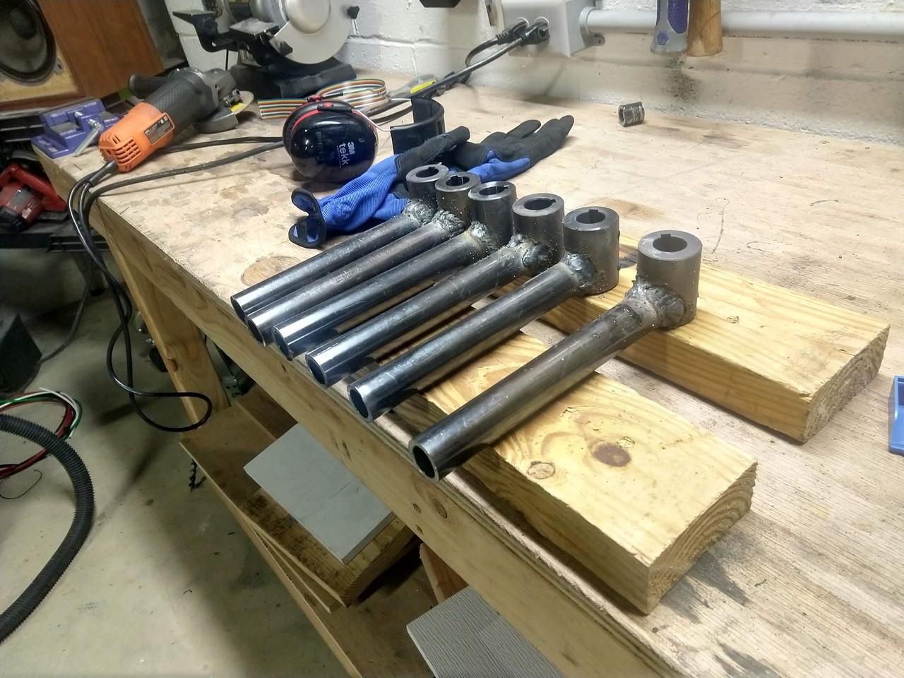

    Hello sir, it's been a while, my design is during construction following your advice, and I encountered two issues.
    1:Is the emergency button just a overall system power disconnection, or it's a set-still signal from the controller, if it's just a power kill, I'm concerned whether this may cause some damage to the motor.

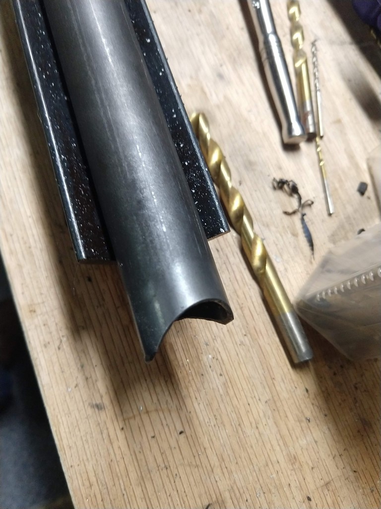

    2: What kind of tool you use to cope with the tube ends.
    Thank you for spending time for my question, my deeply appreciation。

    The PCB estop, is used to Pause the motors, not power kill. I did not want to default to dropping the rider,... a pause is normally good, and I use this often ... like.... before I hit walls ... then reset the button, and you are back in the game in just a few seconds,,there is a ramp up algorithm in place so it eases back into where it should be.
    I also have a POWER KILL button on the sim, that I can use if a pause is not enough.... if something bad happened... This is wired in series with the main power switch that holds open the relay, to power the drivers. This WILL drop the chasis,..
    there is no damage to the motor, when you power kill,.. they just gracefully fall to the lowest point..i.e.... i hit the switch when I am done, and it falls.
    To Cope the tube, I used a 1" hole saw in my drill press,.. then pressed it to the 1"OD tube, while the tube was sitting in that angle iron that you see, the angle iron has a flat bottom welded to it, so it will stay flat under the drill press.
