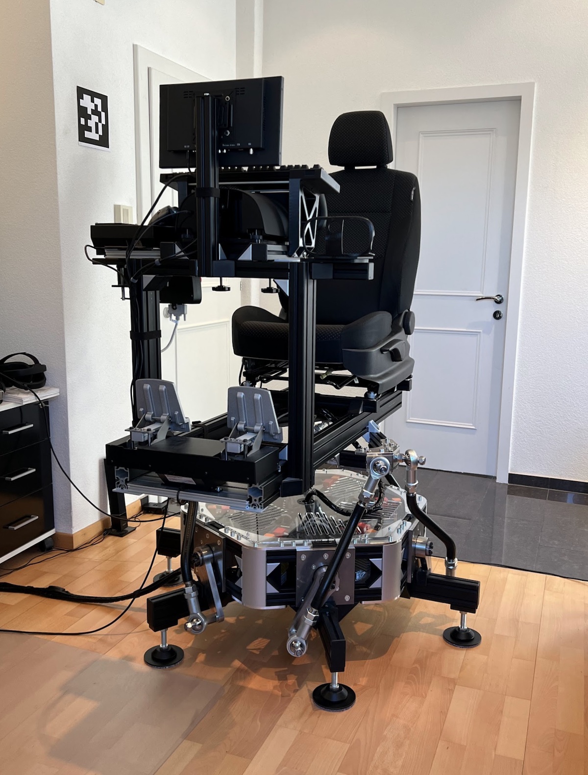

    one issue at a time.
    I add sway and surge into axis 4a and 5a, this then sends a scaled surge force and sway signal to the pitch and roll axis on the ESP32.
    isolate this into one force for troubleshooting,.. only have one variable entered in the tune. i.e sway in 4a,... does this one force cause the platform to roll. when turning the car...
    as for the aggressive drop.... I have no idea...when you turn on the DOF test the first thing it does is start sending out the home position, i.e. "2047,2047,2047,2047,2047,2047X" does the rig respond the same way when you send this command over arduino serial monitor?...

    I do not manually do anything,... when the platform is turned off, the arms drop, to a known location, i then have the AC servo driver properly setup to handle the correct direction to travel on power up.... if you have arms that are going the Wrong way on startup, you need to change the direction they move for power on/homing...

    I agree, you need to modify the design to not have those arms there,... Mine is bolded to concrete, and arms could swing 360 degrees if there was not rig attached.
    mine early on in the process became airborne,... I recommend bolting to the floor if possible...

    you should set up the AC servo Driver for the arm to travel to HOME/mid point, once it hits the hall sensor. one degree just sounds like the default behavior without you programming in where it should go.
    The ESP32 controller assumes,.. when it starts doing stuff that you are at the home position,.. if you are not,.. unexpected/damaging... things will likely occur..

    no, the starting point is ASSUMED to be horizontal,.. and already prepared.. ..
    YOU NEED to setup in the AASD driver, the correct home position. the settings for which are at the bottom of the GitHub project readme, ...
    the reason for the sensor at the top, is because,.. it will be asssumed that most likely if you have a rig attached, gravity will have moved the arms down.. below the Tippy top point, and on the correct side it should be because there is a giant metal rig attached to it. forcing it to that side. when it hits the sensor,... have the driver though the settings for each individual motor,.. to move to the correct horizontal starting point. this will zero the platform, and allow my ESP32 controller to take over from there.

    The ESP32 controller is not preventing this, debug or not.
    You need to set it up MANUALLY on EACH AASD Driver.

    Sir, I did the test, indeed when I send 2047, it does the same thing, But 2047 should be the home position why it drops?
  17. FeidhlimLee
    FeidhlimLee Member
    Oct 31, 2021
    61
    422Coins
    +13 / 0 / -0
    I send 2047 it drops to lower position and I turn on test, it drops again and take the double droped position as home, but if i restart the motor(not the controller), it's all nomal, without dropping... it seems I have to restart the motor twice to get normal.

    Thats a good question, I have no idea, ... when the esp32 turns on ,.. it assumes it is at 2047,2047,2047.... /home .. at least as it is as I had the code calibrated. did you modify any of the parameters in the code or does this happen with the code as it is in the github repo..? no one has commented about this happening.
