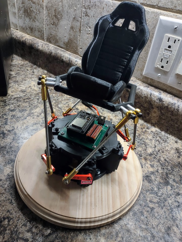

    I built a scale model of the simulator, .... as well a PCB for it,.. using a fork of the Open 6dof code.
    Once I finalize this, I will post it to Github for people to learn off it,. ... before jumping into a large scale build.
