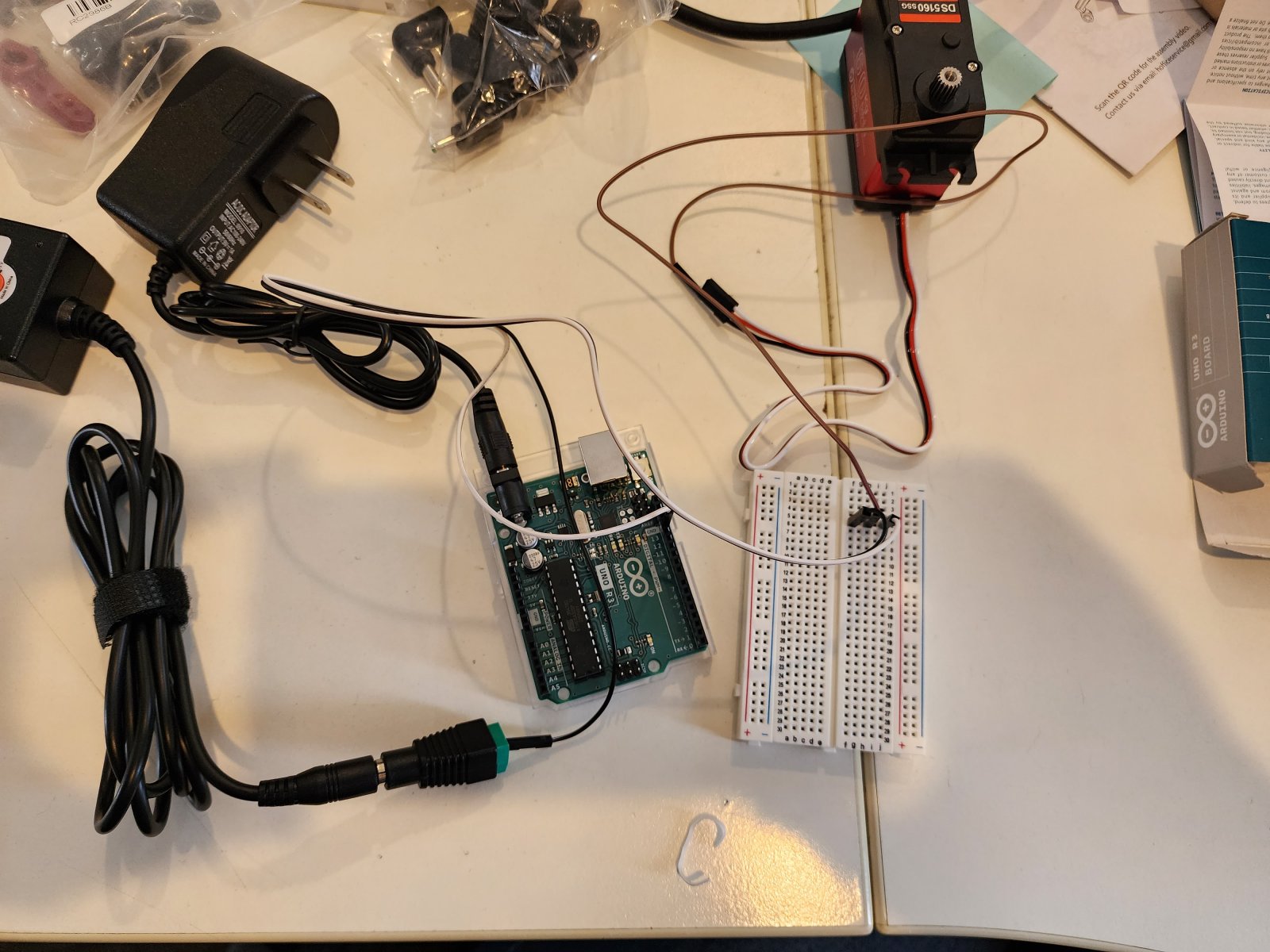

    Thanks, I'll take your suggestion on the chair.
    Will these work for all the Arduino needs?

    I don't think you need all this. I'd buy these:
    1)Arduino Uno card:
    Arduino Uno REV3 [A000066] https://a.co/d/gS6t7tI
    2) A cheap breadboard:
    (4 Pcs) MCIGICM 400 Points Solderless Breadboard https://a.co/d/gXQjCpx
    3] And some male to male jumper wires (I used the 30cm and 100cm wires, but maybe try the 50cm wires to see if they work for you?)
    EDGELEC 120pcs 30cm Breadboard Jumper Wires Male to Male Multicolored Dupont Wire 11.8 inch 1pin-1pin 2.54mm Connector for DIY Arduino Raspberry PI 10 15 20 30 40 50 100cm Optional Ribbon Cables https://a.co/d/a3J80A6

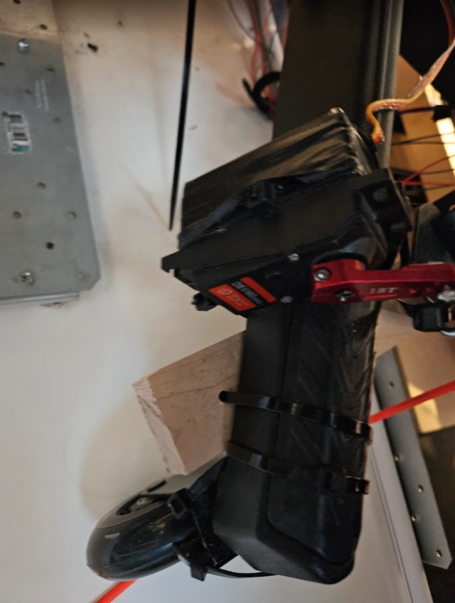

    Could you take a picture of how you attached the servos to the lumber and shoulder seat belts? I'm looking at the youtube video but can't make out details.
  11. Jumping Coin
    Jumping Coin Member
    Aug 7, 2020
    95
    82Coins
    +54 / 0 / -0
    Sure thing. I'll try to take some pictures over the weekend.

  13. miketunes
    miketunes Member
    Aug 25, 2023
    40
    254Coins
    +1 / 1 / -0
    I copied your color scheme but I think I still need to connect the positive wire? Not sure where it goes.
    I have black ground from power supply to breadboard, white ground from arduino to breadboard, and brown connecting negative on arduino to breadboard.
  14. Jumping Coin
    Jumping Coin Member
    Aug 7, 2020
    95
    82Coins
    +54 / 0 / -0
    Hi, positive wire goes directly from power source to servo. No need to plug positive wire into breadboard. Hope that helps.

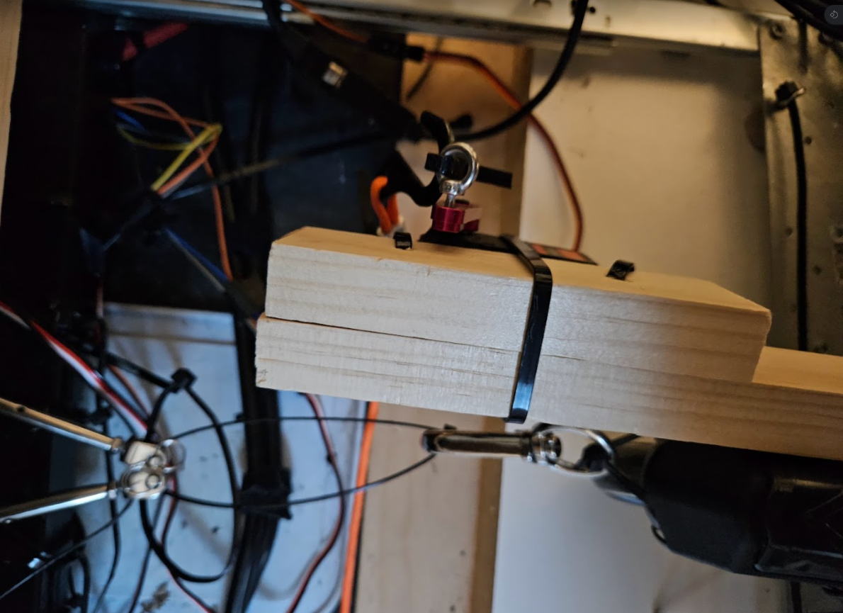

  16. Jumping Coin
    Jumping Coin Member
    Aug 7, 2020
    95
    82Coins
    +54 / 0 / -0
    Hi @miketunes, here's a few pictures I snapped.
    Servo ziptied with some electric tape to chair pedestal. (Servo arm connected to hip seat belt)
    Servo connected to chair pedestal at front of chair, which pulls on braking. (Servo ziptied to holes in wood, and wood connected to chair pedestal via zip ties)
    Servo ziptied to wood, which is ziptied to rear of chair pedestal. This is what I used for pitch via connecting shoulder seat belt straps. Originally I thought I might need 2 servos, but it's been working fine with just 1.
  17. miketunes
    miketunes Member
    Aug 25, 2023
    40
    254Coins
    +1 / 1 / -0
    Thanks, question about the wood. I have a 4ft piece of 1.5"x0.75. Looks like I need to cut into 2 long piece and 2 short ones? Is it just the front pieces of wood that have are doubled up with another piece of wood? I can't quite work out the placement in front.
  18. Jumping Coin
    Jumping Coin Member
    Aug 7, 2020
    95
    82Coins
    +54 / 0 / -0
    Hi @miketunes, I used about a yard of wood in the back. I originally thought I'd need 2 servos in the back for pitch, and so I have 2 pieces of wood, but only 1 is needed, at least for me and my purposes.
    As for the front, yes, I doubled up the wood in order to get a good angle to secure the servo. However, this is where you might need to factor in your dimensions, project, goals to get it just right. It may require some trial and error. In that case, you might need some extra lumber just in case. No need to follow exactly how I did it since there may be better ways to accomplish this.
    Just know that the lumber is easy to attach to the chair by drilling holes in the lumber and then using zipties. The servos can be attached to the lumber in the same way; drill some holes in the lumber and ziptie the servos to it. Experiment with different angles and locations to find what feels the most secure.
    Best of luck!

    Thanks for the update. I couldn't quite figure out the braking. That uses a servo in the front attached to the wood (possibly doubled up to adjust angle) - but what actually connects to the servo?
    For the g-headband to a servo zip tied directly to one of the chair legs?
