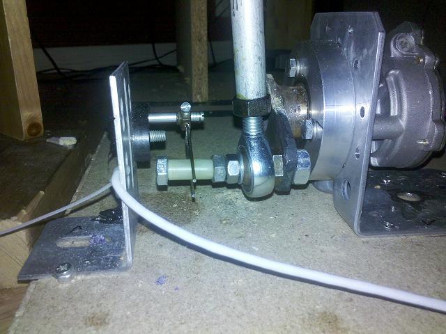

    I have decided to modify the motor and put a shaft to the back and attach the gear to the back shaft. Done that now, hope the epoxy will be strong enough to hold the back shaft well in place and also the drilling that I made don't make the front shaft weak to the point to break. Waiting the epoxy to cure and tomorrow I will know if it woks well. I will post the results after test it.

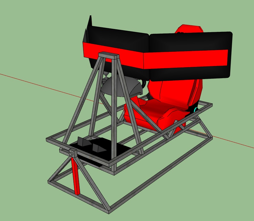

    Hello. I like the look of the motors your using. Do they have metal gears inside that casing looks very big and beefy. What motors are those? I'm going to try and move this :

    Thats really great Kubing. What motor did you use? Im nervous about just going out and just grabbing any old wiper motor I would like to start from charted territory in the motor department. What controller would you recommend?

    no problem...Daihatsu mira motor. i use my own controller.

    Mine is a Honda Civic motor but old model. I don't know if its that great of motor. Its plastic gear inside but this is not the problem. Here are the things I don't like about them:
    1. Difficult to mount as the mount brackets are not even.
    2. If you apply a bit of force you can move it by hand when its turned-off. When its on and I have someone on the seat, if applying 50% power it can spin because the weight applied on it.
    3. The back is not flush clean, it has a bracket to connect the cable so It isn't easy to drill to add a back shaft
    4. Very difficult to isolate the ground from the casing.
    I would suggest you to go with a Passat/Golf motor or something stronger like a van or SUV motor.
