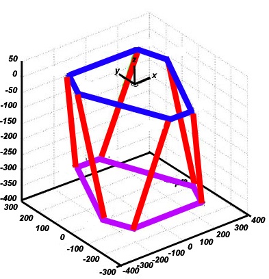

  12. Segriv
    Segriv New Member
    Oct 22, 2011
    0Coins
    hi! Could you show the original data in the picture? Thank you.
    .jpg
  13. velusamy.subbarayalu
    velusamy.subbarayalu New Member
    Dec 30, 2011
    0Coins
    Hi...
    I'm a Newbie to the 6Dof model...
    I'm planning to implement a 6DOF Model using stewart platform
    I have managed to read the data from software simulator model using MATLAB.
    I would be really glad if any one one of you could suggest some method or a procedure from which i can get a clear idea of how to convert the orientation to Lengths of the the Linear Actuators...
    Thanks in Advance
    And Advance New year wishes.. :)
  14. Ashraf
    Ashraf Member
    Nov 8, 2013
    66
    1,034Coins
    +65 / 0 / -0
    3DOF, Arduino, Motion platform, 6DOF
    - I have access to the hydraulic components..., now in stock I have 6 cylinders, size 850mm (closed) plus + 630mm (stroke) I flashed a crazy little idea to make Stewart platform;), theoretically make such a platform is not difficult, 2-steel constructions, the 6-cylinder, 12- active joint located 120 degrees relative to each other.
    - the fact is that I do not use AutoCAD or Matlab, if someone who use this programs, can help calculate the optimal location points for this size of hydraulic cylinders, I will be very grateful :cheers
    Thank you.
