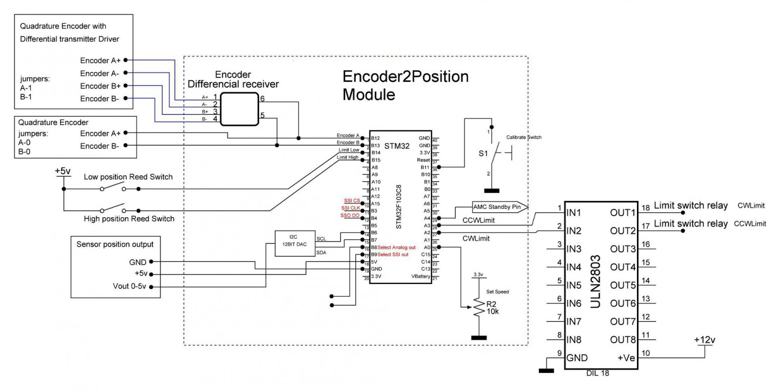

    ok i suggest you mod the smc3 code to use encoders instead of pots
    it might be easier than you think
    alternatively - use a board that counts pulses and converts to a voltage - put this board between the smc3 and the encoder
    its not a clean solution but it will prevent you missing pulses and loosing position - may be a better solution in the long run
    how many pulses per revolution and how many turns on the actuators on full movement

    Something like this:
    https://www.tindie.com/products/tronicgr/encoder2position-module/

    Yes, read the page, has limit switches, and instructs the motor controller to move automatically to the limits to calibrate for the range.
    Each one is for one encoder only...

    I tried rewriting the code in smc3, but I couldn’t make it work and it was hard to isolate the problem. Instead I put 3 2-channel DACs on the Mega. After some wrestling with that, yesterday I got the rig moving with smc3utils!

    Yeah, something like that. The mega counts all encoders and sends the position feedback to three completely standard smc3’s. It is not an excellent solution since it has no calibration feature. Nor do my actuators have end stop switches.
    Not sure how to walk around this, but as long as they start from zero and don’t lose count of steps, it works.
    Nice to have some room for improvement. ;)
    The DACs are mpu4812’s if I remember correctly.
    I have yet to try everything together. Only tested one pair of actuators. Might get some time to play with it tomorrow.

    May I ask how you made the calibration function? Set the feedback voltage to a high value and zeroed when limit switch kicked in?

    I eventually wrote my own calibration routine which worked ok.
    Got the three actuator pairs working good on their own but everything freaked out when plugged in together. Gave up and shoved it in a corner.
