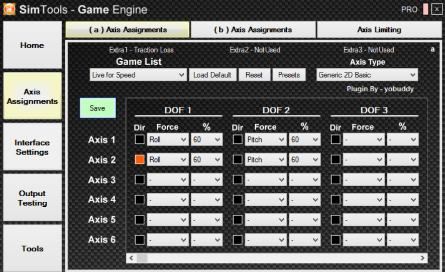

    I have a same problem. When i use simtool 1.3, i can receive 100% roll and pitch. but with the same code and setting in simtool 2, for roll and pitch more than 50% it mirrors result automatically!!! for a value likes 60% roll returns -60%?

    @COGO ,
    Please post pic's of your axis assignments so I can see what's going on buddy.

    here is my axis assignments. Foe values from -100% to 49% i have no problem. when i want to read more than 49% of each value. it returns wrong number( maybe my wrong read cycle!)

    I checked again today, everything is the same in both ver 1.3 and 2, but ver 2 results are different and wrong from 50% and more...

    The problem is solved with the kind and full support of Yobuddy with changing system local language.
