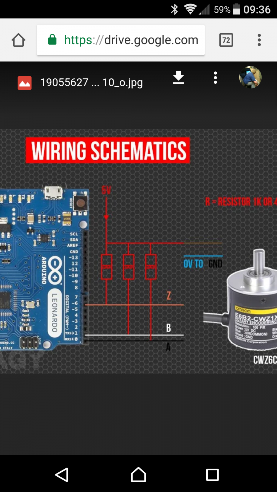

    Thanks again I'll try this out tomorrow if resistors don't work out do you know if the resistors are directional or can I install then anyway I'm gonna install as diagram

    Sorry can I install the resistors in circuit anyway round,
  9. Fernando Igor
    Fernando Igor Member
    Jul 24, 2017
    53
    Programmer
    Fortaleza, Brazil
    913Coins
    +19 / 0 / -0
    DC motor, Arduino
    Resistor has no polarity or sense.
    Follow the "Wiring schematic" image of the post above without worrying about the direction of the resistor.
  10. Vdub180
    Vdub180 Member
    Jan 20, 2016
    83
    England
    148Coins
    +15 / 1 / -0

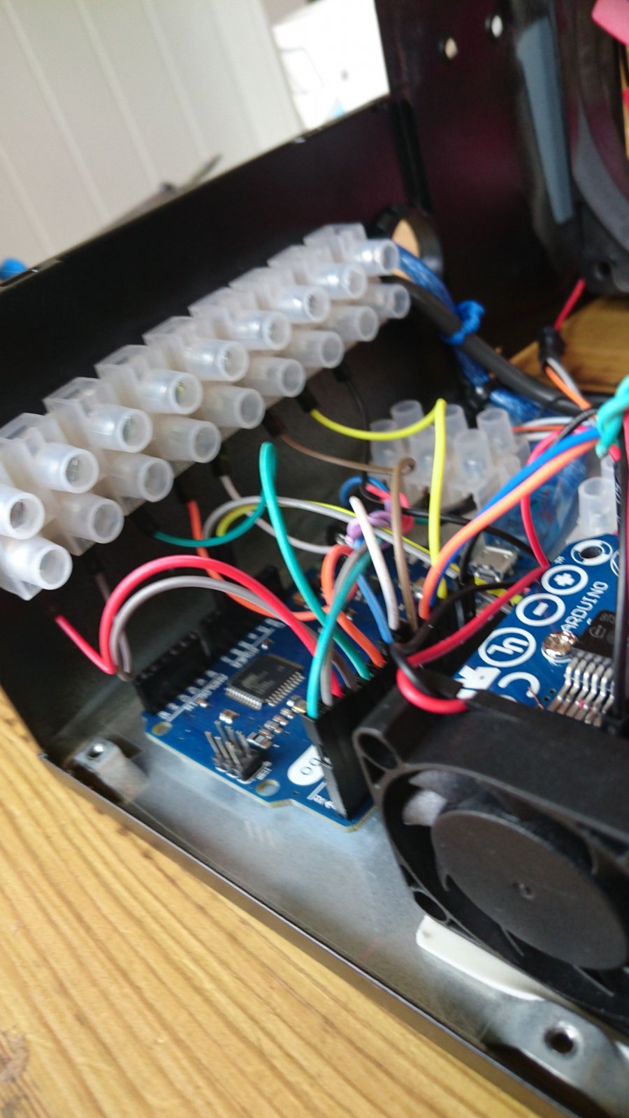

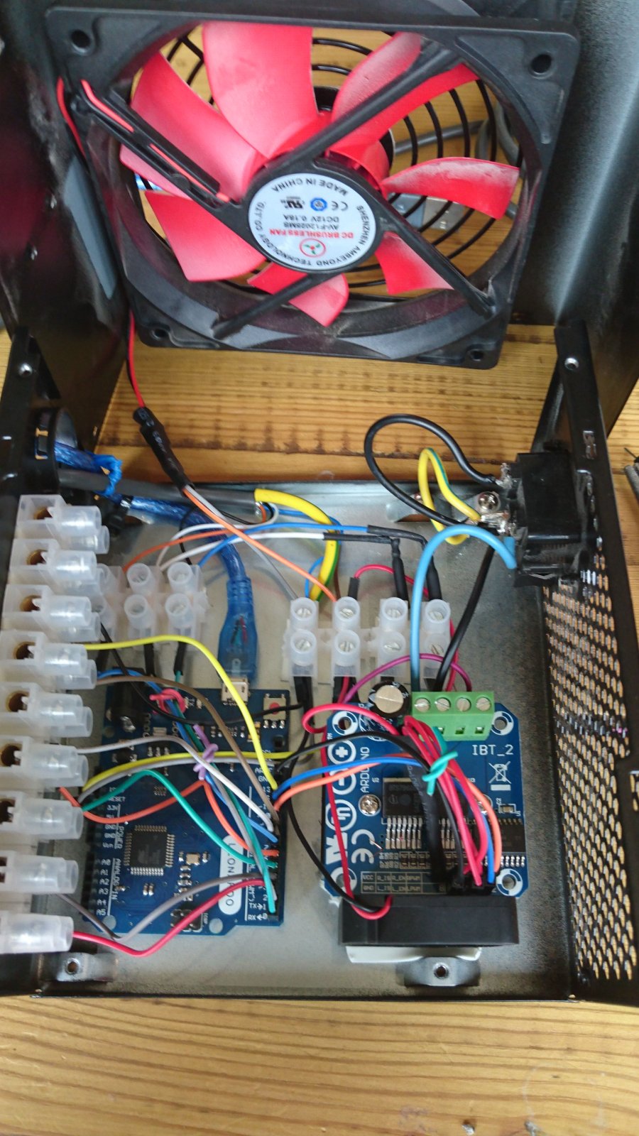

    Ok I have the encoder working now all I needed to do was add resistor and 5v to And B not Z, so as I disconnected the 5v and the resistor for Z it worked so far so good at the min thanks for your help so far
  11. Vdub180
    Vdub180 Member
    Jan 20, 2016
    83
    England
    148Coins
    +15 / 1 / -0
    Me so far
