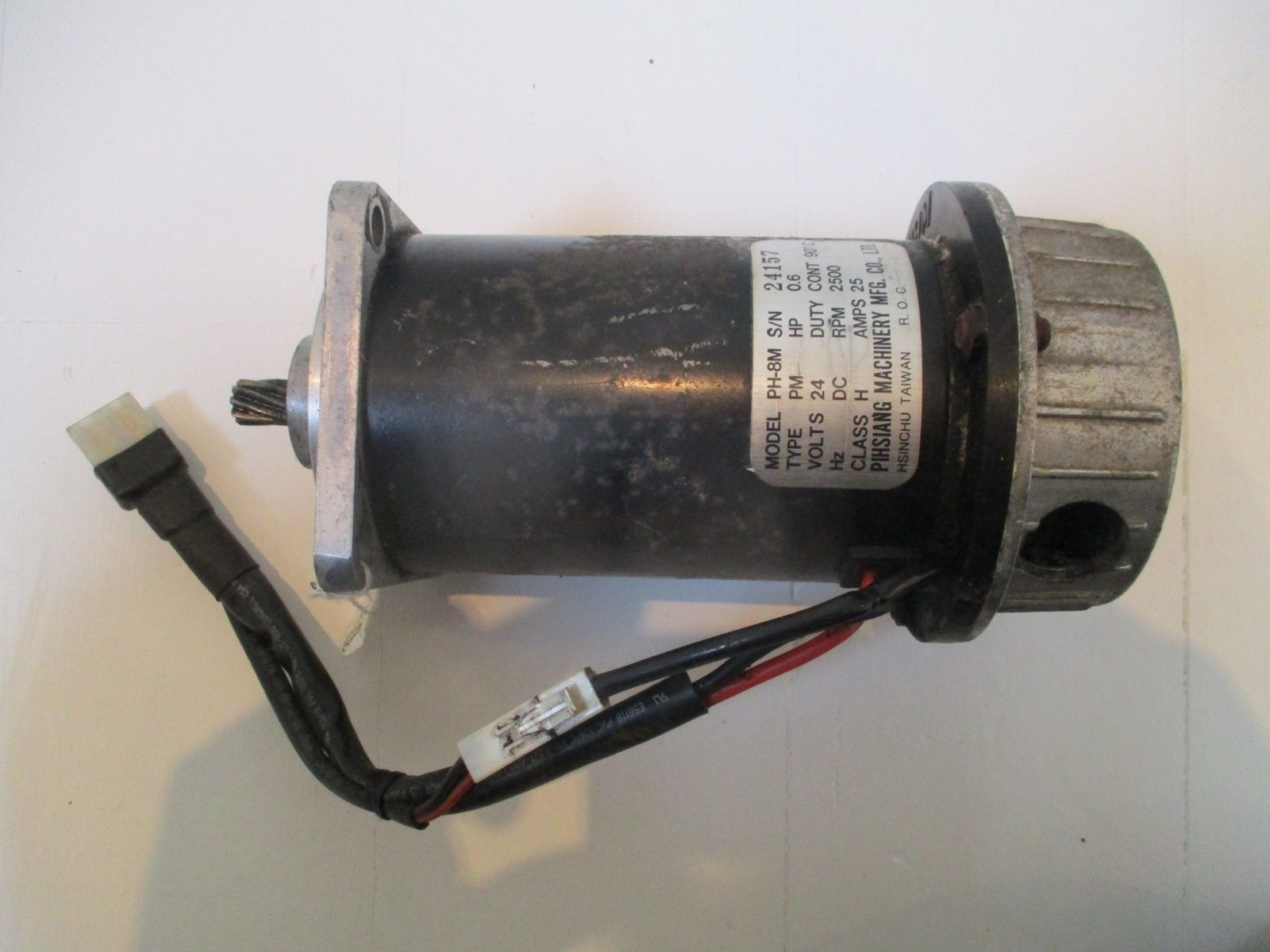

    Sorted now I had mixed up to of the wires off the arduino, all working now but have a new problem although the feedback works correctly it feels so week I'm running PH-8M motor off a scooter powered off 2 12v battery's connected in series to put out 24v, for some reason it only works at 4Mhz anything more and I have to reset the ibt 2 controller after a few seconds.

    What are the specs of the motor?

    Can't find any specs on the motor all I know is its 24v and its off a scooter the model is PH-8M

    That is a 0.6 hp motor at 25 amps so it has plenty of power.
    I would imagine you are overheating the ibt2 and it is shutting down.
    Turn ffb down to 50% and see if it takes longer to shut down.

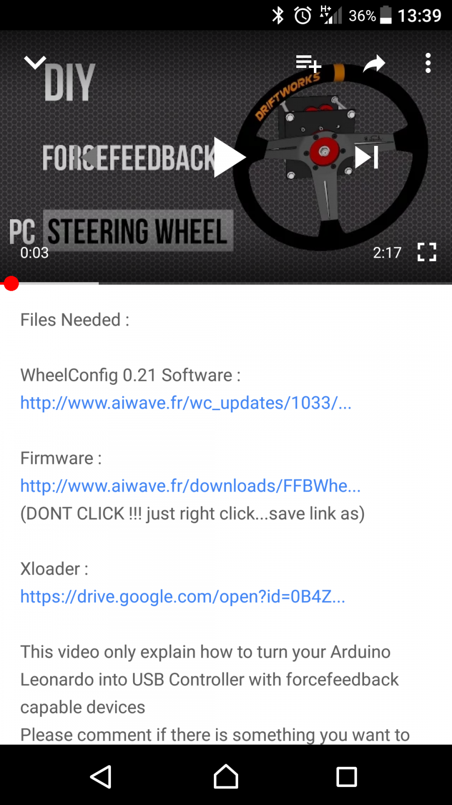

    Both directions trip, and I used the directions from the video including links for software

    Ok power of the motor is about the same through the ibt as it is stright on the battery 24v been double the strength of the 12v so look like I need a stronger motor can anybody recommend anything
