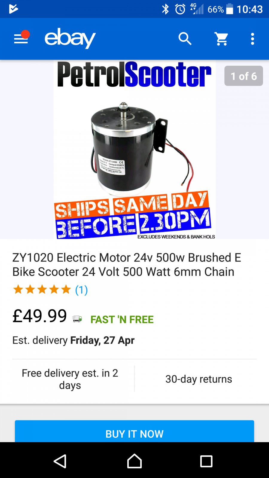

    Ok it looks like this badboy or have my eyes failed me

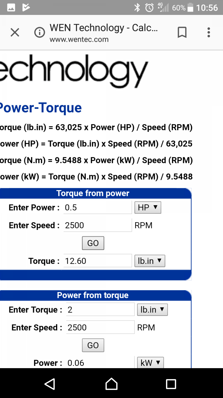

    This seems rather high

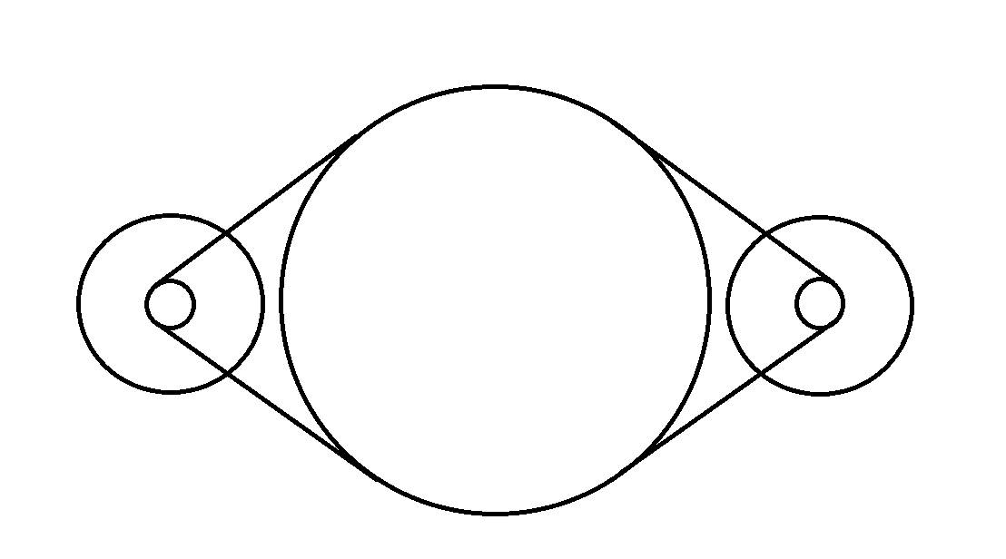

    I want to build a wheel and I have several doubts, I read the problem of the gear effect by the magnets, I want to put a ratio of 6: 1 with a 20mm strap, would that gear effect also be noticed?
    You have tested this engine and it has little gear, right?
    https://es.aliexpress.com/item/350w...0.html?spm=a2g0s.13010208.99999999.384.1U1wrP
    I would use this encoder 2500ppr
    https://es.aliexpress.com/item/E6B2...8.html?spm=a2g0s.13010208.99999999.262.lEp23H
    and two ibt2 in parallel, is there something that I have to rethink about my project?
    And using two 150w motors together would give more smoothness than a large 350w? Could they attack the same pulley with a single strap?

  6. Gadget999
    1,978
    12,072Coins
    +488 / 10 / -0
    I suggest you use a single 350w motor but as direct drive.
    If you dont like it buy another and go for a twin motor.
    The encoder and ibt2 are good parts

    I want a wheel with a lot of force so that it does not clipping ever, a 350w motor I do not think of enough strength and it will always be working at many amps, that engine is like yours? Does not have a gear effect?
    To use with a pulley, is an engine or two better? I think that with two the gears will not be noticed so much because they are smaller, the amperes will also be better distributed in two ibt2 than using two in parallel, if one takes longer than the other in opening the other will receive all the amperage of a large motor, is my theory maybe this is wrong
  10. Gadget999
    1,978
    12,072Coins
    +488 / 10 / -0
    I use a small diameter wheel so the torque is still quite high.
    You can always use 2 motors or a more powerful one.
    2 ibt2 is fine, one may work harder than the other but the overall effect will be the same
    Just get in and build the wheel, you can modify it later if you need to
