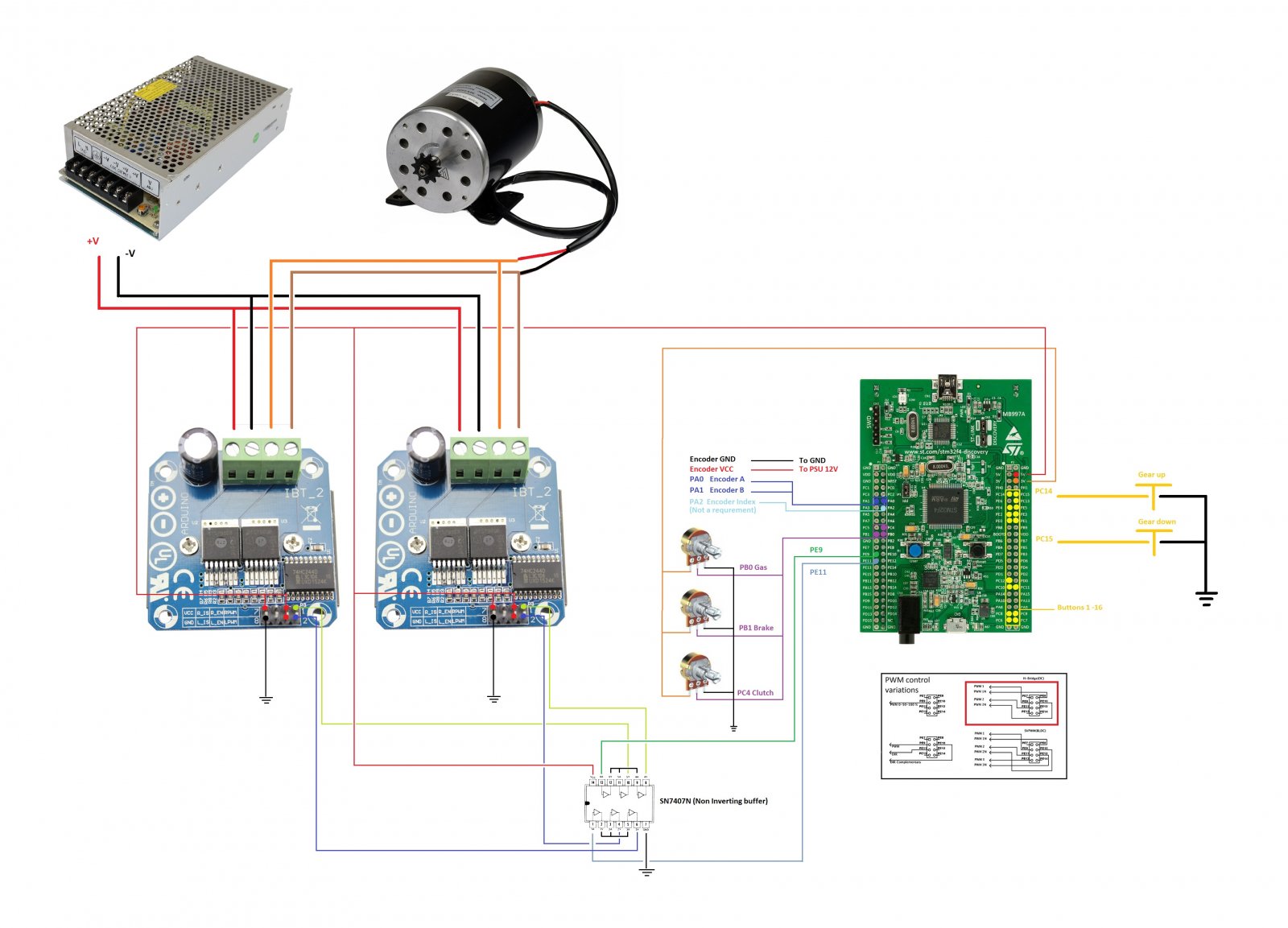

    As Promised:
    Download the attachment to view it in better detail.
    The added circuit is a non inverting buffer used to strengthen the PWM signal as the output drive of the STM32F is insufficient to split to 2 IBT_2 units.
    The unit is this: http://au.element14.com/texas-instr...fer-dip-14/dp/2119506?st=non inverting buffer
    Alternately, you can use a clock fan-out buffer however I have only seen these come in surface mount packages and thus harder to DIY connections.
    The way I have connected the buffer is to have the main PWM output from the STM32F connected the one of the buffer inputs. This is then fed to 2 more buffer inputs,
    splitting the signal to feed both of the IBT_2 drivers. When setting up the MMos utility you will need to select the "H-Bridge" output mode for this to work correctly.
    All of the "enable" pins are connected to 5v to keep them active.
    One suggestion is to also buy a small 5v supply to power the IBT_2 and Buffer Circuit as again, I doubt the ability of the STM32F 5v channel to power things properly as I have had issues in the past.
    As in the picture, it is better to connect 12V to the encoder as the 5V from the STM32F cannot drive the encoder properly.
    Depending on what encoder you order you may need pull-up resistors on the output of the encoder channels.
    You do not necessarily need to have an "home/Z/index" channel but the A/B channels are a must.
    For the buttons, you can pick whichever buttons for whatever function. What I have drawn is just an example.
    The buttons are active low, which means you just connect the pin to ground to activate the button. No voltage input required.
    You would do a wheel setup in whatever game you are playing and assign button functions.
    For the pedals and gear shifter, you can utilize pedals and shifters from Logitech units if you wish and re wire them to the STM32 or build your own.
    If you wish to re wire logitech pedals/shifters I can help there aswel.

  8. evolaco
    evolaco Member
    Sep 27, 2015
    264
    Spain
    694Coins
    +29 / 0 / -0
    Thank you so much great work friend!
    Just a doubt, to connect 3 ibt2 how would it be done? and the pins that are joined in black must be joined with cables or simply not use?
    Edit. Can I use this buffer? Is it connected the same?
    https://www.digikey.es/product-detail/es/texas-instruments/SN74LS244N/296-1653-5-ND/277299
    my power supply has output of 5v 2a, can I feed the stm32 and ibt2 with it?

    If you want to connect a third IBT_2 I'll have to modify the connection diagram. A second buffer may be needed but I think these should have enough drive to split the PWM signal.
    Use this buffer: https://www.digikey.es/product-detail/en/texas-instruments/SN7407N/296-1436-5-ND/277082
    The black lines are legs of the buffer that must be connected together.
    The 5V supply would only need to power the IBT_2 and the Buffer chip. STM32F gets power from the USB connections. Both USB cables must be plugged in.
    Yes that 5v supply would be more than sufficient.
    That encoder will need pull up resistors. I can also add this to the diagram.

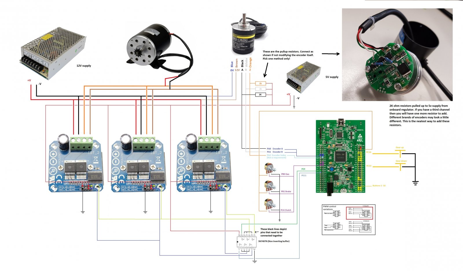

    of a leg of the buffer can not be fed two ibt2? or use two buffer? if you can add that to the diagram and the resistance of the encoder would be great, I am very grateful for your time and work
    The pullup resistors can be connected in two different ways. Either internal to the encoder as in the picture to the top right OR as shown in the diagram under the encoder. Pick one or the other.
    The diagram now also shows a separate 5v supply.

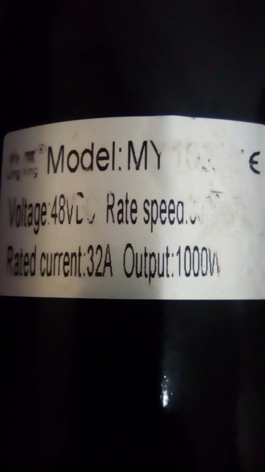

    IMG-20180817-WA0008.jpg I got the 48v 1000w motor but it says it's 32A, should not it be 26.7A?
    I have done a force test at 12v 82a and given 10NM, I can not measure the amps but if 3,2a are 26,7a I have used all the amps of the power supply.
    That's a stupid thing for a 48v engine, is not it? I will have to lower my strength in MMOS if I do not want to use so many amps? With 60A it would give more than 7nm that should be enough for a 32cm wheel

    It's not stupid at all. That's the reason why I tried to convince you before to choose a motor with high voltage. It has more winding and give you more Nm/A, and because you run the motor in "stall" mode all the time, it doesn't produce any back EMF. To make you understand EMF: When the motor starts to rotate, it's also a alternator that produces voltage that work against your input voltage.
    When you lower the ffb, try leave it at 100% in mmos (If your supply can support it), and lower it in the game to suite your demands. Otherwise, you surely will have "clipping" problem.
    How did you measure the torque?

    I would rarely trust the labels on these types of motor (cheap motors). You only really use them as a ballpark figure of the motors characteristics.
