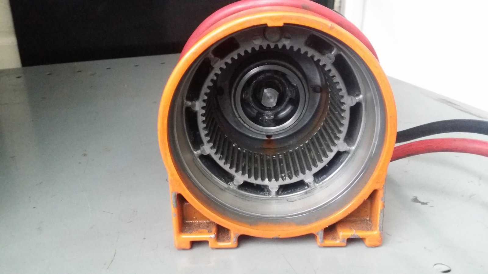

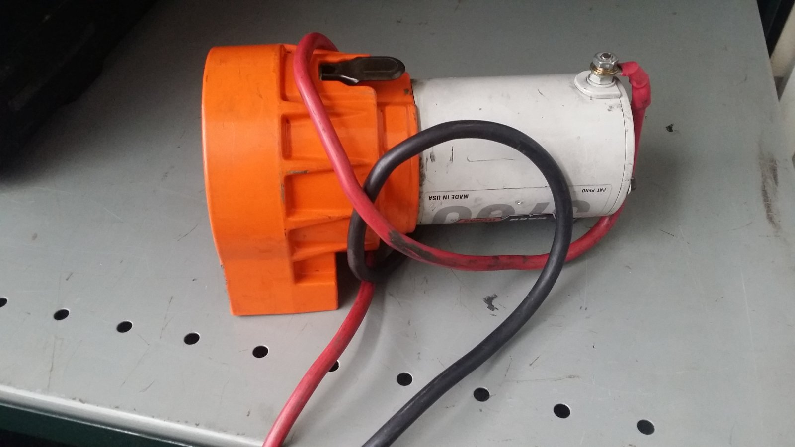

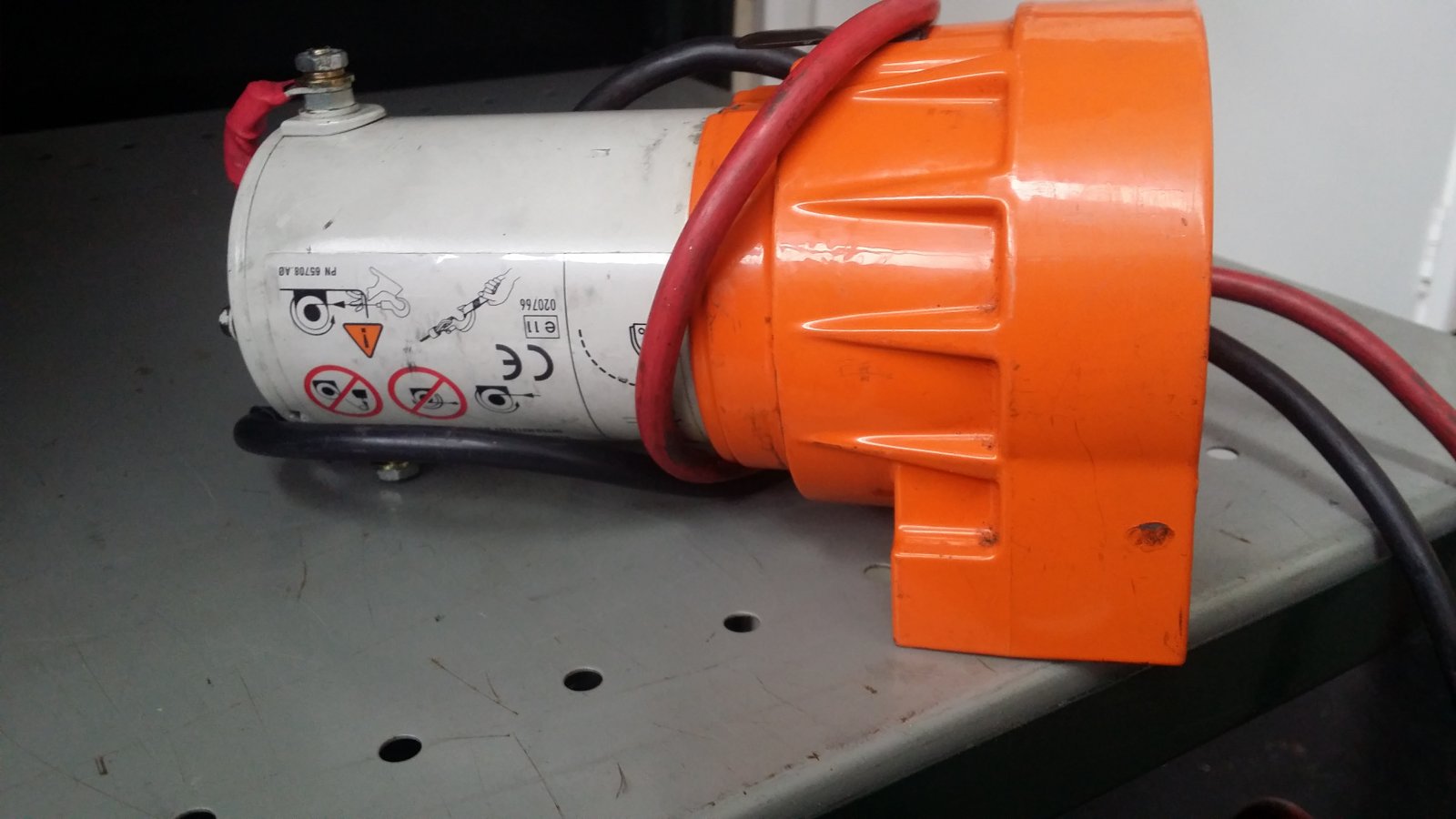

    Attached are some pics of an old winch motor i had lying about.
    This motor is 12v and well over 1kw !
    It is a bit stiff to turn the axle by hand, it was removed because it was worn out.
    It could be used as the basis of a DD wheel
    However i am slightly concerned it could rip someones thumbs off !
  12. SeatTime
    2,572
    Don't be concerned, most direct drive wheels are capable of breaking thumbs and dislocating wrists:).
