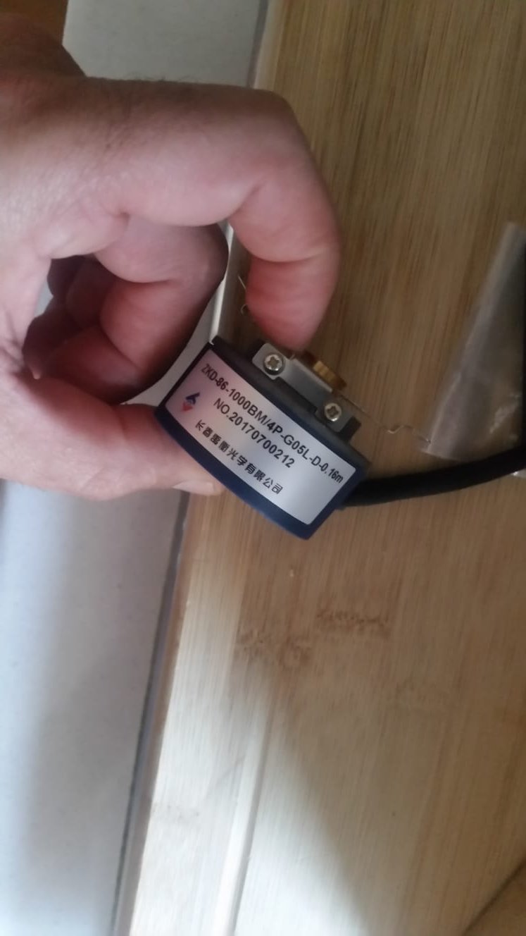

    In the end I will put 4 ibt2, I prefer to play it safe, use the two outputs of the buffer to feed 2 ibt2 each? or better to use two buffer?
    I have passed this photo of a 10000ppr mige encoder, I have not found anything for the reference, I still do not know if I can use that encoder, in the end I will have to buy the Chinese 2500ppr encoder ... IMG-20180819-WA0002.jpg
  4. Gadget999
    1,988
    12,132Coins
    +492 / 11 / -0
    Try the encoder and see what happens, it may be fine

    but not knowing what each cable is as I can locate encouragement and A B? These encoders have a + a- b + b- u v w ... nothing has been found even all the colors for

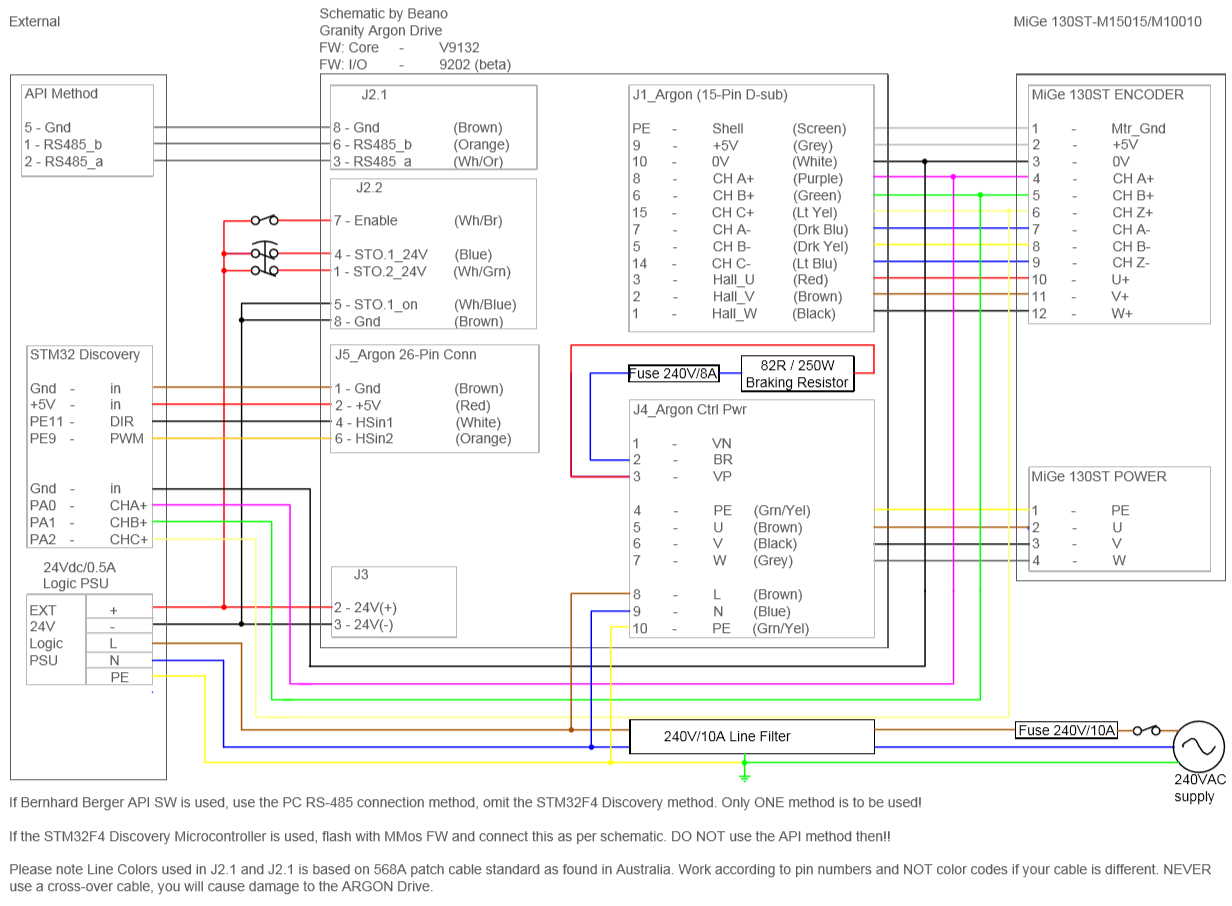

  10. Alexey
    Alexey Well-Known Member
    Sep 23, 2014
    452
    Electronics Technician
    Adelaide, Australia
    8,066Coins
    +623 / 2 / -0
    The Encoder should have a voltage regulator but to be safe connect the VCC of the encoder to 5v.
    This is why whenever you buy electronics, make sure there is a datasheet available!
    Yes, you should be able to feed all 4 of the IBT with the one buffer, if not buy a second buffer. Probably just easier to buy two buffers as they are cheap.
    To test your encoder connect as shown in the diagram to the STM32F board, use a+ and b+ channels on that encoder.
    Program the board with MMos.
    Start the MMos utility and ensure connection.
    Download Live for speed (small download, fast to load)
    In live for speed select MMos FFB as the input device.
    At the top of the screen will be a bar graph that will show wheel position. turn the steering wheel.
    If the encoder is wired correctly then you will see colour fill up the bar in the direction you are turning the wheel.
    If the direction is incorrect close LFS and click on the reverse encoder input. (NOTE: the motor may spin the wrong way, change the polarity of the motor OR re wire the encoder a/b channel and un-tick the reverse encoder option).
    The encoders u/v/w channels are used for communications so don't use them.
    The STM32F doesnt mind having 5v into the encoder channels, If you have concerns however connect the pullup resistors to the 3.3V output from the STM32F board.

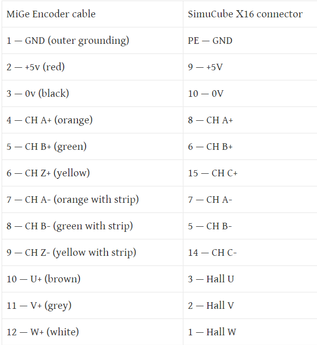

    Can I do the test in the game without a motor? Simply the encoder connected to the discovery and turn it by hand, I suppose so.
    Here is a picture of the connection of an OSW, the encoder goes to the STM32 without resistors and connected to 5V, to the STM32 goes the 0v to the GND and A +, B +, Z + to the ABC channels, the Z is not necessary according to you told me.
    To the stm32 it is necessary to connect the GND of the power supply? Or is not it necessary? When encoder I carry GND from the power supply to 0V
    Following that scheme should go well.
    I also found the colors of the encoder, in theory they should be the same as in the encoder I want to buy.
