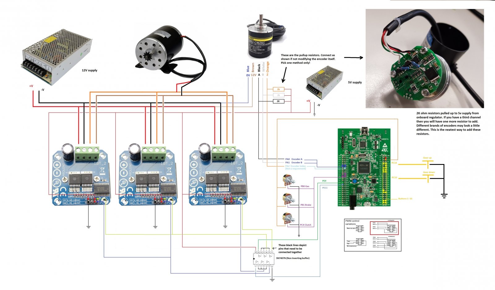

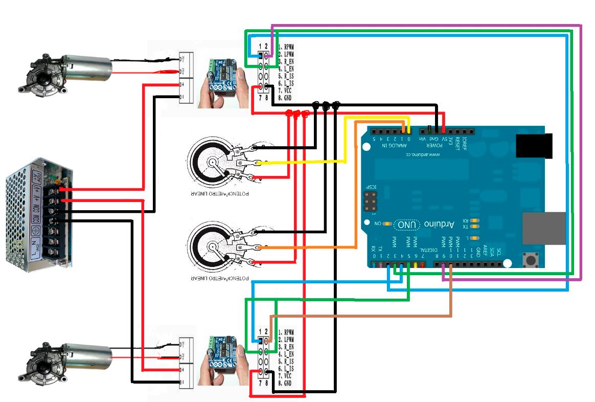

    One question, the battery should not connect to the reverse? negative next to the capacitor and then the positive? In smc3 it is connected like this and you have first put the positive one next to the capacitor Wiring-2-Motors.jpg
  2. Gadget999
    1,988
    12,132Coins
    +492 / 11 / -0
    that diagram is for the smc3 and 2 motors
    this discussion is about the 'Cousin of Open Sim Wheel'
    please keep the post relevant to the discussion

    I am using the smc3 schema example, the scheme of the steering wheel has the input of the power supply to the ibt2 the reverse, they have put v + where v-, the polarity is reversed

    ok - i see what you mean
    you can reverse the direction of the wheel in the software if you need to

    Good Spot, Serves me right for copying another diagram. Yes the negative connection for the VCC is closest to the capacitor.
    This is obvious when you flip over the IBT_2 as it has polarity markings. Do not connect in reverse. You can certainly connect the motor output in reverse but not VCC.
    First try your connections with only one IBT_2 without the buffers. The MMos utility must also be selected as "H-Bridge" mode for the output.

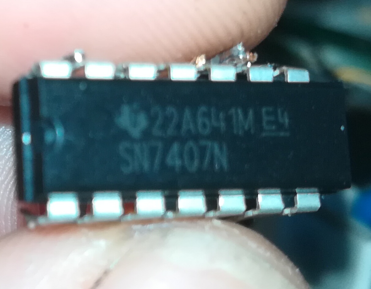

    what is the part number of the buffers that you have?
  9. evolaco

    SN7407N

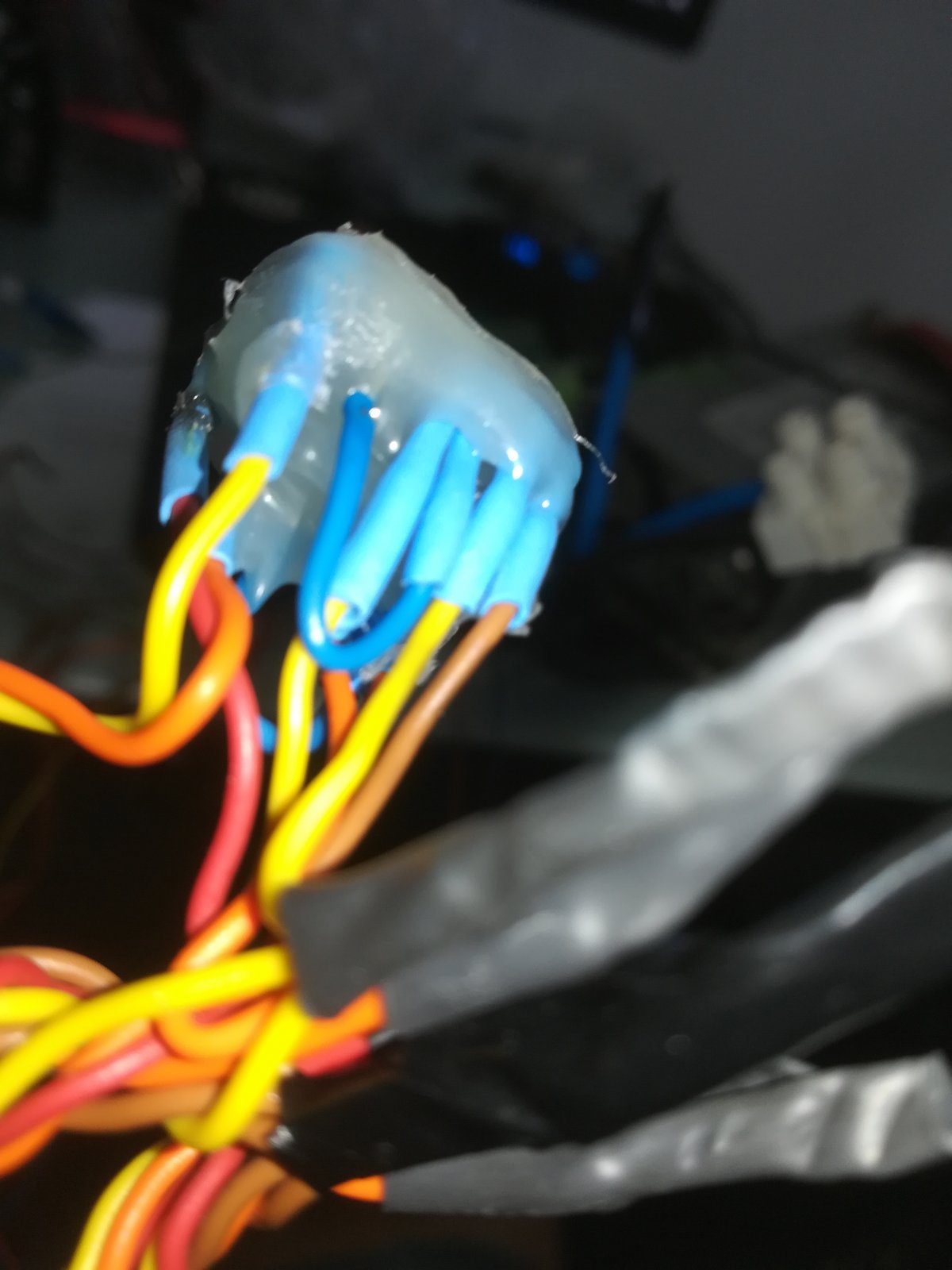

    I have tido sealed with silicone, I have reviewed the scheme and it is the same one that you put, this each cable in its place, I put a picture of one of the chip on top, use a buffer for the 4 ibt2, but in the silo test connect one of them, the other three connectors were not connected.
    The scheme would be like yours for three ibt2 but enpalmando pin 8 and 4 to the fourth ibt2

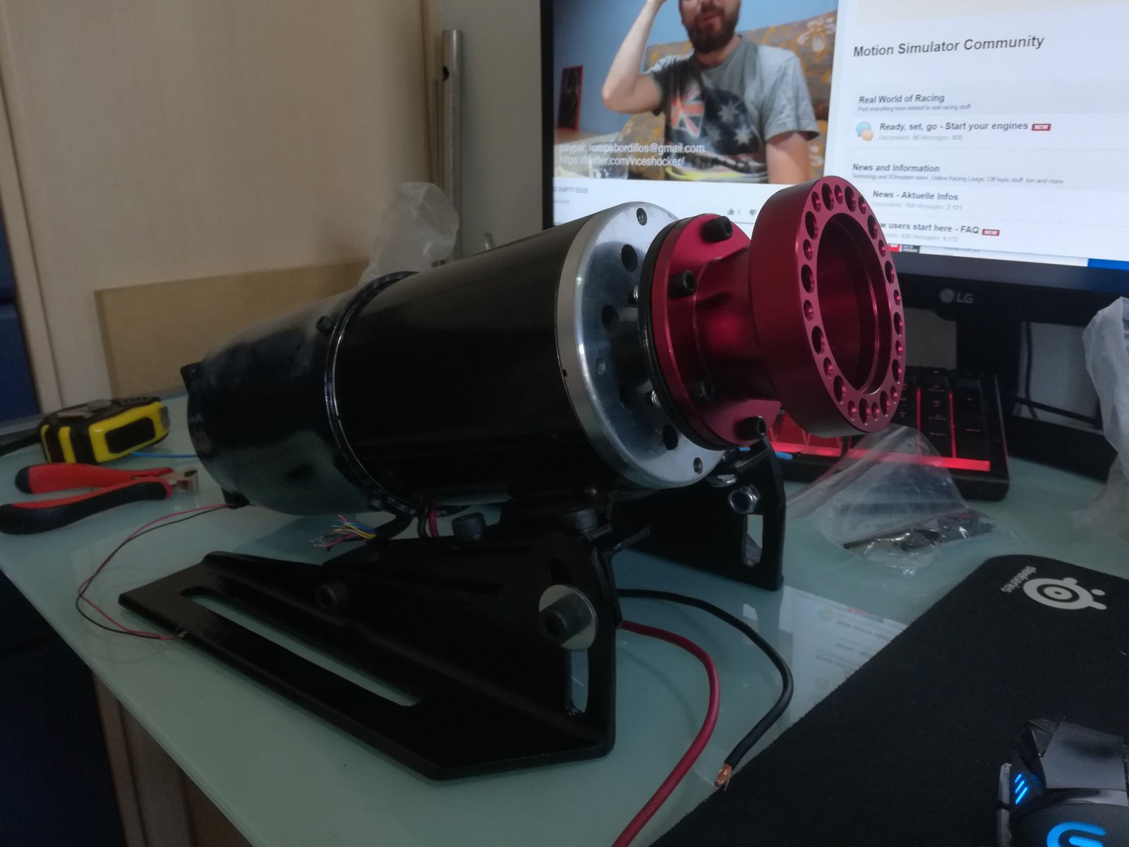

    I tried a direct iby2 and it works, but listen to the noise made by the engine, like a squeak, I have it at 16kz, there is no option, why does this happen?
    Forget the chirping, raising damper to 25% is completely removed.
    I have made measurements and blocking the motor to the maximum of degrees only mark 5V, I notice it loose, like 3-4nm, the stm32 takes out by p9 and p11 3V maximum, the ibt2 needs 5V to give 100% voltage, the buffer is the In charge of converting the signal from 3v to 5v? Now I have 100% mmos and I can play with an ibt2 without stopping and with the steering wheel without anchoring and on top of a glass table, something fails in all this ..
    edit: I tested without a motor and when it reaches the steering lock if it gives the 12v, with the motor in lock has given 5v can it be a faulty ibt2? I have tried another one and it has reached 6v but far from the source 12.8v, is its way to cut because it passes its amps? Never take an ibt2 to the limit, I do not know how to protect
    I have tried the other two ibt2 and one has reached only 4.8v and the other to a staggering 9.5v, I think it is the cut by amps of each, some will not even reach 30A and one may exceed 50A? The power supply provides 82a.
    When I put the 4 ibt2 in parallel, will they provide the maximum amps?
    You as tenenis the ibt2 in parallel? Directly or using a buffer? I have put a buffer but it does not work for me, I do not know what can fail.

    With the buffer it is best to test a single channel at a time without siliconing anything in place. The buffers are very simple devices, it just spits out whatever you put into it. Its purpose is just to strengthen the signal. It is best that you buy a prototyping PCB similar to these:

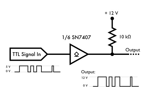

    Facepalm.... I've given you the part number of an open collector buffer....
    As in the picture the outputs require a pullup resistor, however you would want 5v for the pullup resistor (not 12V as shown) and a resistor value of between 1k and 5k.

    I'm sorry to give so much to you, my office is a bricklayer and all this costs me a lot, I think I do too much for my limited knowledge ..
    So in the open collector buffer should I have put 1k resistors in the outputs? I did not know, I did not know it...
    The NB3L553DG do not need any resistance? In one connects PE9 in the input and has 4 outputs for the 4 ibt2 and the other I connect to PE11 truth?
    PE9 - EO , Q0,1,2,3 - IBT2 ´s ??

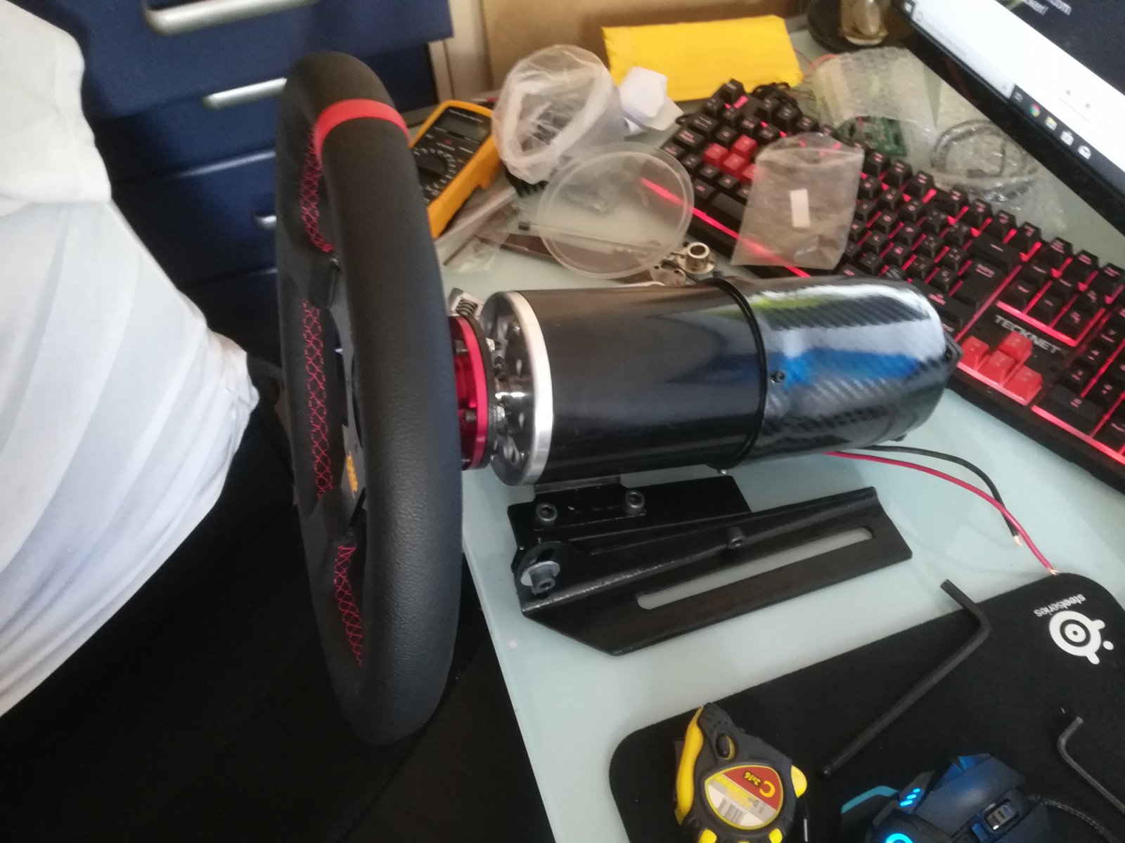

    Now it works with the 4 directly, but they deliver 1v less than the source, I got 8.5nm of the 10nm of the motor directly to the source, I do not know if that was solved with the buffer, maybe there are other problems for not putting the buffer Until I put it on, I will not detect it ..
