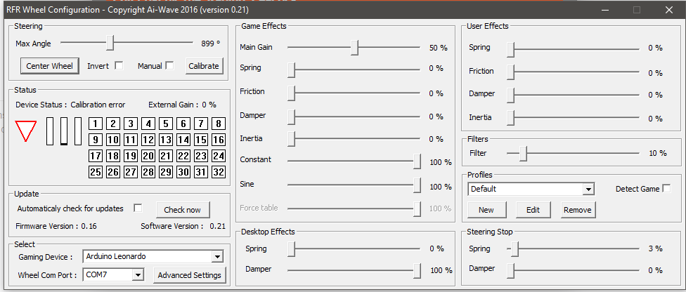

    Took a screenshot of my wheelconfig. I do use lut gen for deadzone correction... It rotates well ibt is powered on but when i plug in arduino it gets harder to turn. Thanks for the ideas guys :) I think going DD will be one of last options because there is a lot to change

    Perhaps give a 12v power supply a go? You might find that it gives a good tradeoff between constant force and FFB effects.

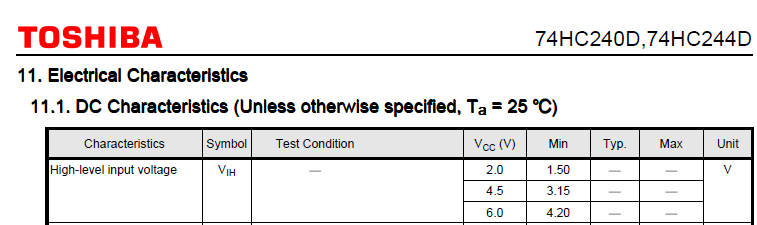

    So, after a closer look at the datasheet I can see the problem.
    The 74HC244D requires a 'high' input signal of about 3.5v when running at 5v. It's hard to tell exactly but look at the table below. So using the STM32 @ 3.3v signalling puts it 'out of spec' or at least close to the margin for 5v Vcc and is probably what was causing your problems. Longer and/or thinner gauge wires will make it worse again, as will having slightly higher than 5v going to them.
    In theory, running the IBT_2 modules at 3v will resolve this problem when paired with the STM32.
