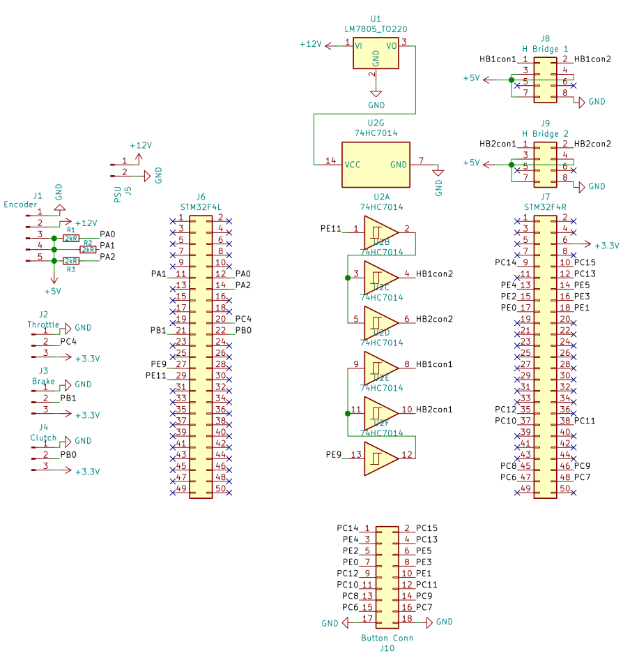

    Can we use LM7805 voltage regulator instead of separate 5VDC PSU to power up the h-bridges and SN7404 buffer ?
  10. Gadget999
    2,023
    12,355Coins
    +497 / 11 / -0
    Yes or use 5v from the stm32

    Hello, today I'd like to ask you to check if my KiCad schematic is correct. If so, I'll design connector board PCB with female pin headers to plug STM directly into that board.

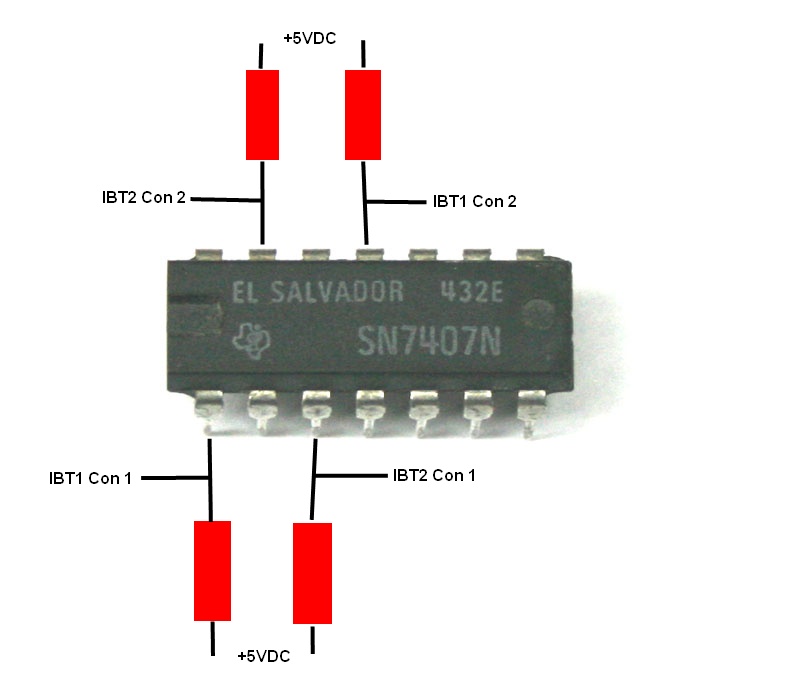

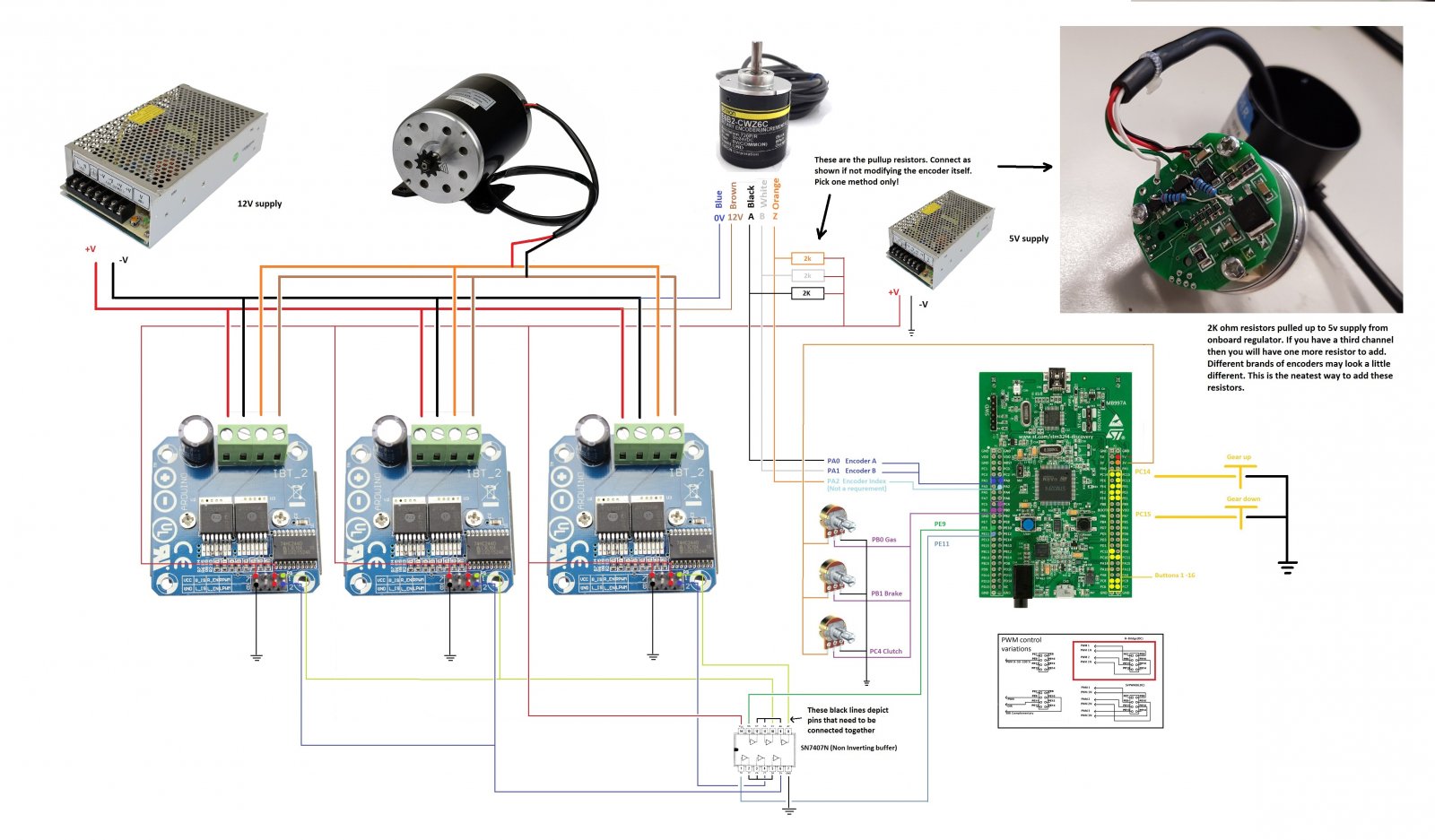

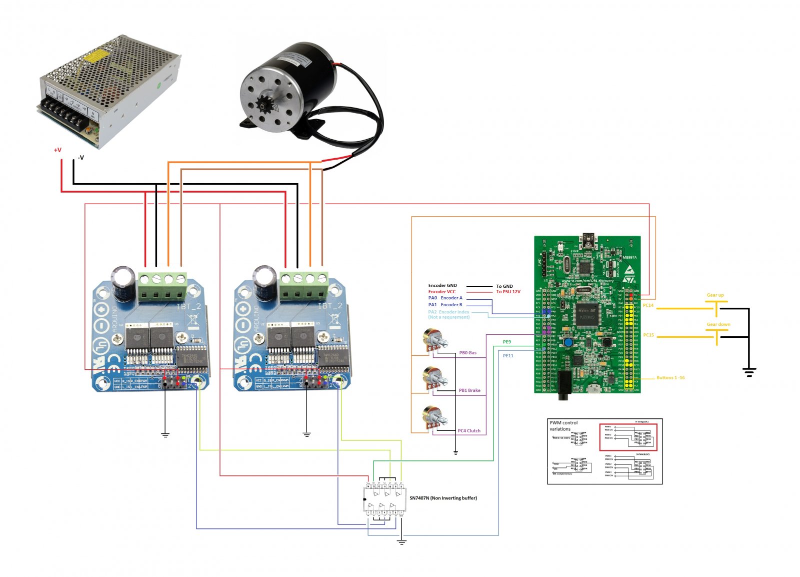

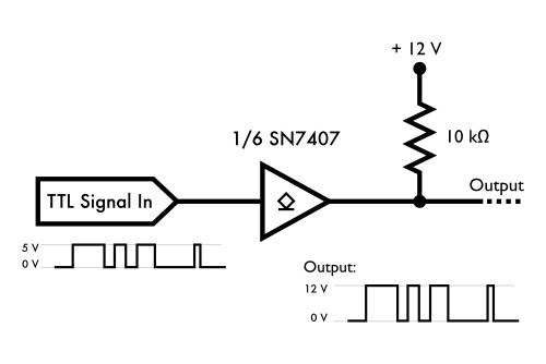

    Hi, as PCB design is almost finished, I would like to ask for SN7407 buffer/pull-up resistors to IBT connections. Please see the picture and correct me, if there is something wrong:
  18. danove_b
    danove_b Active Member
    Nov 11, 2017
    209
    Sweden
    1,782Coins
    +80 / 3 / -0
    I have 3 IBT-2 in parallel connected to the same kind of chip with no problem, so you shouldn't need any buffers. Have you tried both IBT:s separately so you are sure that they both are ok?

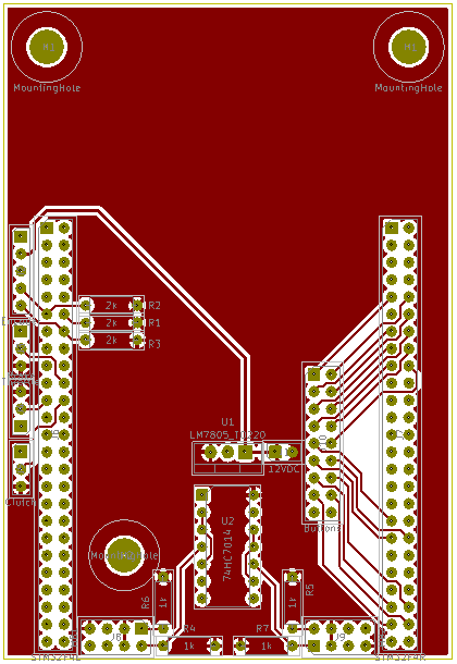

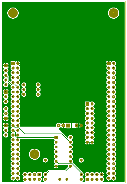

    Hi, here is a preview of both sides of the PCB. As you can see I use LM7805 as a 5VDC power source and all pull-up resistors (R1...R7) are optional. The board is designed to drive 2 IBT's.
    As I read earlier that some IBT2 may come faulty already I've ordered four of them ;)
    Copper on red side is +5VDC and green is GND.
