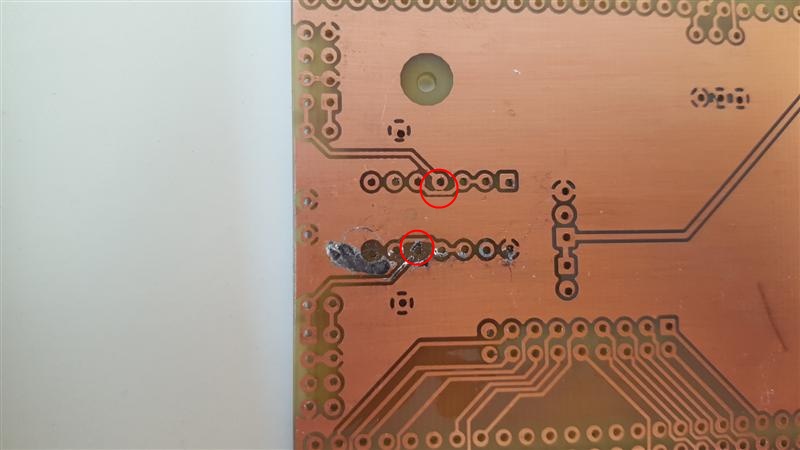

    Hi, AFAIK you'll need 2 kΩ 0,5-0,6W metal film resistor THT type.
    Btw.my first attepmt to solder PCB connector board was unsuccesful. Soon I've found the design flaw- one of the wires was runnig too close to SN7407 pads so there was a short :
    I've redesigned the PCB wires distance and also added pin connections for 2xMCP23S17 serial iterface.
    As soon as I confirm that PCB works fine I'll upload pdf and gerber files ;)
