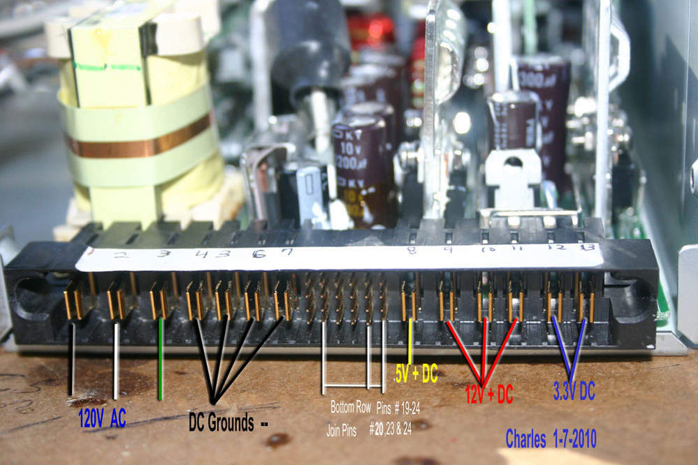

    What psu specs would you recommend? What is the minimum? I know generally people go with 12v psus, it's just the wattage and amps I'm not sure about. I know the OP is currently using a 900+w psu, but those are quite expensive here and I can't find any of them second hand. I was wondering if 360w would be enough?

    360w is unlikely to be enough on a dd wheel. If you havecit geared then maybe. However, if it is a pc power supply then be cautious. They generally need some load symmetry and will be unable to supply stated current without drawing from other rails.
    Just look for a server power supply. HP are my choice as they are powerful, quiet, plentiful, cheap and easy to mod. But most hot-plug style ones are usable and have extremely high current raitings.

    If I were to go the server psu route, how much wattage would you recommend? 800w? 1000w? These are roughly rm180-200+, which roughly translates to 44-49usd

    I would not trust them. chances are (like any stuff that comes out of china) they will not perform reliably at the stated power. I have had similar ones catch on fire when used at 60% of rated output. I just wouldnt.
    What motor are you looking at running? What is its rating/stall current?

    i'm using my1020, and haven't had any issues so far.
    1) it's a bit heavy, so i have it placed off my rig
    2) it's a bit loud, but according to some websites, it's quieter than other server Psu's
    3) it's pretty cheap
