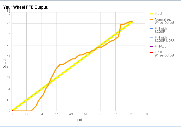

    i downloaded wheelcheck and ran some of the tests - is there a way to save the output - or do you want to see a video ?
    some of the tests are quite violent !
  5. Gadget999
    2,020
    12,331Coins
    +497 / 11 / -0
    ok i worked out how to find the log files i will turn them into a chart later
    the pid settings were P 5, I 0, D 0.25
    bigger settings made the wheel act differently

    Use this google sheet (don't change anything in the wheelCheck window):
    http://forum.projectcarsgame.com/sh...eel-FFB-Values-Google-Sheet-amp-FCM-Universal
    The test really showed one of the G27 biggest weakness: It doesn't start to react before 18% signal!

    Hopefully I will have a working wheel before the end of this year, still waiting for the parts to arrive. I will present the result from the wheelcheck, which I suspect will be a bit nonlinear. If so, I already have an idea of how to fix this with a additional microcontroller between the Leonardo and the driver card. Just measure the length of the pwm pulse and use a lookup-table and some interpolation and send out a new pmw with the result. (Should be very easy to fix if we had the source code of the Aiwave...). I have no doubt that it will outmatch my G27. Even if I'm aiming for less than half the rated current, I think the heating is the big question mark, the motor will work in "stall" mode all the time.... Gadget999: Have you tried to fill out the google sheet I linked to before?

    yes i have filled out the spreadsheet - but dont know how to upload it to this site
    send me a pm with your email and i will forward it over
    the output has a lag at the start - but its pretty good. not surprising you cant get movement without a minimum about of power
    there are tips how to alter the output to make it linear - i have not had a chance to investigate yet

    spreadsheet attached - need to work out how to apply the tuning to get a linear response

    I think you should change your rotation to at least 400 degree. It looks like the wheel reach its end already at 50 % signal.
