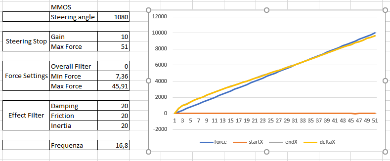

    Hi guys, due to quarantine i've had some spare time to mess with my wheel settings and i've found that its linearity at full force is terrible, the only way to get some good results is to use it at half power but then it's too light (i think around 2Nm). BTW i've got a LY1020, 48V 800W with a 12V 50A PSU but i measured a maximum absorbed current of around 30A, so i guess the motor resistance is too high for 12V.
    It's easier and cheaper for me to get a new motor, i've seen a couple of MY1020 36V at 60€, an 800W model with a mounting plate and a 1000W one without it. I'd rather buy the one with the plate for an easier installation. Do you think there's any difference between these two? I always read that specs for these motors are often pretty much made up.
    Thanks!

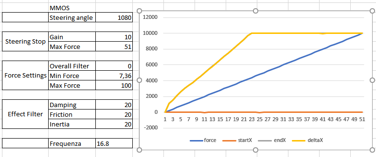

    As i said i tested mine during this period and i noticed something similar, lowering the maximum force gave me way better results in terms of linearity but it's too weak.
    As you can see lowering the maximum force seems to reduce the % at which the motor is giving his maximum force.
    Motor is a LY1020 48V 800W, with around 30A 12V input, tests done with Wheelcheck with 100 steps.

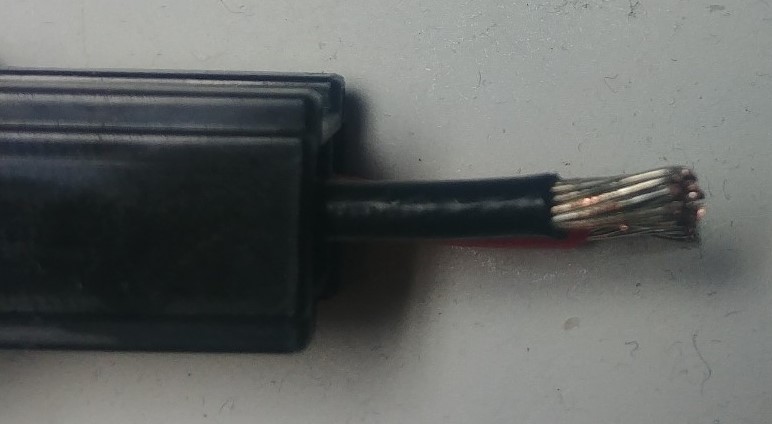

    I'm putting it all together now and idk how to attach the my1020 to the 3 ibts in parallel. I've been reading that the leads of a motor are typically coated with a varnish that makes a bad connection if crimped or soldered to. Is that the case for the my1020?

    Youre not connecting them to the windings of the motor directly, just the normal wires exiting the motor.
    basically each +/- from ibt out join togeter and go to the corresponding motor wires. same for the power in. plenty of diagrams here. What board are you using?

    Thanks for your reply. So are you saying that the wires aren't coated with any varnish and I can crimp to them and get a good connection? I attached a picture of the wire so you can see.
    I think I could have worded my earlier post better. I understand the wiring diagram; My problem is with physically attaching the wire.

    oh, yeah thats fine - they are tinned. i would highly recommend solder over crimp however. A bad connection is going to generate heat and when we are talking about these sorts of current its more important you have a very good connection

    Thanks for your reply. I thought that they were tinned too but that is the section that I stripped so it was under the sheathing. Why would they tin wire under the sheathing? I thought tinning was to make it easier for people to solder to it.

    It helps with preventing corrosion of the copper.

    I know it is a bit late but the solder on the wire is from the previous soldered connection.
    Capillary action will draw solder in to the wire even if it is still coated with pvc, it all depends on how much flux and heat is applied to the joint.

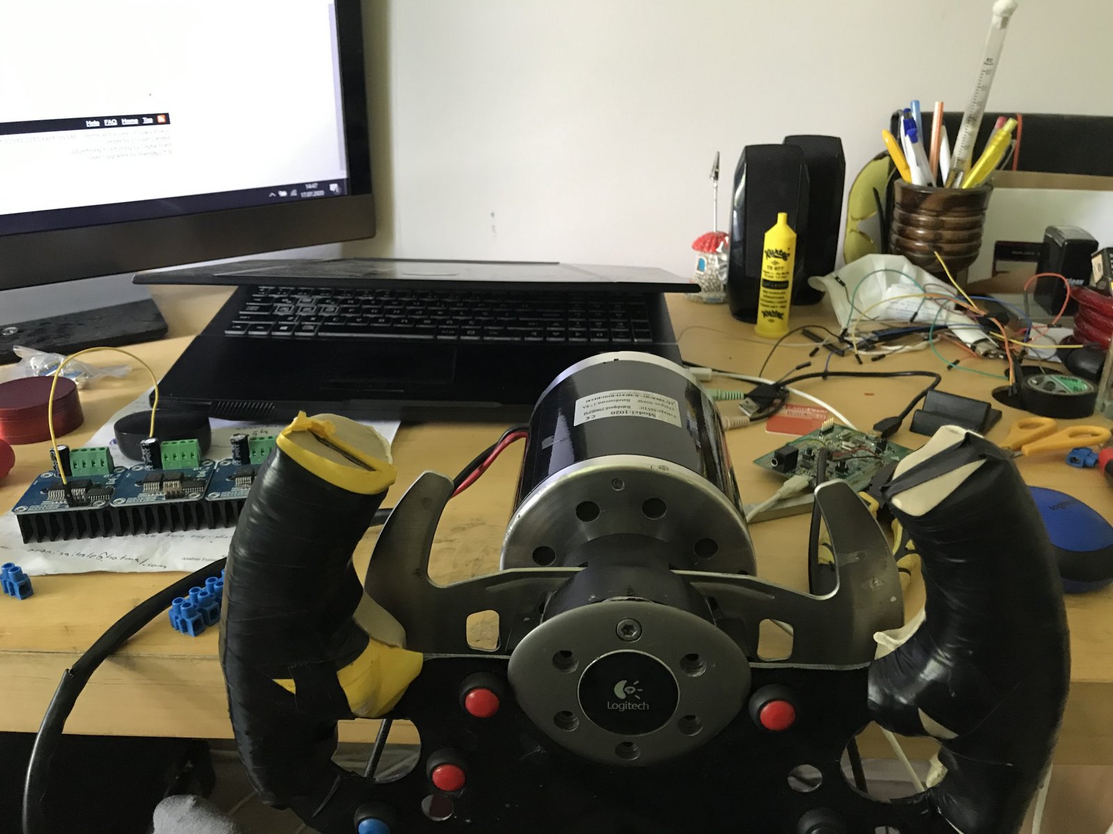

  20. Fatih M.
    Fatih M. New Member
    Jul 1, 2020
    17
    210Coins
    +8 / 0 / -0
    DC motor
    Hi again. i am very close to completing the project. Here some pictures. But i have a question for you @Gadget999 . in the connection scheme PWM signals on PE8-PE9-PE10-PE11-PE12-PE13 on Stm32. But have 2 pwm cable from ibt slot 1 and slot 2. Which output should I connect on stm? And how should I make the ibt2 serial connections? I will be very glad if you help me about that 2 problems.
