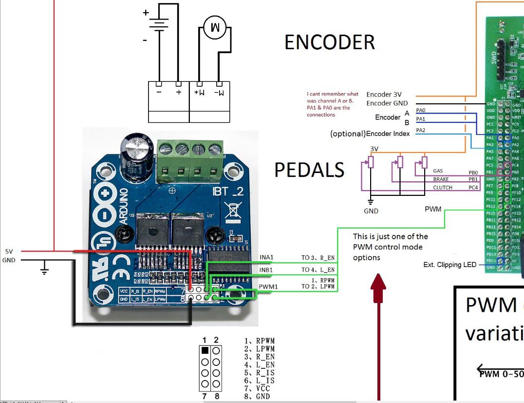

    Good morning to all guys, following this thread I came to the conclusion of purchasing these materials to make my DIY steering wheel which I list below:
    Encoder: E6B2-CWZ1X 2000P/R
    Engine: MY1020 48V 2800 RPM- 1000W
    Control sheet: STM32F407G Discovery
    N ° 3 : BTS6970
    12v 100A power supply: https://www.ebay.it/itm/1PCS-PS-211...itching-Power-Supply-54-ZX/153592904789?hash= item23c2d9bc55: g: cWwAAOSweXddSV7g
    From what I could understand, the best solution would be the one with the Stm32f407 Discovery board with MMOS firmware + 1000W motor + 3 ibt2 + 12v power supply at least 80A + encoder: OMROM E6B2- CWZ1X 2000P / R and rightly so?
    Another question: I can't understand how to connect Stm32f407 Discovery, encoder and ibt2. Having no skills on the subject, I wanted to know politely if there is an electrical diagram that can be followed to make the connections.
    I apologize in advance if it has already been said somewhere. Thank you

    if you check MMOS 2014 folder > Connections. There are a lot of schematics. And i add a pic.
    I am currently at the stage of finishing the project. But I'm having problems with the ibt-2 connection. When I try to turn the steering wheel to the left in Pwm & Dir mode, the engine starts to vibrate. If I choose Pwm & HBridge, the steering is working properly but there is no ffb

    Thanks for the wiring diagram
    Sorry I have another question, the stm32 to make it work I have to connect both USB?

    yes you have to use 2 usb cable for make it work

    I finally managed to run it. The problem was fixed when I selected Pwm & Hbridge option on Mmos 2014 and when max force = 100%. Rpwm : PE9, LPwm : PE11, ReN, LeN and Vcc to 5V, Gnd to Gnd.
    I currently use it with a single power supply and I am very pleased with it. Much stronger and much more detailed than the G25. The engine warmed up after using it for 30 minutes but it was resolved when it was cooled by a 7cm fan, ibt also warmed up, so I have to add a fan. it's time to make the other power supply and ibt connections for me.
    Thanks again to everyone who shared what they knew.

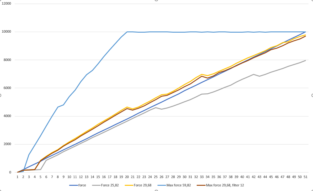

    Hello guys, i'm currently working on upgrading my direct drive wheel (finally got a 3d printer so i'm making some parts for it, probably going to publish them after testing). I changed the motor to a ZY1020 750W, got something like 5,4Nm with a 50A PSU (which is enough for now) but i've run into some problem with it. Setup is stm32 with MMOS, 3 bts7960, 2500ppr encoder.
    Playing AC with maximum force at 100% and in game gain at 75% causes the psu to turn off (tried with a 106A server psu and still does it), setting gain at 50% seems to fix this issue (and with a bit more torque it's totally acceptable).
    I also tried Wheelcheck: setting max force to 100% causes the psu to turn off after 3 or 4 "hit". Lowering the max force in MMOS under 60% fixes the issue and i can check the results. Linearity at 60% is very bad, it gets kinda good at around 30%.
    That means that i have to choose between a good linearity and enough torque so i was wondering if there's something i can do to fix it, because i don't know if this is caused by the BTS7960 or by the motor itself.
    And do you guys have any idea what i could check for the PSUs going into protecion mode?

    Use an oversized power supply, I started with a 63a server PSU and this kept tripping. 80A minimum.
    If you're using a high PPR encoder then go for the STM board, the Leonardo mostly worked with a 1000ppr encoder but would loose position running wheel check or during an in-game crash. This would cause the wheel to spin in 1 direction until power is cut.
