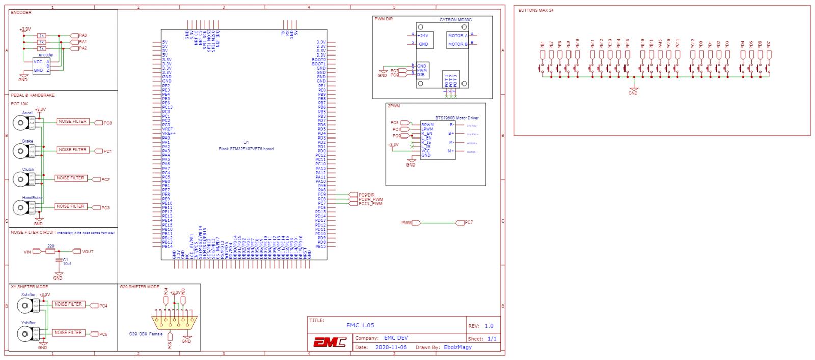

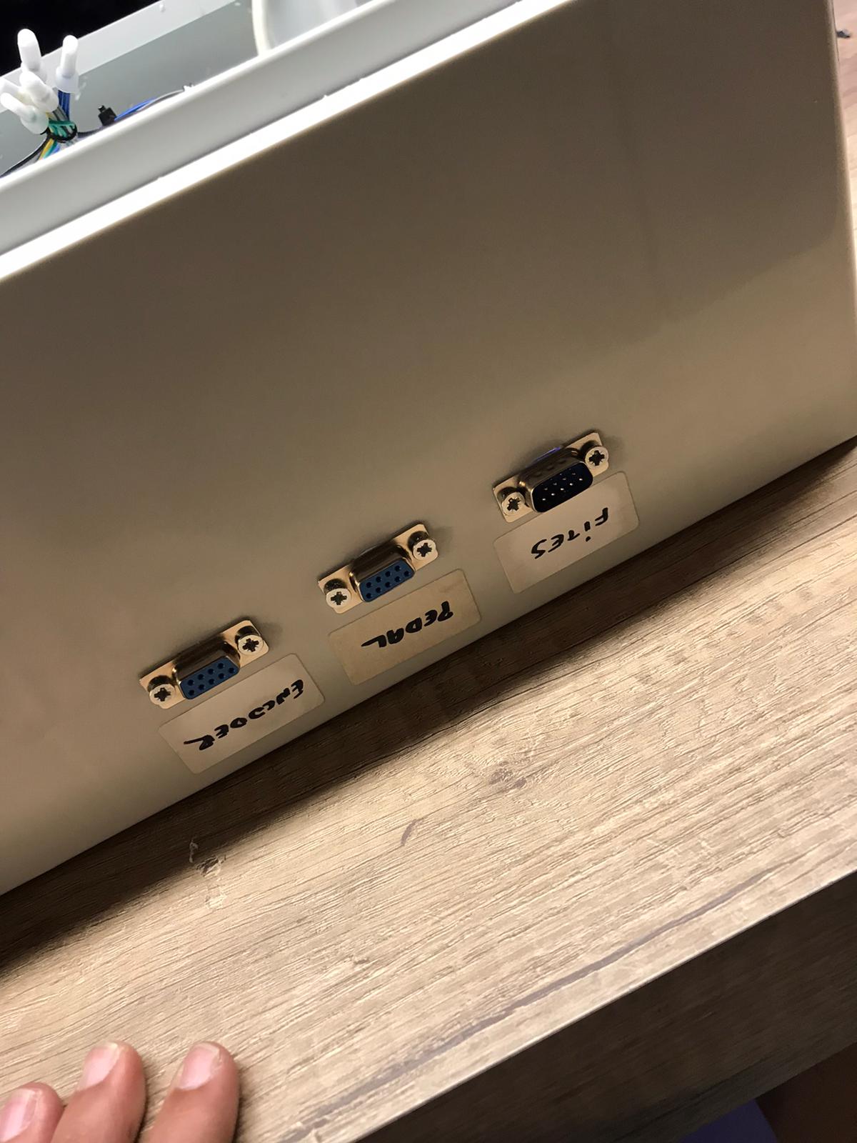

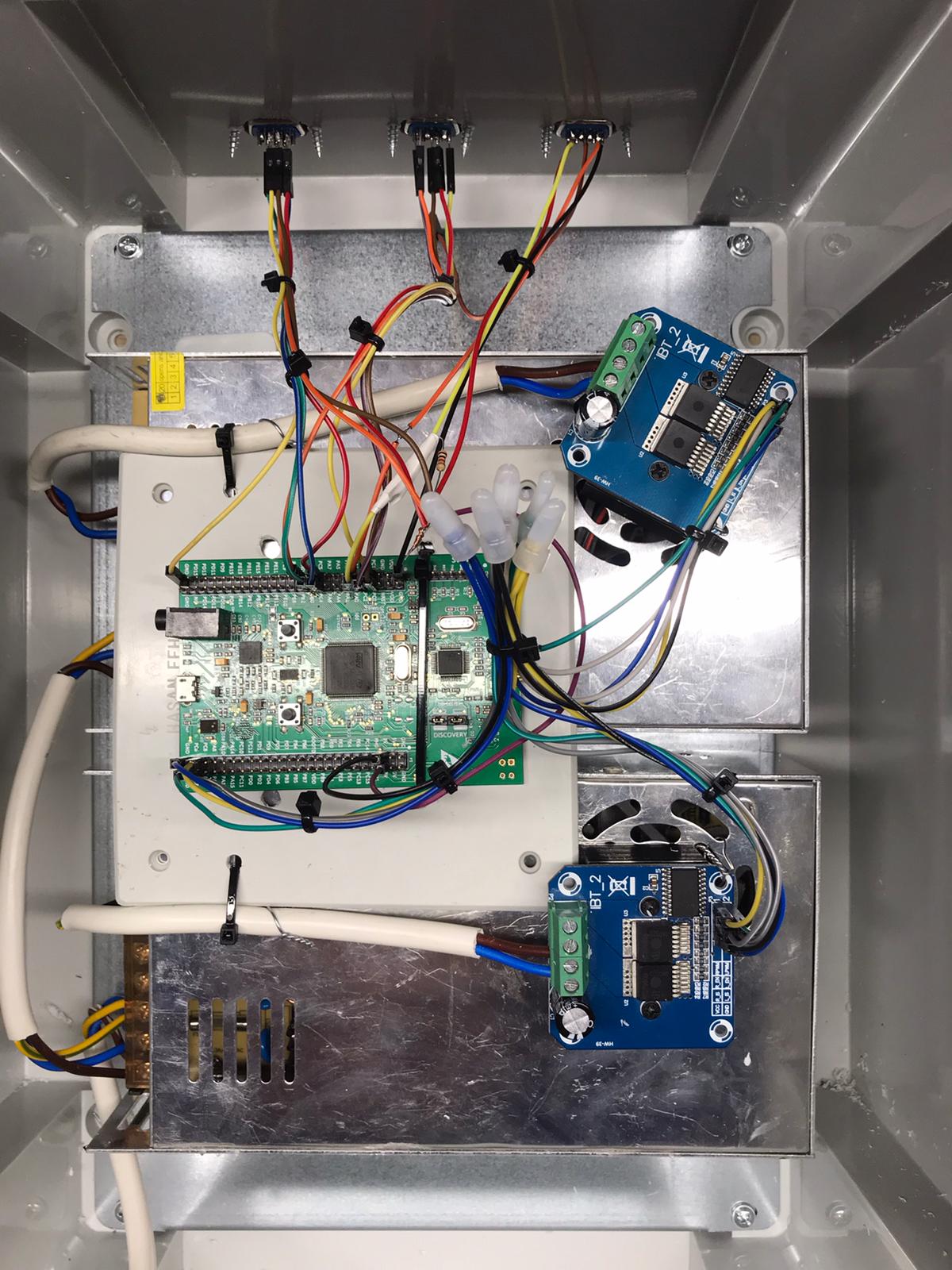

    Hi everyone. i disassemble everything and reconnect into a box. Made new EMC connections like the picture above. i've had some problems but solved now. EMC software amazing. thanks for advices
