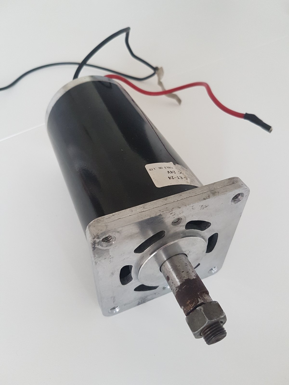

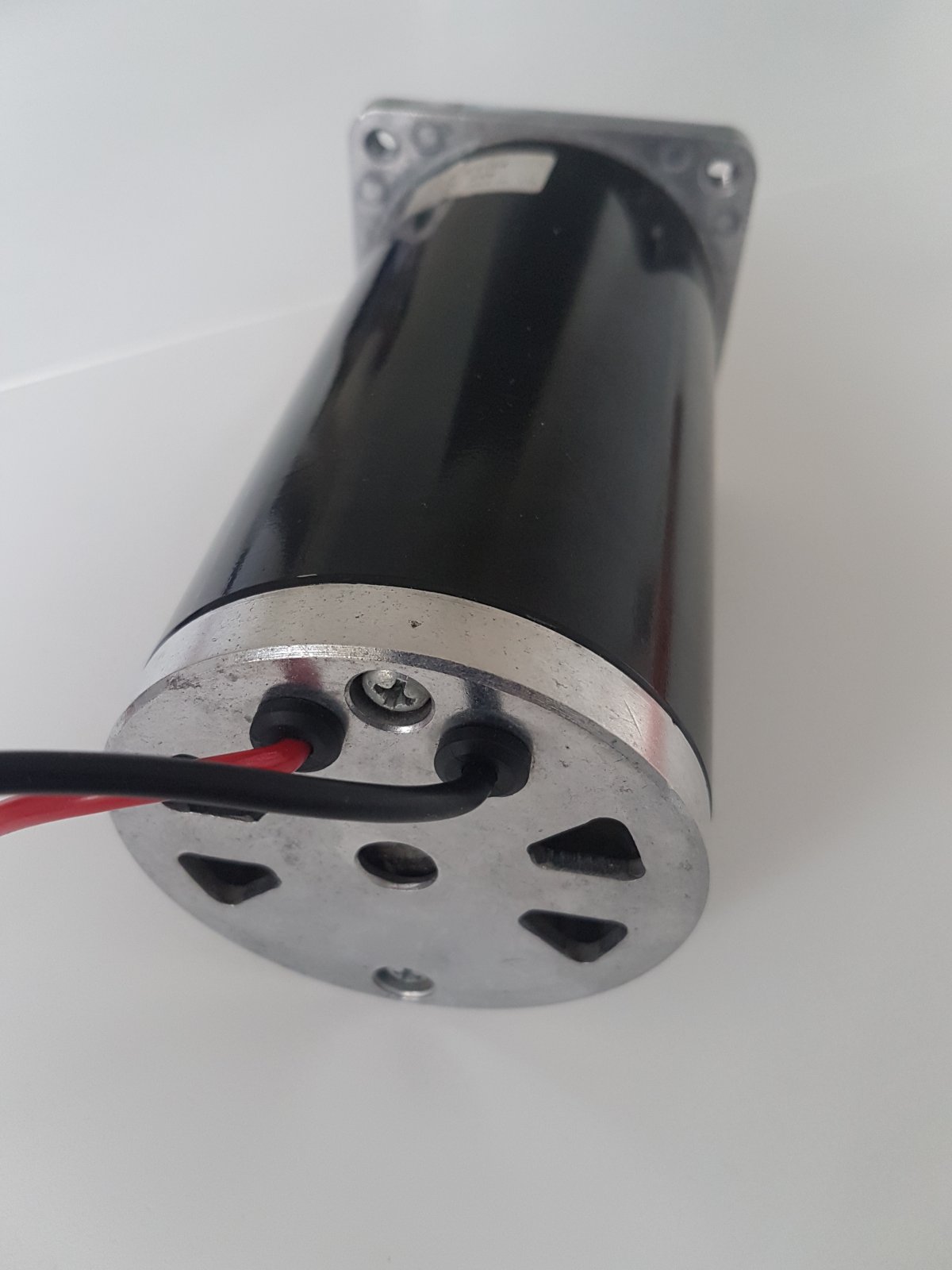

    Hello everyone. I plan to build a DD wheel base. I have a DC motor from aku cordless lawn mower. I don't know the exact motor specifications. I only know that it is 24V and 3850 rpm. Based on very similar models from the same manufacturer, I assume that the motor has about 900W. Which power supply do you recommend? I plan to buy a power supply from ebay 24V 30A 720W. I have an STM32 board and an OMRON E6B2 CWZ1X 1800 PR encoder. Are 1k ohm resistors acceptable for this encoder? Which resistors do you recommend?
