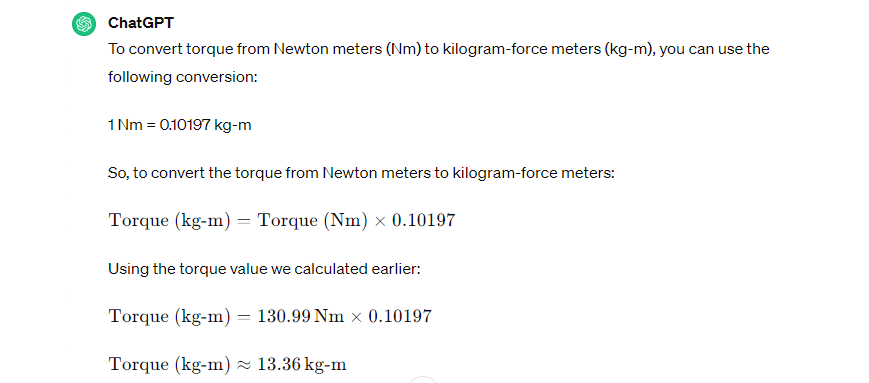

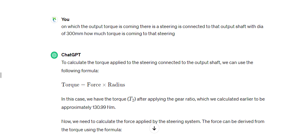

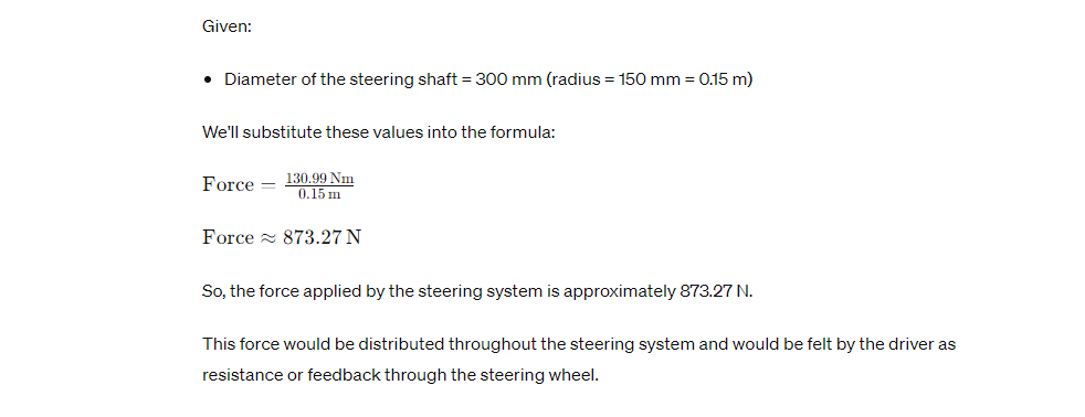

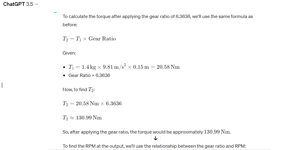

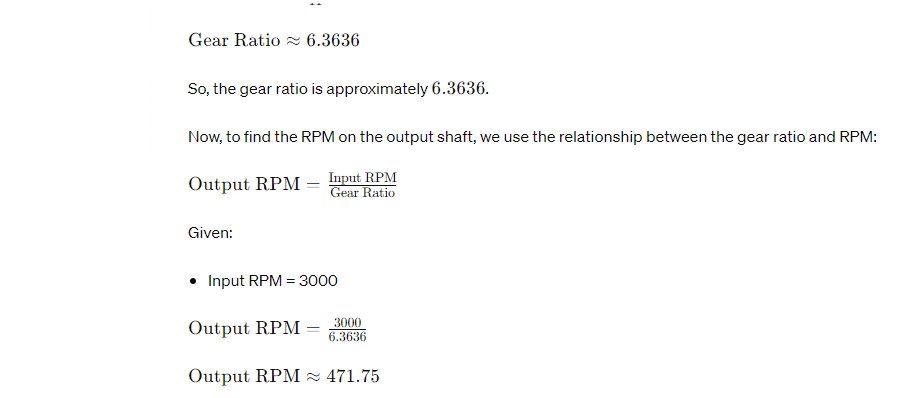

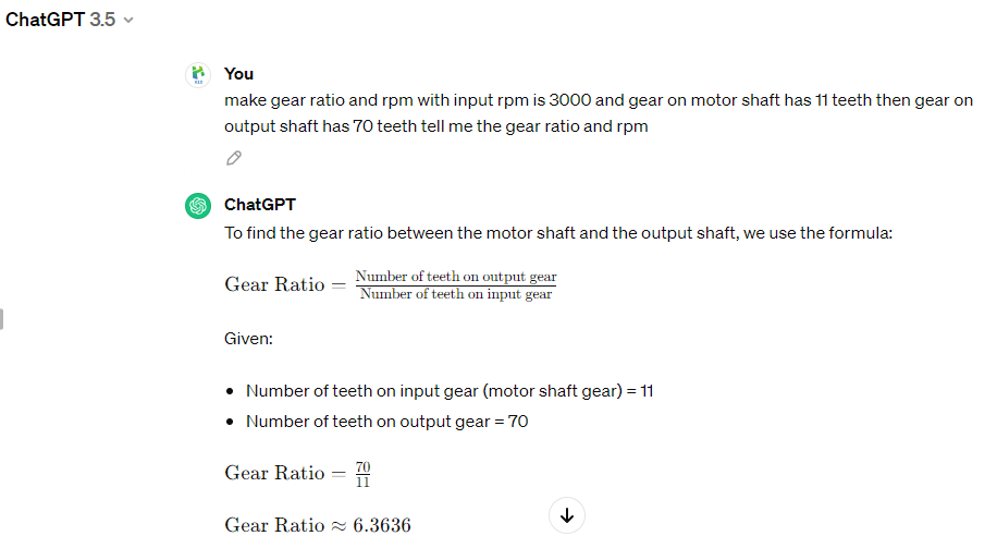

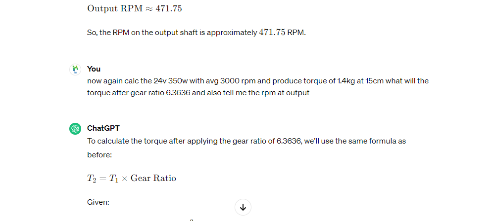

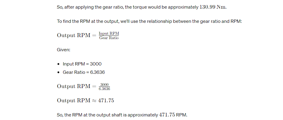

    hi, i have a motor my1016(24v 250w) is nearby and i test it and make some search through chatgpt about gear ratio and torque will you please take a look and tell me is this correct
    I tested that at 15cm this motor make torque/ force on scale around 1.4kg
    to make easier this is
    1. Gear Ratio Calculation:
      • Given: Number of teeth on input gear = 11, Number of teeth on output gear = 70
      • Calculation: Gear Ratio=70/11=6.3636
    2. Torque Calculation:
      • Given: Mass (m) = 1.4 kg, Distance (r) = 0.15 m(15cm)
      • Calculation: T1=1.4×9.81×0.15=20.58 Nm
    3. RPM Calculation:
      • Given: Input RPM = 3000, Gear Ratio = 6.3636
      • Calculation: Output RPM=3000/6.3636= 471.75 RPM
    4. Torque After Gear Ratio:
      • Given: T1= 20.58 Nm , Gear Ratio = 6.3636
      • Calculation: T2≈20.58 × 6.3636 = 130.99Nm
    5. Torque Conversion:
      • Conversion from Nm to kg-m: 1 Nm=0.10197 kg-m
      • Given: Torque after gear ratio = 130.99 Nm
      • Calculation: Torque in kg-m = 130.99×0.10197≈13.36 kg-m
    6. Torque for Steering Shaft:
      • Given: Radius of the steering shaft = 150 mm = 0.15 m(i put steering dia is 300mm)
      • Calculation: Torque (m-kg)=Torque (kg-m)×Radius (m)
      • Calculation: Torque ≈ 13.36×0.15≈2.004 m-kg
    7. i just wanted to know the torque/force on steering in kg for better understanding

    It's not really relevant because the RPM is effectively 0. ChatGPT is useful only when you give it good input.
    That motor (you wrote 250W, but used 350W with ChatGPT) has ~0.9Nm for torque at full power. Torque is going to be multiplied by the 6.3:1 ratio so 0.9 X 6.3 is about 5.5Nm MAX.
    However, you can't sustain that! remember, 0 RPM so almost no energy is being converted to rotational energy, and is almost exclusively being given off as heat.
    You can't dissipate 250W as heat only, it will melt the motor fast. At most, you want only 30% of that energy to be used, because that's roughly the amount of energy it's designed to give off as heat.
    In reality, your usable max torque is closer to 2Nm for the 250w motor and marginally more for the 350W version at 24v and that gear ratio.
    The way we get around this is running it at a lower voltage, then we can pull more amps at the same wattage. In this scenario, a crude equation is more amps = more torque but you still need to stay within about 30% of the rated wattage.
    As technical as all this is, I think you are making it way more complicated than it needs to be and confusing yourself.
