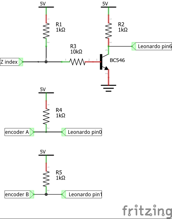

    It seems like we should change to the STM32 based solution instead. The Leonardo based solution have its weakness, and it seems that it's not gonna be some updates...
    http://www.racingfr.com/forum/index.php?showtopic=49848&st=1740
    (Use google translate...)
    I already have some Leonardo card, so I will test with that first. But if the rest of the equipment (driver, dc-motor) works good, I will order a STM32 card.
    I tried to register on the forum, but they didn't allow any new members. Although, I don't think he will give away the source code anyway...

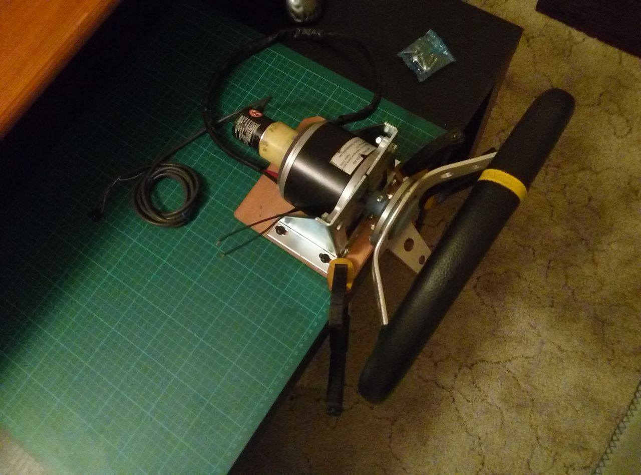

    Finally here are some pictures of where I currently am at the build. :)

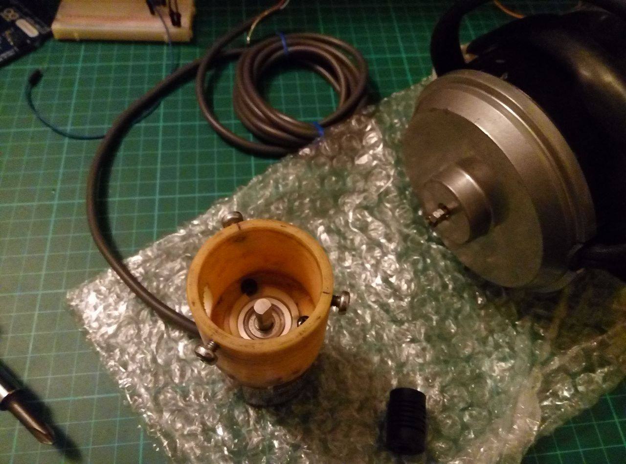

    I finally managed to build the wheel to be able to test it. It was quite a challenge as I had to figure out all the mistakes I made during the wiring and configuration. :) The power supply I was using is 12V 83A.
    The cogging worried me when I turned the motor by the shaft, but after I put a 350mm wheel on it, the effect diminished so much I could hardly feel it. When I let go of the wheel it settles into one of the "valleys of the magnetic force" but it's not much of an issue because in game there are larger forces. This cogging effect was kind of the same powered and unpowered.
    There is a certain minimum force the motor needs to get moving, whivh I figured out the hard way. Worrying about high current and torque, first I started with 25% main gain and 50% on all the effect sliders. The steering stop was set at 20% which felt quite strong, but not srtonger than what a G27 is capable of.
    When I started LFS, I did not feel any force at all, the wheel felt like it was unplugged from the power, but the steering stop from the wheelconfig software was there, with the expected force.
    After an hour of juggling with all the possible explanations, I found out I had to raise the main gain to 50% and all the effects to 100% to give large enough ingame PWM input to the wheel to even move the motor at all.

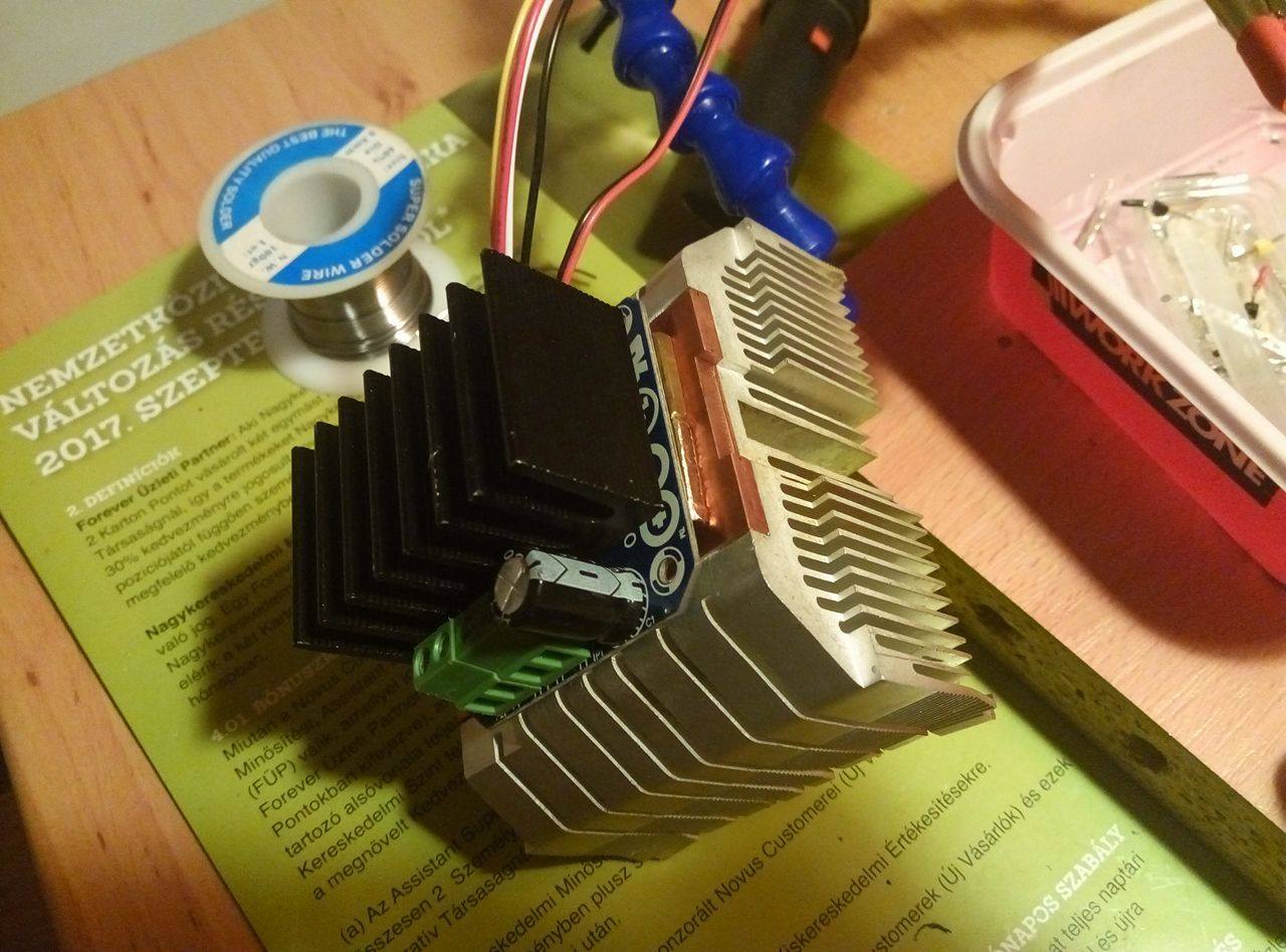

    This time I faced another challenge, that being overheating. Earlier I read a forum post about the IBT-2 controller not having the most efficient cooling, I followed a recommendation to unsolder and move all the terminals and the condensator to the other side of the PCB and add a CPU heatsink on top of the mosfets black case. I left the original heatsink on the bottom where it originally was and made a sandwich from the IBT-2 and the two heatsinks. The result was not what I was expecting. The smaller heatsink was too hot to touch and the big one on the mosfets' top was cold. When enough force applied in game, in a turn for example, it took no more than a couple of seconds for the IBT-2 to shut down in overheat protection. Unplugging and replugging the power helped it restarting but it heated up so quickly again. This time the force feeling in the wheel was still probably half of what I'm used to in the G27. The precision and the speed was there, but lack of force.
    The current reading on the power supply was a maximum of 15A for 1 second when it shut down. Then I added a 80mm fan to cool the controller, this time I could drive around normally for a minute, not more before it overheated again. Then it could keep up with 15A but failed at 20A. Not much improvement. The maximum main gain in wheelconfig I could achieve was 68% and the force was still weaker than the G27.
    I had to revert the components on the PCB to their original location and place the bigger heatsink to the underside in place of the original heatsink, and move the smaller heatsink to the top. This configuration is not tested yet, but even with the lower currents the motor also got worryingly hot. I could still touch it and keep my hand on it, but it was on the margin. I wouldn't want to heat it up more, the magnets could lose their power if heated up too much. Either way, it's the maximum this motor is capable of as a direct drive.
    The next is to add a 5:1 ratio with a HTD-5M 15mm belt and see the torque that way. With the cooling upgraded it could be stable.

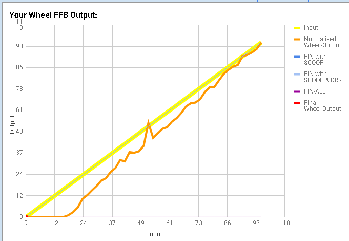

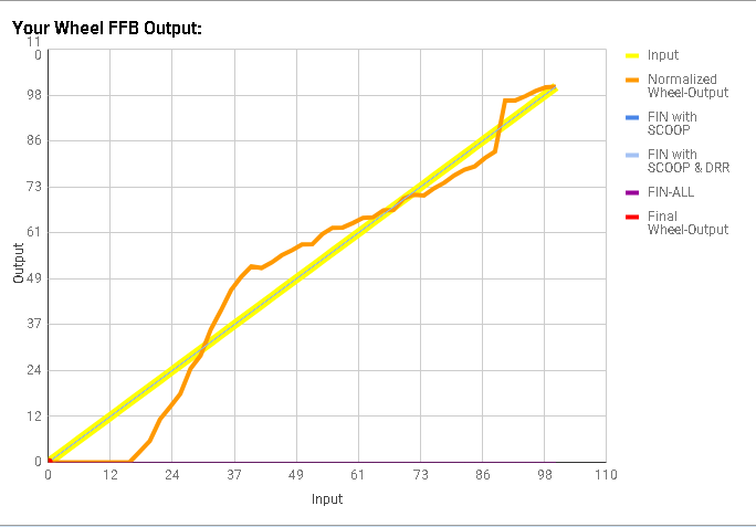

    First, thank you for your honestly and describing report.
    Would be great for us all if you could do a wheelcheck test before you go to the 5:1 solution. What interest me most is the deadzone, that you describe as minimum force i think. (It's about 18% with G27, which is the G27 second biggest weakness with that wheel i think, the rattle sound is the biggest...)
    Remember to set at least 500° rotation in the wheelconfig.
    http://forum.projectcarsgame.com/sh...eel-FFB-Values-Google-Sheet-amp-FCM-Universal
    I'm still not convinced to continue with this project. Everything i have ordered except the motor could be reused if i go with the stepper motor solution from Craig. As soon as i get the rotary encoder, i will connect it temporarily with a belt just to see how it works before I put to much time fitting everything together.

    Yes, my motor is rated for 24V @22A max. That means it could take twice as much on 12V. However, I'm afraid of giving it high current just by hearing is squeal like a stuck pig. :D

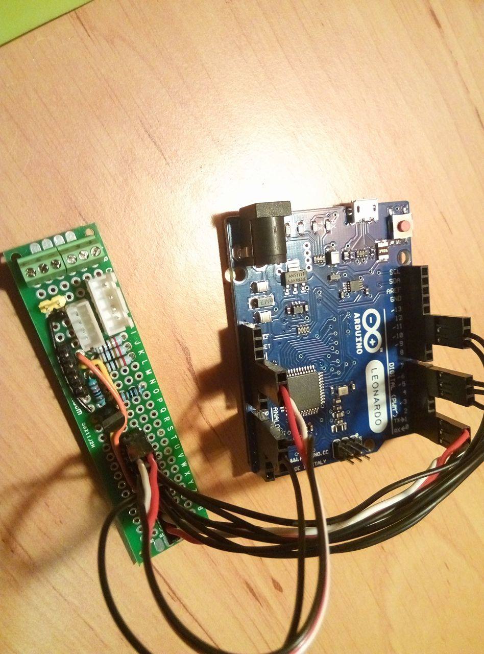

    Today I made a tidy little board for electronics. The breadboard version was a bit chaotic. Also the new cooling needs to be tested on the IBT-2. I did half a lap of Nordschleife in Assetto, 70% main gain. Average amps in a corner were 10-15A, I have seen a 24A peak once on a curb. After 5 minutes of cruising, the IBT-2 was room temperature, the wheel motor itself was not even warm. It must accumulate over time. I don't know if because of the wiring or the heatsink, but it seems more efficient so far. I might go higher in gain and see what happens. The cogging can be felt slightly under load, in corners. Just like a worn steering rack in a really old car. :D
    I ran wheelcheck at 70% gain, here is the .csv if you're interested.

    Deadzone similar to G27, but it actually looks good i think. It is supposed to do 4 tests, and than the google sheet makes "normalized" (Average?) output, but I just put the same values i all four.
    My G27:
