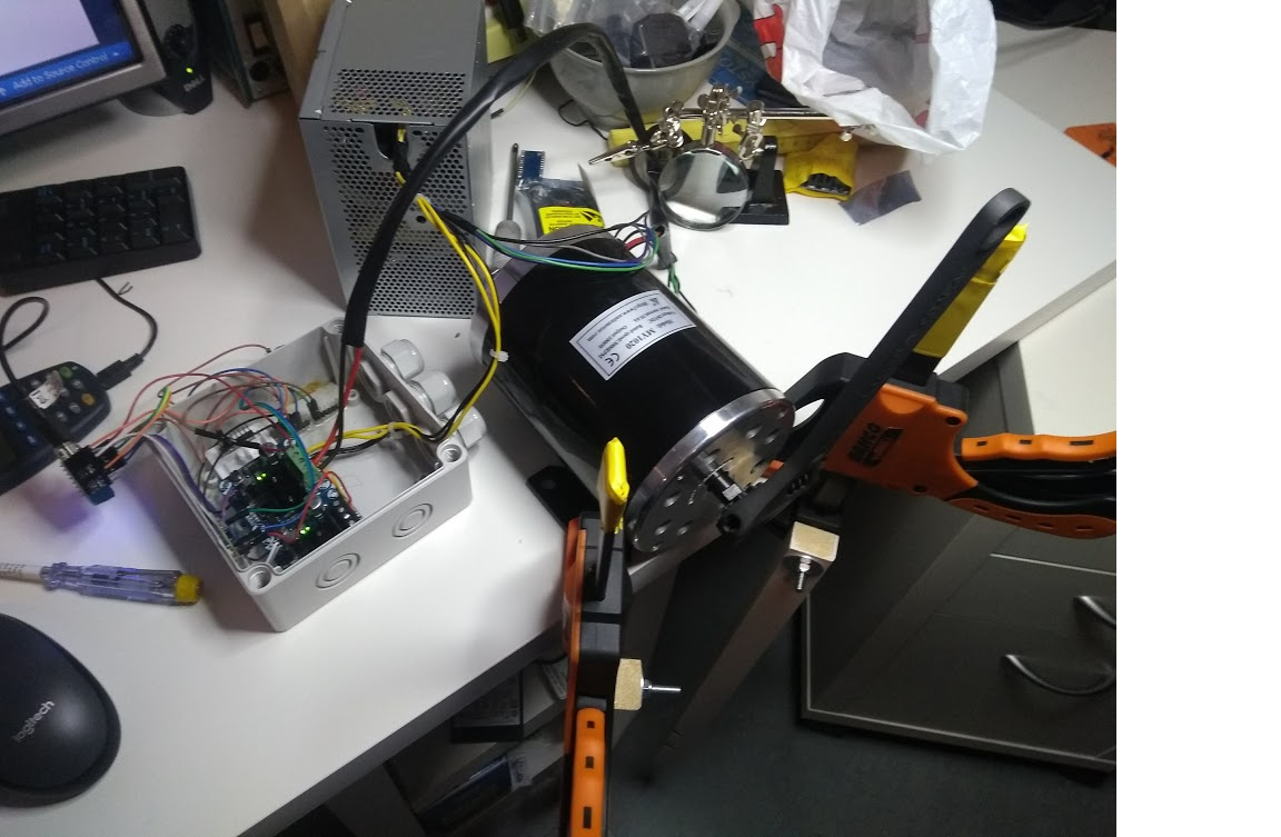

    Well, still only received the motor, but when I was working with a another project with IBT-4 cards, I took the opportunity to try out the strength of the motor and how the the IBT-4 handle the current. Had no power supply with high current, so I took one from an old computer that i don't use any more. According to the label on it, it should deliver 18A on the 12VDC output, but it went over 20A at 40% pwm.
    With 50% pmw output, it already felt much more stronger that the G27. I used a wrench and it was not easy to hold still... But the IBT-4 got hot almost immediately, so there is no chance it will last with the standard cooling. >60% pwm, the supply cutted off. My multi-meter cannot measure current over 20A, so I have no idea of what current it reached.
    Another notice is that it needed 4% pwm to overcome it's own inertia and start to rotate. With the wrench fitted, it needed 5% to start rotate, although with a "cogging" rotation. With a wheel mounted on the axle, the "deadzone" shouldn't be more that 6-7% i think.
    Edit: Changed to 20 khz pwm, and it actually surprised that it even got stronger, and it start rotating at 1% with the wrench.
    Conclusion so far is that for strength, the current supply may be enough, but still worries about how the cogging will impact when no or low force are applied from the car sim.

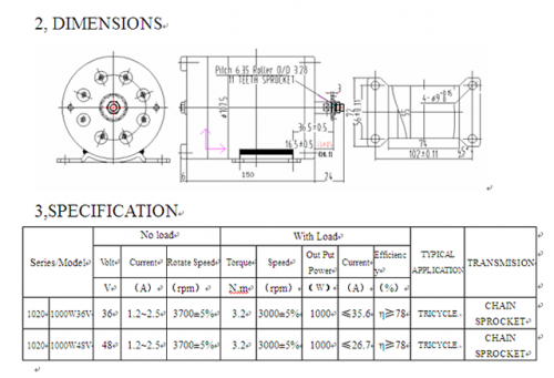

    It's the 1000W36V version. I have study dc-motors a lot before and even after I ordered this, and Independent of speed, the torque is proportional to the current. So this motor will give 3.2 Nm at 35.6A no matter what the speed is. So the better choice had been to buy a motor with even higher voltage (=more turns of winding) to get the same torque but with lower current, because we don't need the high rpms.
    If you look at the 48V version, you have the same torque but with lower current. More turns of winding means that the motor generates more back EMF and therefore needs higher voltage to get higher rpms. But for our use, it's a better choice, because we don't need 3700 rpm.
    Have you tried to connect two H-bridge in parallel? It should work in theory I think, but if there are some difference in tolerance (capacitance etc) between the cards maybe there will be some sync error.
    The cogging is due to the spacing of the windings. (There are only 4 magnets in this motor)

    There are also a 60v version where you get 3.2 Nm with "only" 21.5A
    Or what about 2.74 Nm with only 7A! I'm sure 24VDC is enough to reach rated torque and the speed for our needs.

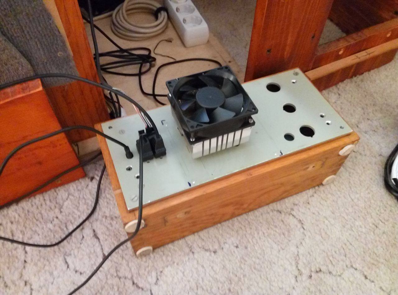

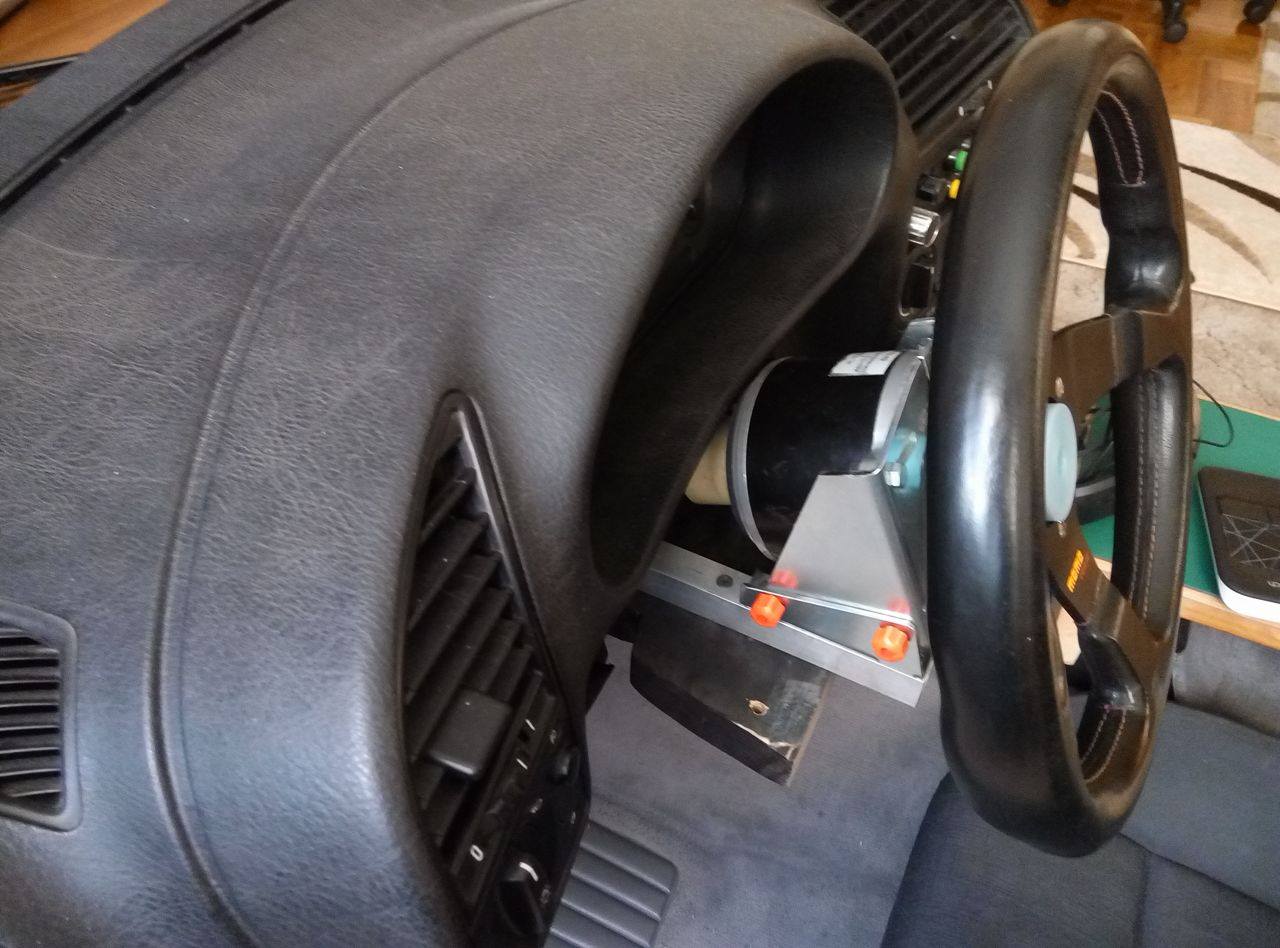

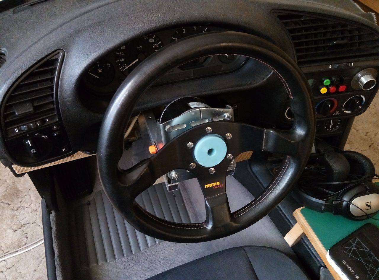

    Meanwhile I built the wheel into my rig and had a proper test run. Drifting is awesome with this rotational speed, but it still feels weak overall, not more than 1-1.5 Nm of torque by feel.
    Also found out the squealing noise is coming from the server power supply I'm using. There might be a chance my protection shutdowns at higher cuurent is produced by the PSU rather than the H-bridge.
    I will try it with a car battery sometime.
    I failed to set up the pedals and the G27 shifter with the STM32 board, the output was too jittery and I was unable to calibrate it at all. Tried some tricks from random forums but no luck.
    Therefore I used an arduino Leonardo and uploaded a firmware for standalone G27 pedals and shifter. That works great.
    Here are some pics of the PSU and controller box and the wheel installed. :)
